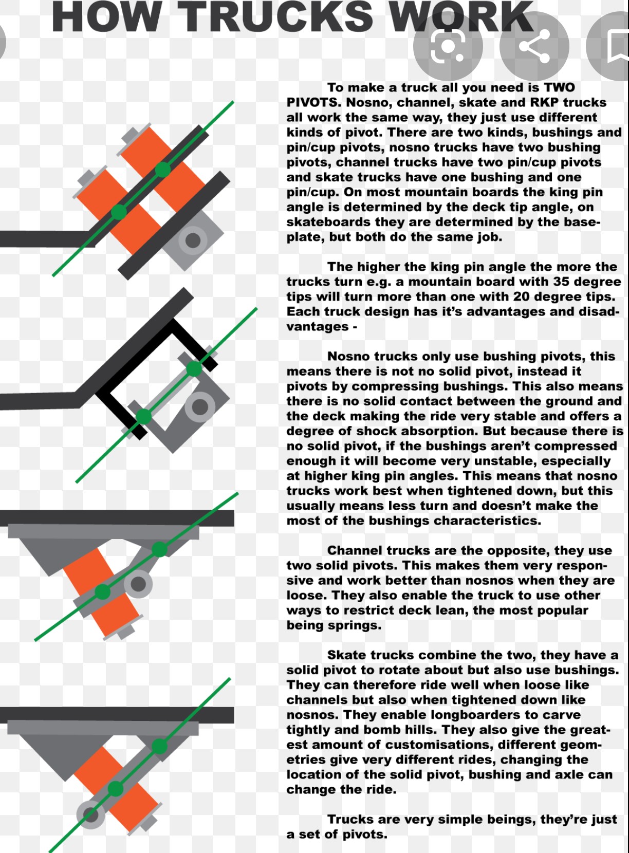

In your testing, have you noticed any acceleration of bushing wear because of the lack of a fixed pivot? I could imagine that bouncing around in all 3 axis could start to tear up the bushings eventually.
This was my first thought. If PKP trucks have a full 6 degrees of freedom (x/y/x, yaw/pitch/roll), resisted exclusively by the bushings & seats (until the kingpin hits the ID of the hanger hole), vs TKP/RKP’s yaw/pitch/roll from the hanger pivot nose, there’s gotta be increased wear on the bushings.
Maybe doubling the number of bushings is enough. And/or the bushing seats are deep enough to support that movement. I’m curious what sort of prototype testing was done to get here.
That decoupled ‘suspension’ has got to feel great for soaking up uneven terrain. Whereas TKP/RKP bushings are primarily to control turn angle and rebound behavior, PKP bushings are a solitary link in the load path between ground and rider.

I’m assuming one couldn’t easily adapt these to a traditional longboard shape, right?
I mean, I figure it would just take a 50 degree baseplate, but that would be a whole new thing that @ApexBoards would have to design, prototype, test, order, and stock.

Nosno did song MTB stuff with these way back.
This might also interest you:
https://rogerswannell.com/blog/how-to-make-a-nompa/
https://rogerswannell.com/blog/some-thoughts-on-suspension-trucks/
