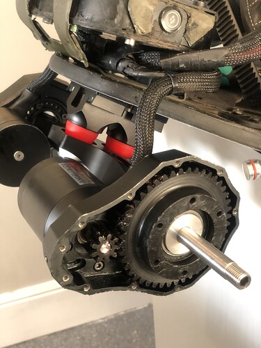

You guys just shipped me a pretty healthy order of bushings. Looking forward to trying combinations… Green in Houston. I’ll post my feedback here.
First ride should be tonight! Locktite dried last night.
The hub gear was not pushed in all the way at the time of picture. Everything aligned great, spins freely. Motor is using fixed points as
I also installed the 9T.
Red pen is back
First ride was short and in the dark, but the ride feels transformed for the best. Tested riding over a curb, and it absorbed much more than I expected. Can’t wait to put in some real miles.
