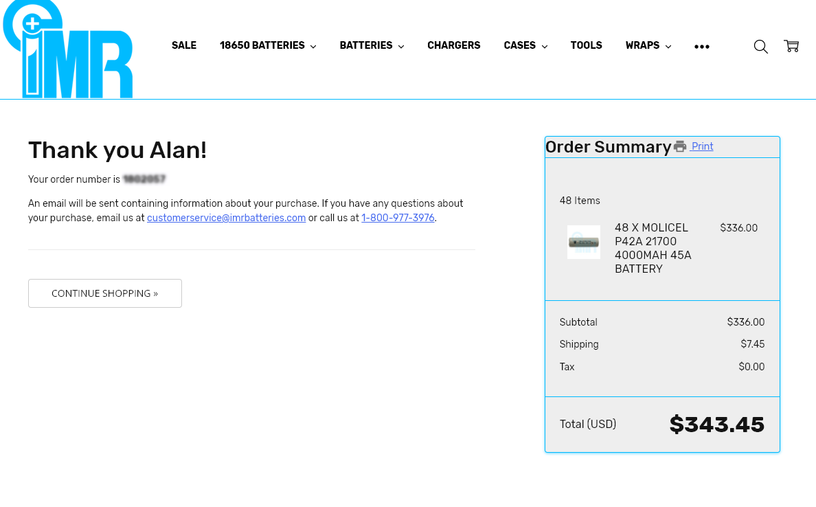

I think the moli-cells outperform and out cost… but I need that shit…
thinking about a 12s2p… is molicel the answer?
I made a psycho ocd table
Man, Even with the groupbuy the 40T pack I’m getting would be close to the same as the Molicell I was thinking of getting. Still can’t wait
for this 40t pack though!
let me know what ya think…
I wanna press the P42a’s into service and make them work…
I could do 40T but then the next year I’d wonder…
at least now I’ll know
Gimme 4 weeks and it should be rolling…
I think the near future/next year people are gonna go p42
Even though it’s only a .2ah and 5amp discharge difference from my findings
(Although it’s rated for 45a discharge it’s is really only 25 continuous, 30 under 100°c and above that it gets sketchy)
