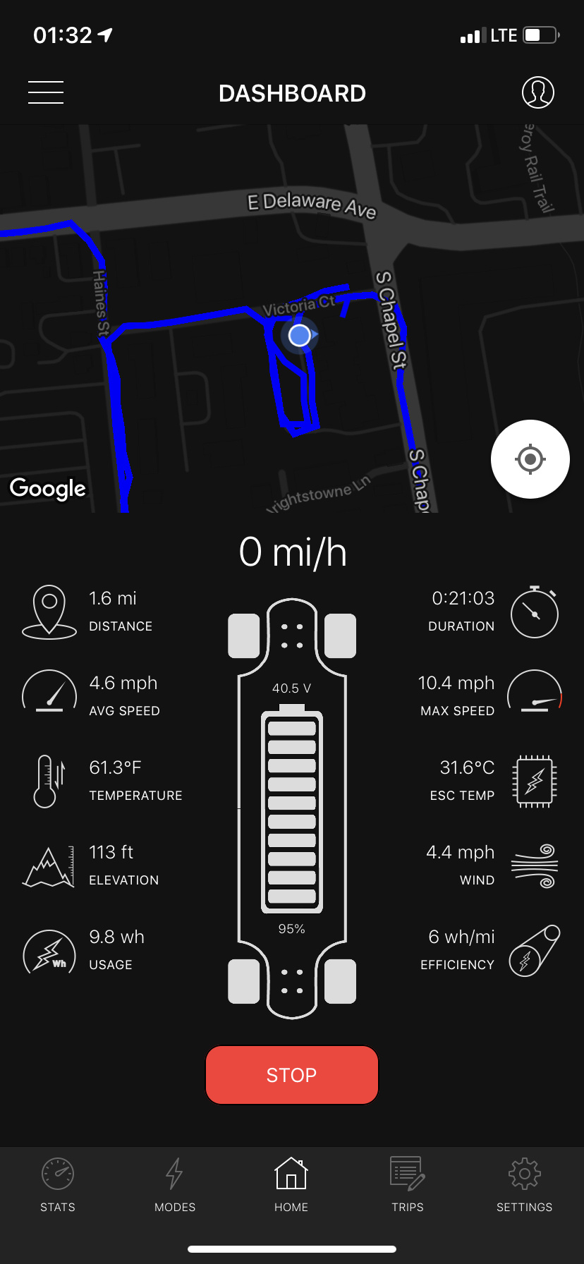

Took a 1.6mi test run, this thing is fucking amazing! I’m looking at 24 miles of range and it’s literally 10 pounds! It’s a bit uncomfortable under the feet at speed because bricks, but it’s seriously not bad! The power is also more than I can stand with a single 5065 because it’s so small, but even then it’s got more kick than my dual hub board
sick dude. How they hell are you getting 24mi out of a 10s1p??
Each 40T cell is 14.4 Wh, this pulls 6 Wh/mi… Therefore 10 cells is 24 miles worry of charge
do a full charge range test and let us know :slight_smile:
