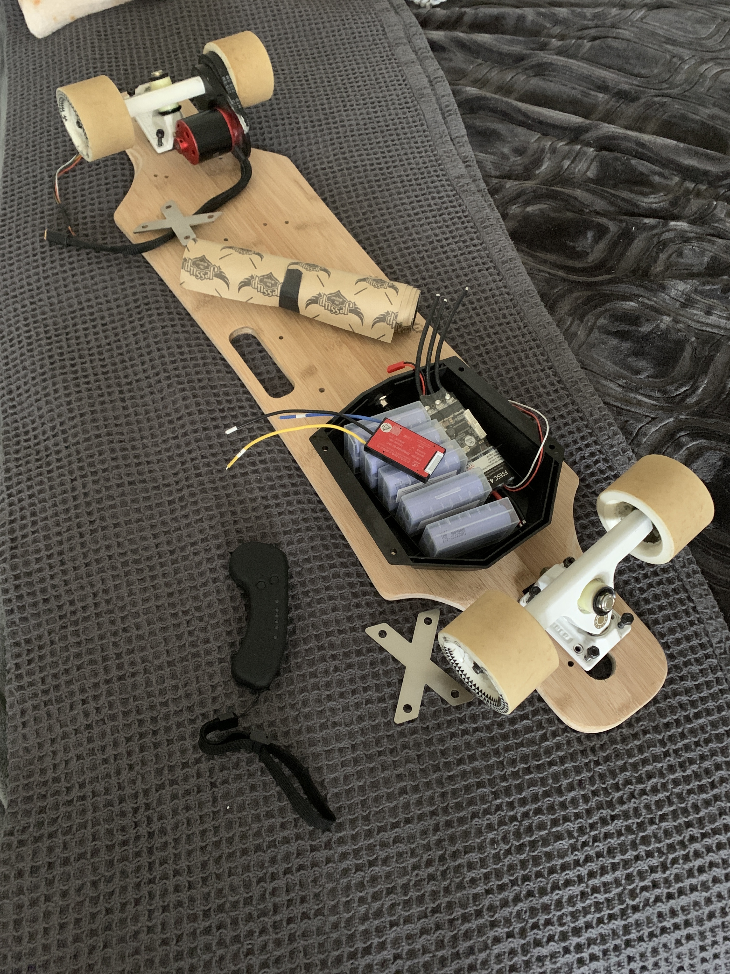

I will eventually have a printed enclosure but I need to generate the CAD for it first, it’s gotta act as both a compression pack for a 10s1p 21700 pack and a shell for the ESC, receiver, Bluetooth module, BMS, fuses, and ports…lotta work to do on it still

It’s been a while since I touched this board, it’s getting some more progress done rn. All parts are in now so I just gotta put the little bits together now, the deck is Swiss cheese at the moment so I’ve gotta patch and refinish it, it’s so much nicer now that it’s gross and covered in foam and tape
Suggestions for waterproofing? I’m thinking I’ll put a plate in the enclosure so it’s not sealed against the deck, using MT60/GX12 for the ports, and I’ll epoxy the loop key and charge port too so it doesn’t leak
Just pay attention that the MT60 (and most connectors) have a small hole inside each of the female sockets to let air out when you plug it, you need to seal that or water will make its way inside, but you can’t just pour resin or it will get on the contact surface

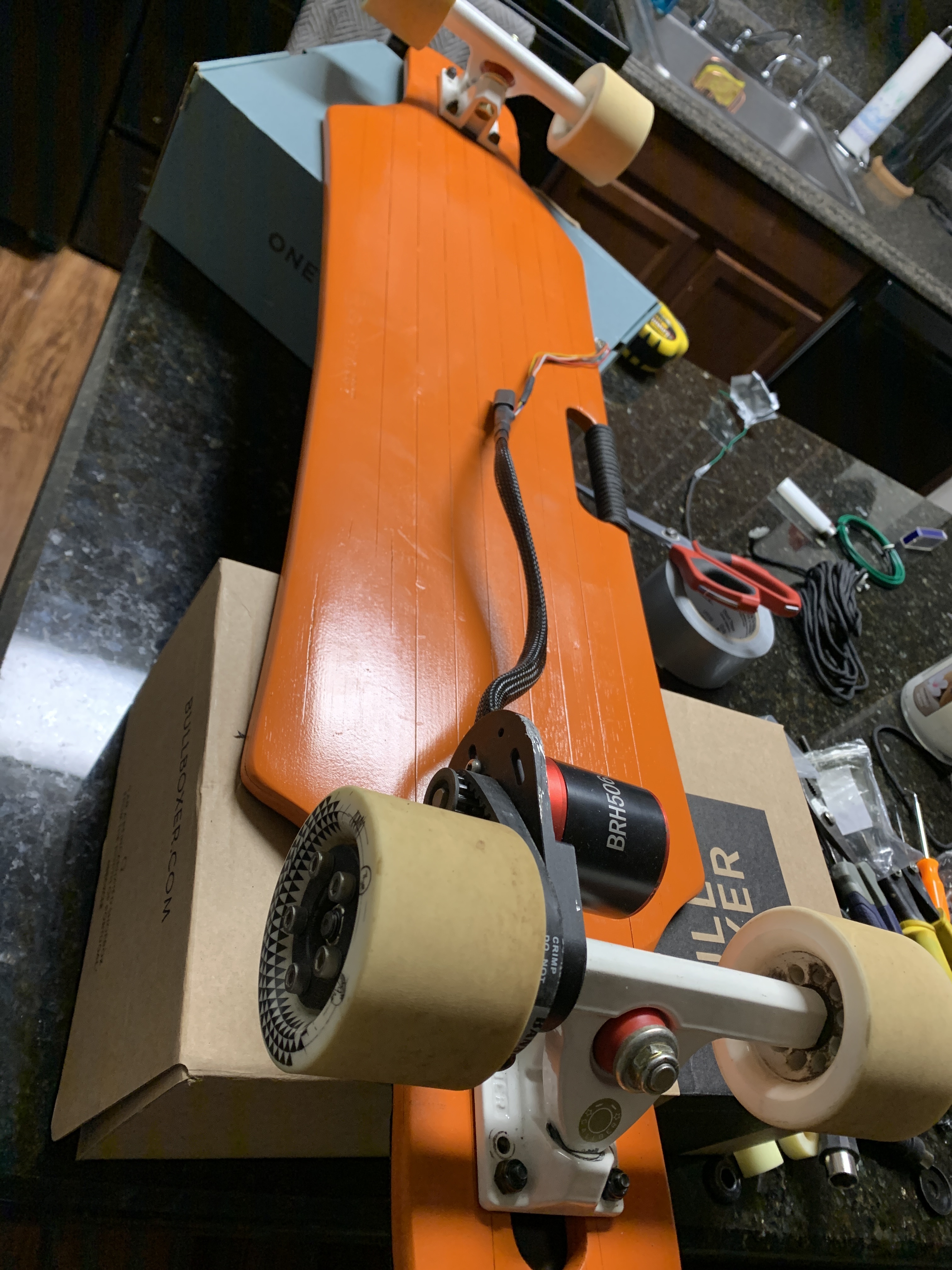

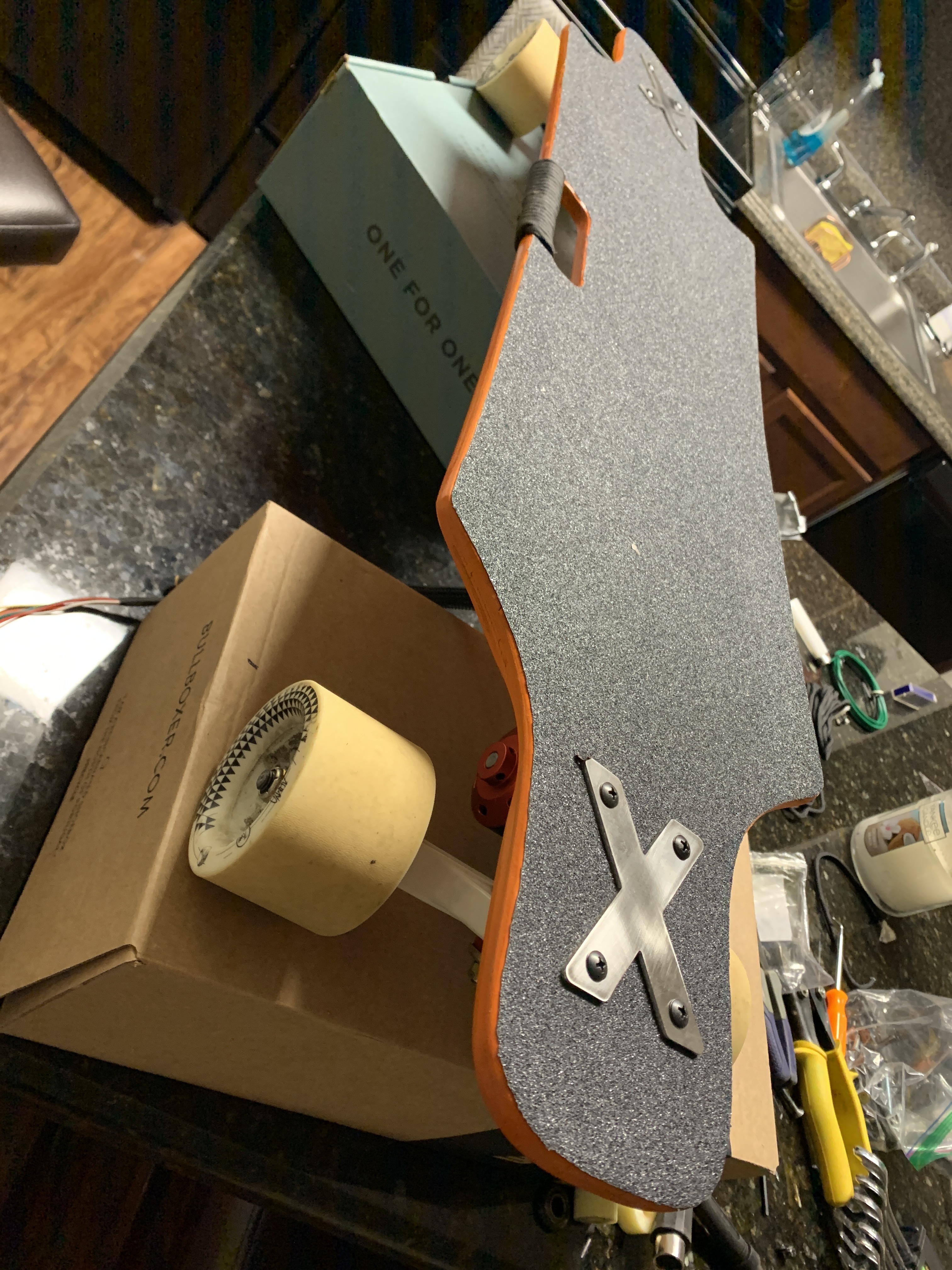

Re-painted, re-gripped, and re-assembled (just the rolling chassis)… pumpkin spice longboard!!
I love the para-cord wrap on the handle…it’s soooo much more comfortable
