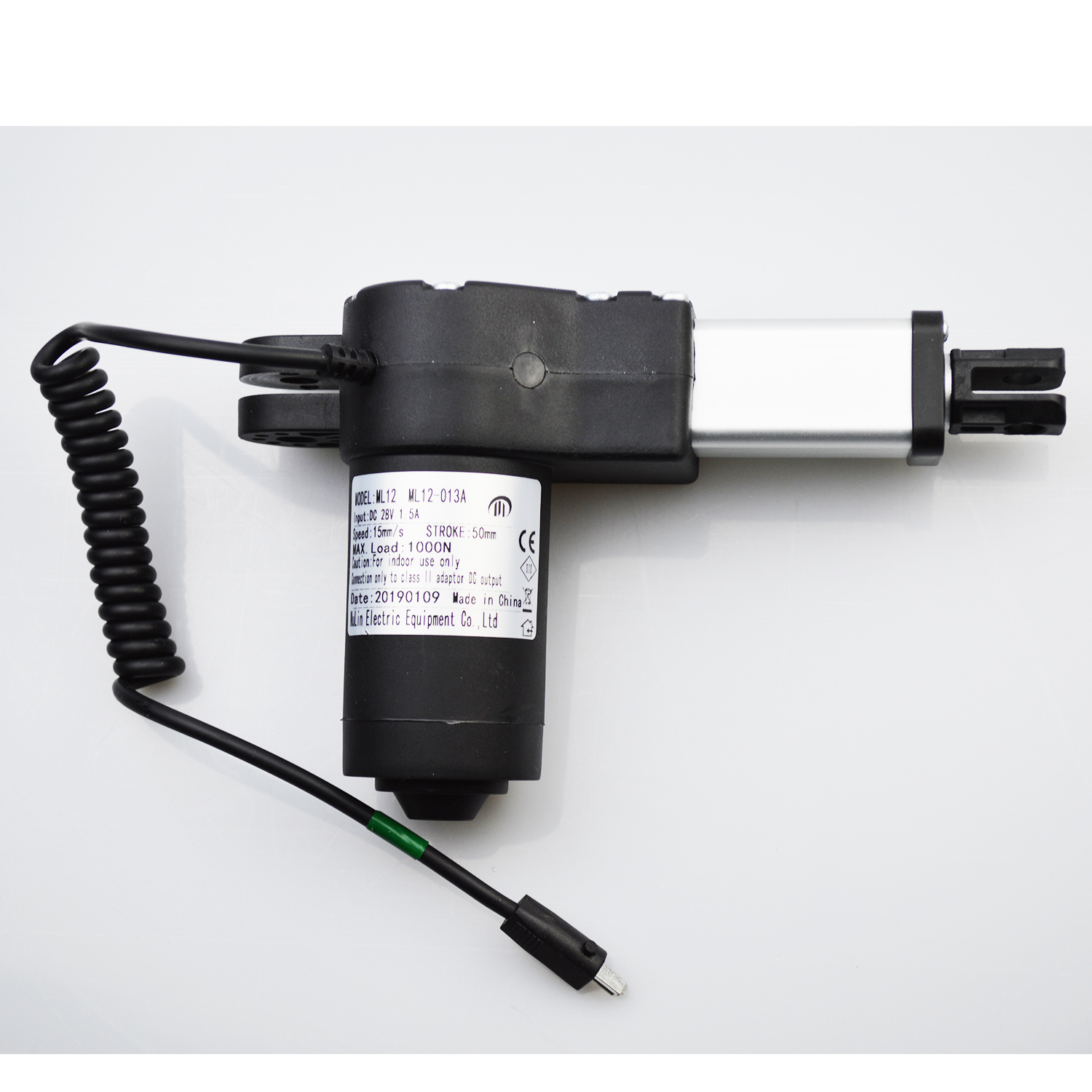

Heres the actual actuator I would likely use
the collapsed length is roughly the sidance from the center to start of shoulder for a standard TB 218 calibers.
and the fully extended length is 200mm .

High quality 12/24V dc sex machine linear actuator electric linear actuator
Maybe one of these right angle actuators would work better, wheel see
