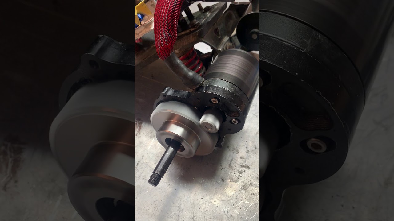

So I started to make a Mod for the etoxx gear drive mini, the old gears from the one and only @NoWind were POM and Helical. New ones I created where a mix of c45 and chromosteel straight- the whole thing just had to stay intact, summer was just around the corner.
It took a while for me to get into CAD, calculating stuff and creating stuff for “production” but
it took forever to find a good partner who would make the gears for a first prototype for an affordable price, so I came to Stefan, here 45 minutes of the finest craft on youtube. (https://www.youtube.com/watch?v=ZBhGo3PwRc4&t=1819s) I was in his workshop just amazed by all those tools and his knowledge. This is what we came up with, more or less a copy of Jens Gears in Steel changed to straigt gear:
Not cheap, not light in weight, but the Gears 1.0 were ready.
The gears are about 500g each, 40/9 ratio, Module 2. The 9 teeth layout for the small gear was not optimal, more on this in Stefan’s video. However, I didn’t want to make the module smaller at this point so that, as I said, everything lasts first. The weight really doesent feel that much, its fine in my opinion. But getting those even more lighter would be good, of course (yeah, already in the works)

After realizing how incredibly stable these gears are, I dared to go to module 1.5, the best decision I could have made. The production was no longer over Stefan (I think he is always looking for different stuff and even much more smaller stuff, but crazy dude) so I was looking for a new partner for a long time, with the background to milling more gears later if necessary. After a long search I found what I need! Version 2.0 was milled.
Gears 2.0 arrived, like version 1.0 still 500g. 12/54. At this point I had already ideas to make the gear even more lighter and want to change some stuff. But this will it be for Version 3.0 in the future.
The first run on the bench was so extremely smooth even without grease and not 1 mile driven in. I could hardly believe it. Here is another video:
(Compare it with version 1.0 Video, just crazy how smooth)
I went on a first test ride, and what can I say. Its just pure awesomeness. Gears are the perfect mix between not to loud and having starship sound. The freeroll, start from low speed feel so freaking crazy, its like having Sensors 2.0 so crazy smooth. No wobbling and so on. Video is dark but listen to the sound:
We now know, these things hold up all the burdens, foolproof, even if there’s a screw in the gear, they last forever, the sound is next level. Weight is ok (already improving)
Unfortunately, the main disadvantage is the price, only the gears (2x large gear + 2x small gear for motor cost me around 400-450)
What I can tell - you guys have to experience that! The extremely smooth feeling, the cool fighter jet like noise thats still not to loud + knowing that the gears won’t break when going completly crazy → worth gold!
