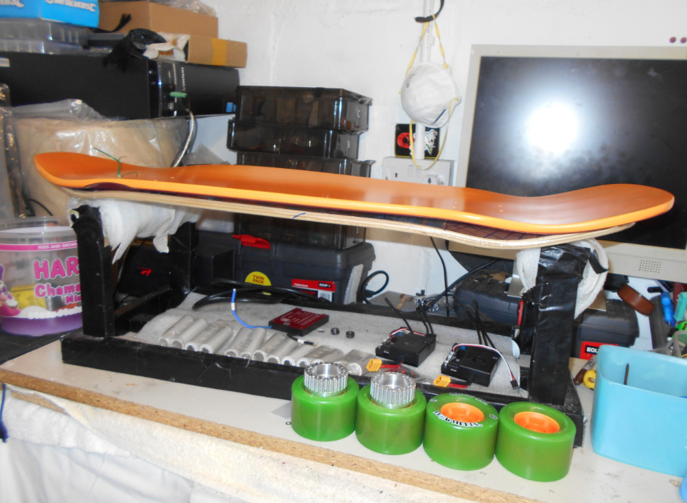

was laying out some parts for another build and this sort of took shape…
I want something with true skate-park capabilities… that is leaving the ground, wall rides and maybe even right rail slides if I get the enclosure right :smile:

I want something that I can forget is there and can take skate-park grade abuse , can’t think of anything better than a skateboard I always wanted to try this but couldn’t find a cheap enough deck but recently found this Blank 80s similar style deck…

So you are going to use standoffs to attach the 2 decks?
That makes me worry about torsional flex…good luck!
Wil trucks mount to top or bottom deck?

Yes but the bottom deck is getting cut before battery and after for so it just and enc

yes, these parts are getting trimmed off (I might save the tail for a tail saver to mitigate the 76mm size)
I plan on using nutserts and skate hardware at the circled points, nutserts would be overkill if the bottom part was not going to take a load - I only have some cheap alu standoff to try this with but plan on getting ones I trust
