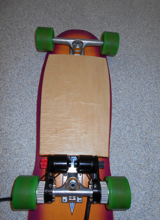

some changes to the initial plan - biggest is the swap from dual FocBox to MakerXDual.
  • Battery - down to 12s

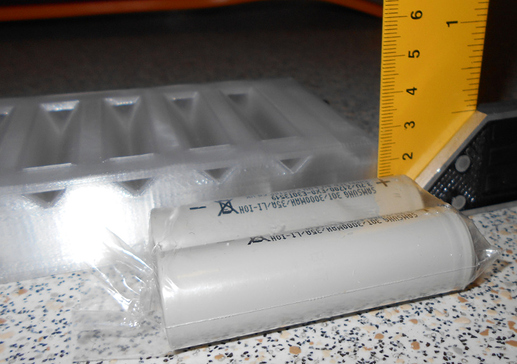

After playing about with some N.E.S.E modules I really liked the idea of using them in this build for extra physical protection. Sadly they just take a little too much space -
length is almost workable
but this put me off, I would have to cut too much into the enc.to make it flat enough (~10mm is a deal breaker lol)
  • Trucks

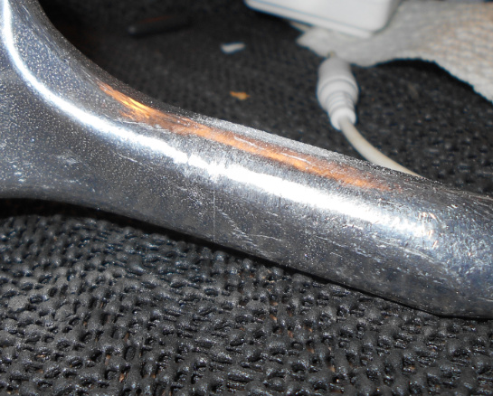

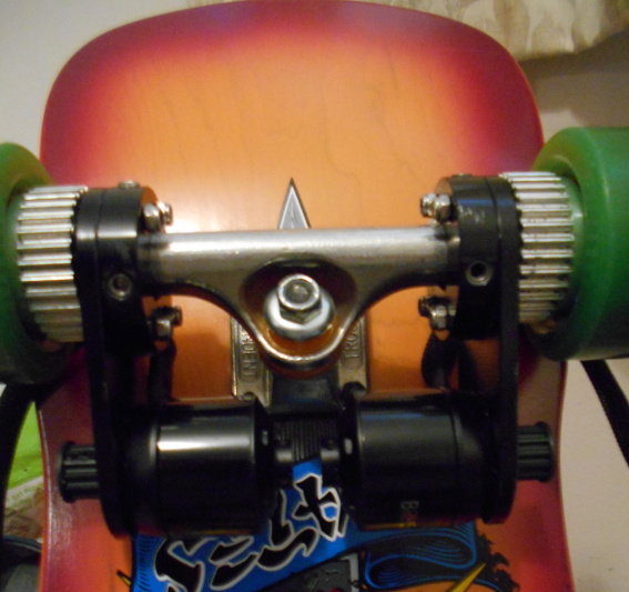

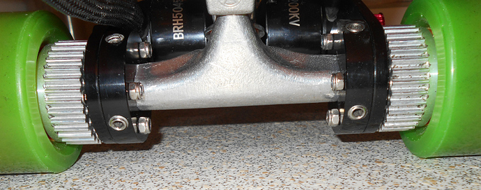

I’m so surprised these were so simply to modify, turns out these actually fit Caliber II profile - at a really weird angle but they are pretty well held in place with the grub screws. (nice side effect of installing upside down is they can’t drop down if the clamp screws fail)
before
after taking filing off a couple mm
more than happy with the clearance, I plan on filling any space around the clamp with JB Weld
I never expected to end up with something more trustworthy than Paris mounts after about 10 minutes of effort :slight_smile:

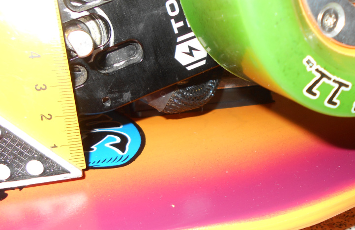

I have tried so many different mounts nothing was coming close to giving the clearance I needed until I managed to pickup some used 50mm torqueboards ty @PixelatedPolyeurthan
adding about 7mm of risers I have reasonable mount clearance - and most importantly I get wheel bite before mount bite :heart_eyes:
  • Motors
    I was planning something 55 but there is simply not space - I had some used Racestar 5545 I was planning on using elsewhere, they fit so well

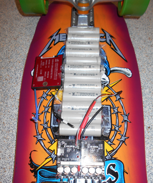

  • VESC - MakerX Dual
the makerX dual fits so perfectly I almost don’t mind losing the 13s with the FOCBOXes
this is my new planned layout
  • Enclosure
I’ve cut the enc. I have to admit I felt so bad destroying a deck before it had ever been used as a board - if I do this again the deck gets trucks and a quick ride round the block before getting chopped lol
still have to trim it but its almost fitting…
now to make it fit nicely with some cutouts and supports
and don’t worry @b264 I’ll be testing the enc by slamming it against a wall when its finally mounted :wink:

So are you just going to glue the nese modules? I actually don’t think the cells will be a problem getting hit with the cut deck and nese modules. Maybe add a bit of foam though in between. And the esc is going to be protected, how? or are you only riding in non-wet conditions and good roads?
NESE means cutting out too much from the enc. deck going to cut away space for cells and VESC into the enc. deck. with as much foam and stuff I Can
It won’t be ridden in the wet - this one is a little bit of an indulgence - an indoor skatepark build LOL
(still sounds nuts typing that)
lol
But that is still a great idea. Why did you not go hub though if you want to sneek it in parks?
Hubs are all just that little but too big , and the small china ones just don’t have the thane needed
