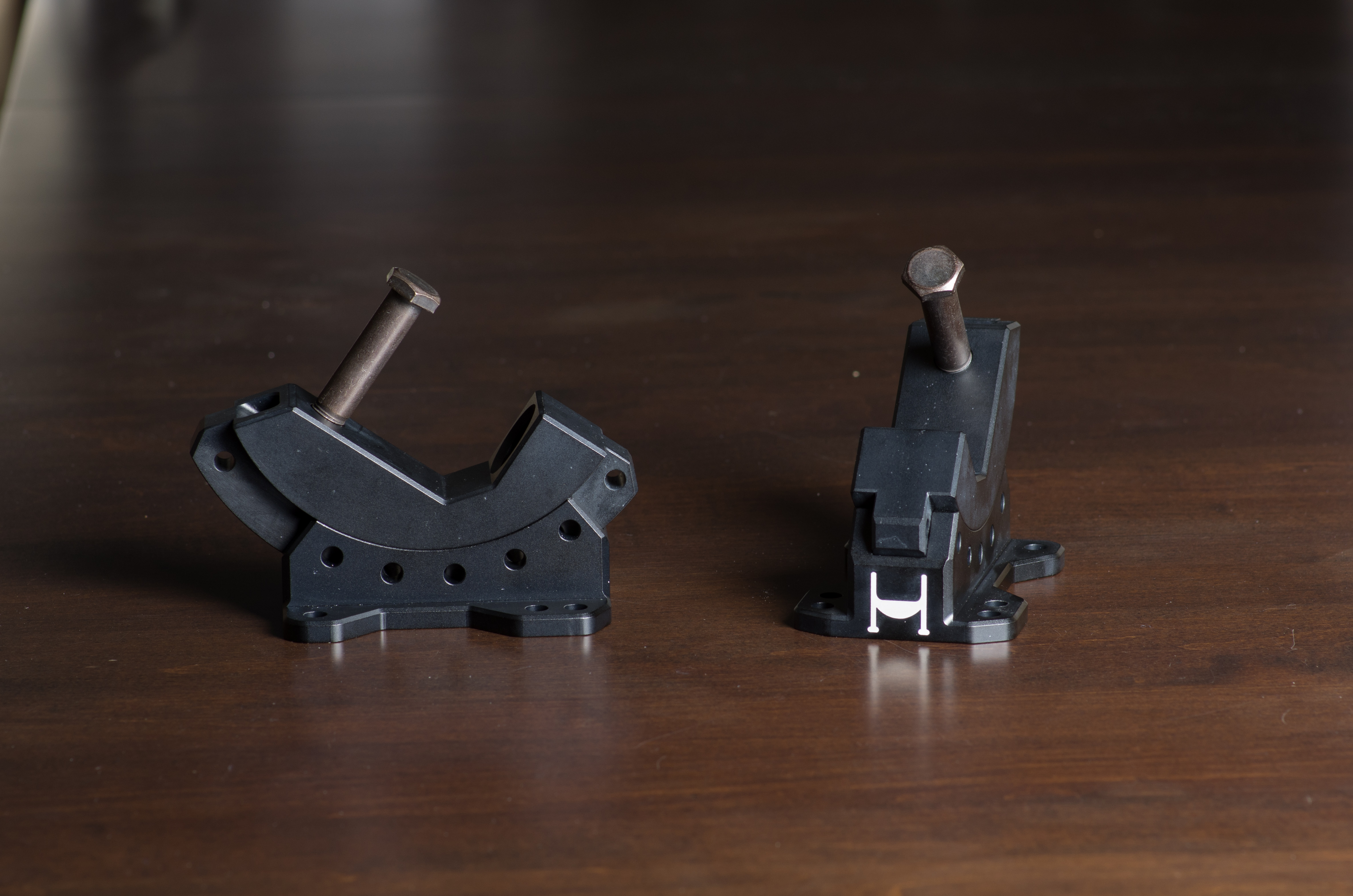

I tested with like 10 different kingpings and 20 different bushings and pivot cups to find the balance and make it works with most of them. That’s why the several tries I went through
Only problem I have now I can not pair back the tested kingpings, bushings and pivot cups with the original trucks! Well I always mix anyway.

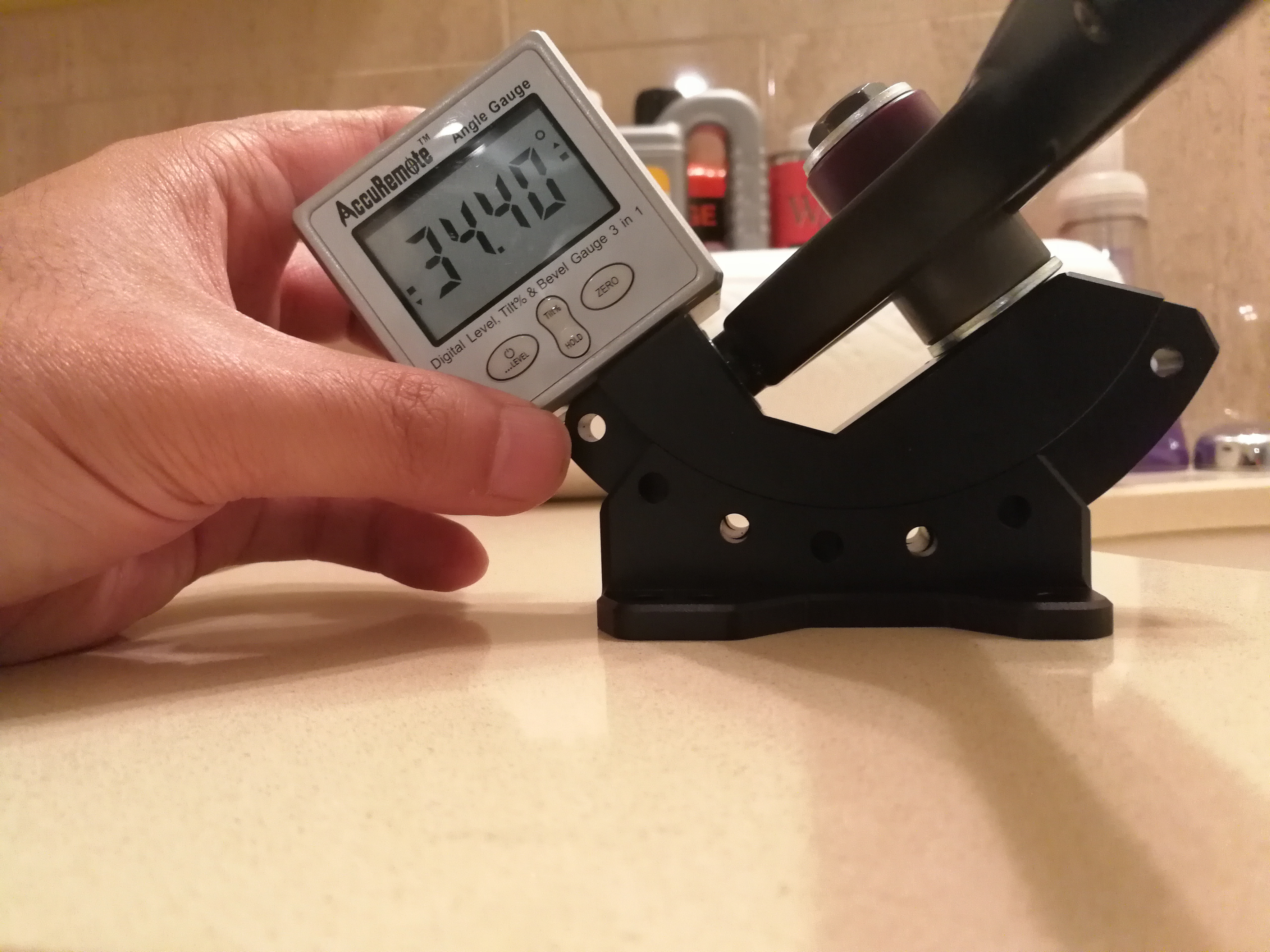

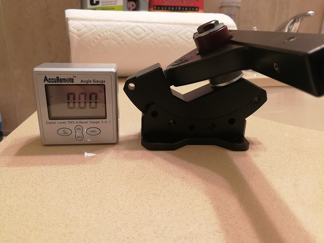

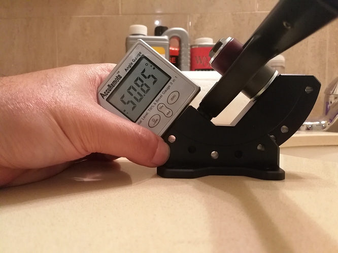

@rey8801 I think I got it but can you confirm this is a valid way to measure/set truck angle?
BTW I can’t believe how meticulous you were with the slot the kingpin nut slides into. P-E-R-F-E-C-T fit. :heart_eyes:

I can confirm: good way to measure truck angles.
Perfect way. I also have the same angle meter and I was still using a manual ruler :triangular_ruler: :man_facepalming:
Anyhow when the front edges are flushing is 50 degree, then every steps is about 5 degree adjustments so you can also count :+1:
Don’t tell me about the nut because I measured so many of them and was always wrong once made the parts. That part was quite tricky indeed. I was happy when the magic numbers came together

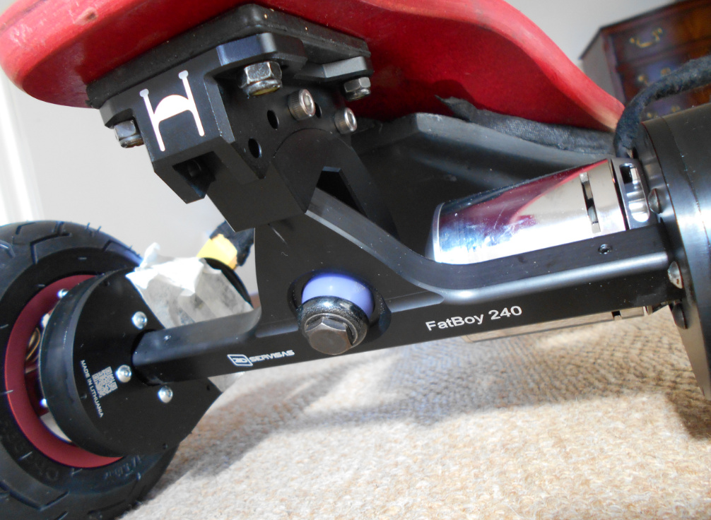

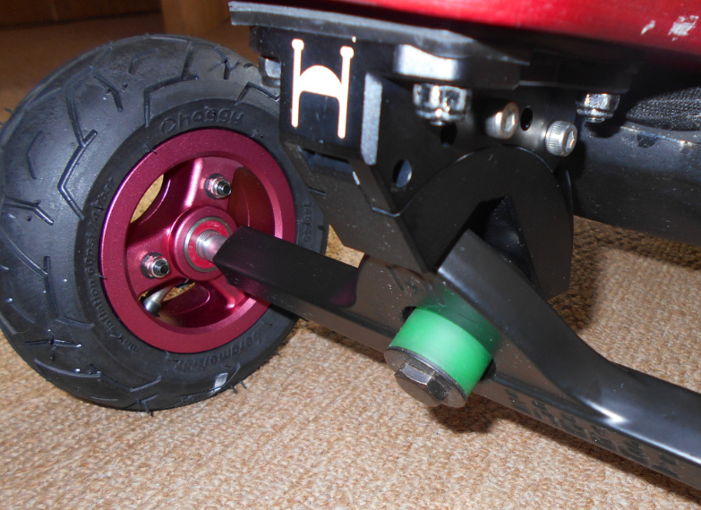

with @3DServisas fatboy
these and the nano drives make my evo usable with only 5mm of risers! :heart_eyes:
I couldn’t do this before ~7mm clearance at max lean

Edit: was only 5mm risers
Man that was the whole idea
Minimized stupid tall raisers and run assymetrical deck easier than ever. I am really happy it works out for you too!

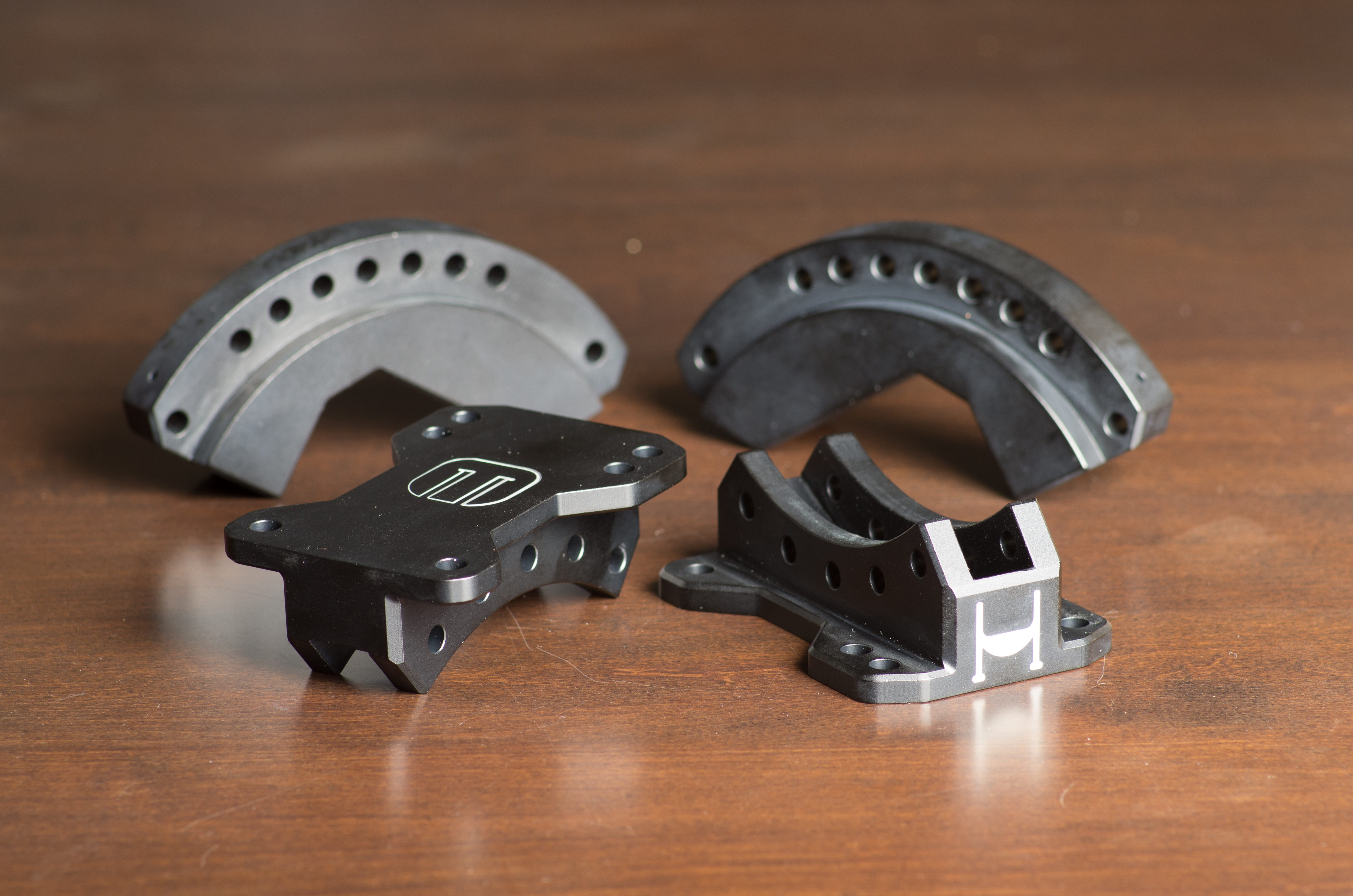

You can go through this and the other forum threads to see all the story and pictures, but here a brief summary.
Some pictures are from the guys from the 1st GB, You can recognised them since they are better than mine :sweat_smile: Thx for them guys!
1 set includes 2 base plates + kingpins, nuts and bolts (fine for a board), it can be Raw or Matt Black.

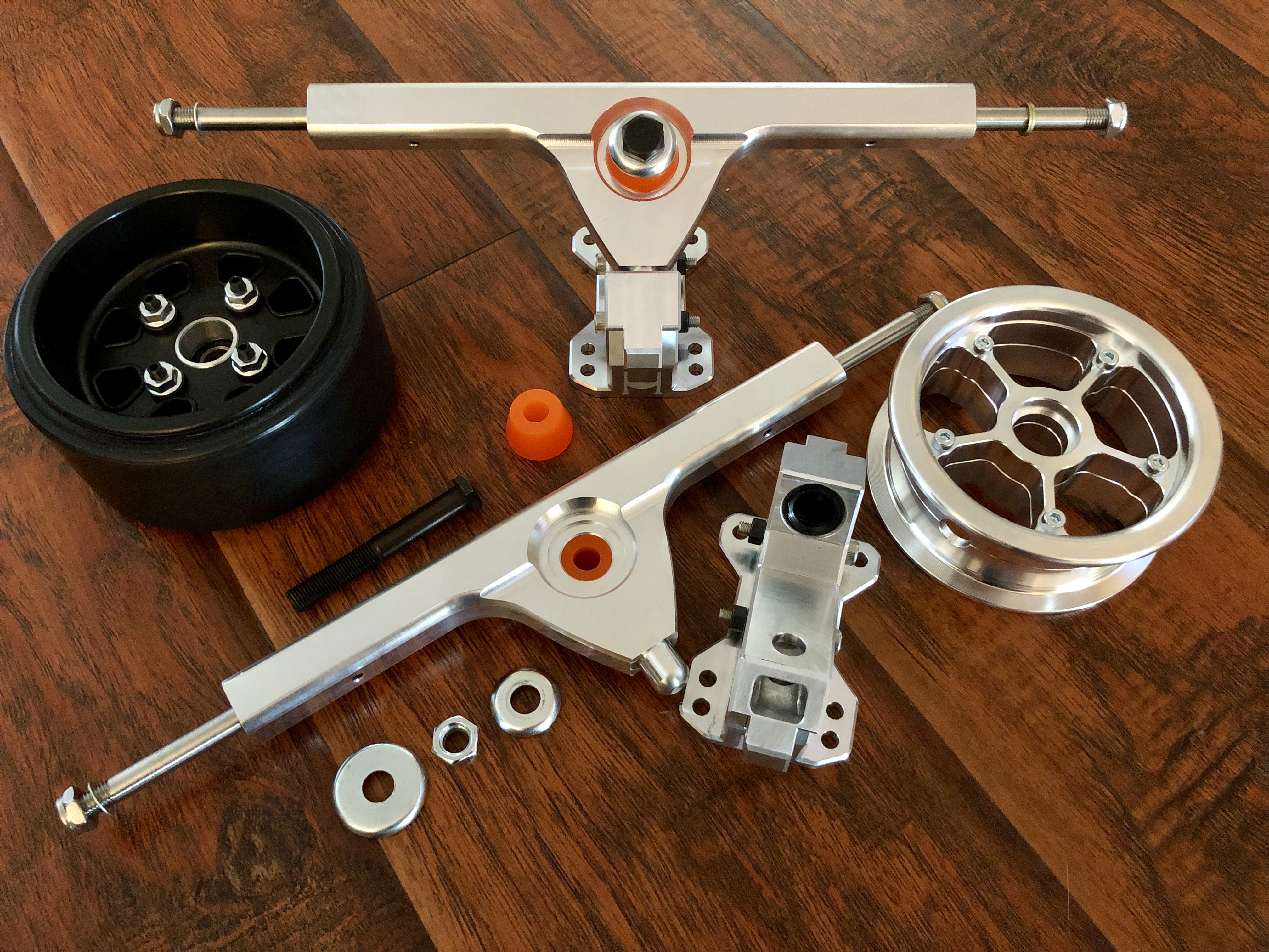

Caliber style trucks fit
Paris style
Kahua
