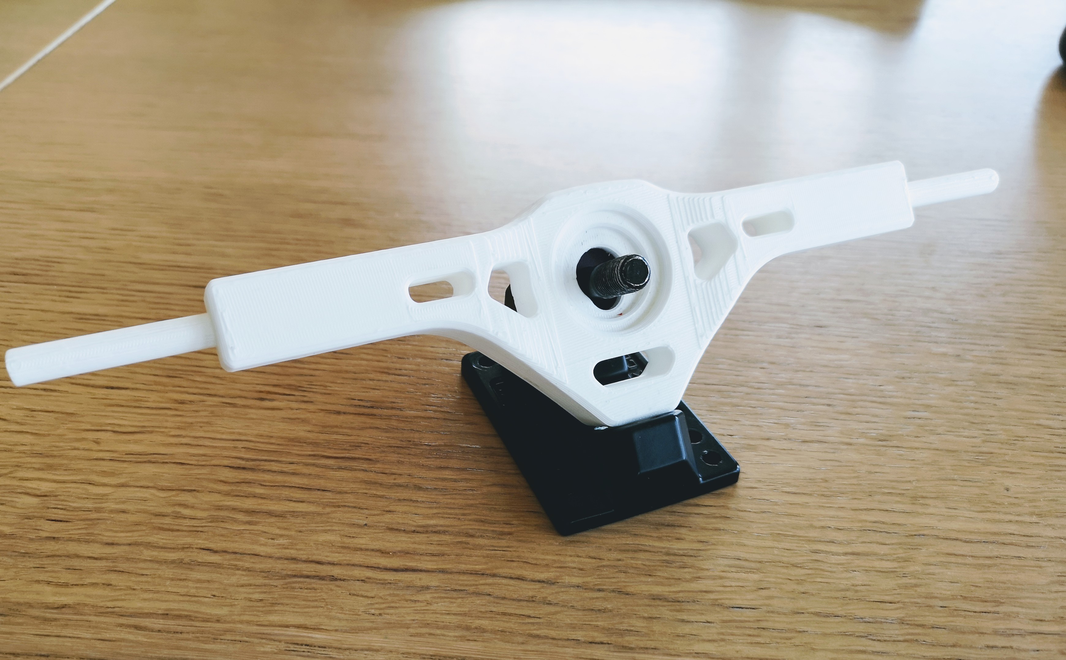

Working on something similar :slight_smile:
Nice! I already remade mine 3 times :joy:. It almost done (I hope) need to find the final pattern. I like a lot the empty space in the hanger to bring the weight down but not sure when it’s too much. I see precision trucks with a lot of material removed.
Do these holes don’t weaken axle?
No, they do not weaken the axle. They might weaken the hanger :slightly_smiling_face: I will make them a bit different and use them to stiffen up the truck and cut weight. Also doing FEM analysis helps you spotting stress points. It’s pretty normal for precision trucks:

Right now I am more concerned with the geometry than getting the strength right. Trying to do something newish and research and not let me blindly rely on existing geometries, in the end it may end up close to what others have done before, but I need to know why different trucks look like they do and what is accomplished with all the variables. Which is what motivates me. Maybe someone in here can give they’re experience. How would a 0mm axel-kingpin offset work together with rake for example.
Try to do the same research too about geometry ecc… Didn’t find something that really gives you a decent knowledge. I guess every brand keep close their findings.
This design with possible + or - rake will be nice !! Just with a flippable hanger !

It’s never a first try. Hammock got up to V8 before get it close to know.
I started all over like 3 times :sweat_smile:
Hey @Riako did you test on a few different hangers and bushings?
I’m wondering if the bushing height is critical to not having to change the kingpin out, or if you had to stack any particular bushings/hangers to set bushing squish just right. I guess it’s try and test but not sure.
From looking in hand there is no way to run the kingpin through the nut by more than @2mm, so I guess you approach it by another way? Asking you since you maybe have tried with different parts.
As I said to @Riako if the kingpin fits without the nut at the back then it will work. You only have to tight. Try to put the king pin in without the nut and you will see the magic :wink:
I made it in a way that 90% of what available will fit as stock. Only for reply double cone bushing or really small you will need a short kingpin that you can get for 3 euro. For the rest should be fine.
