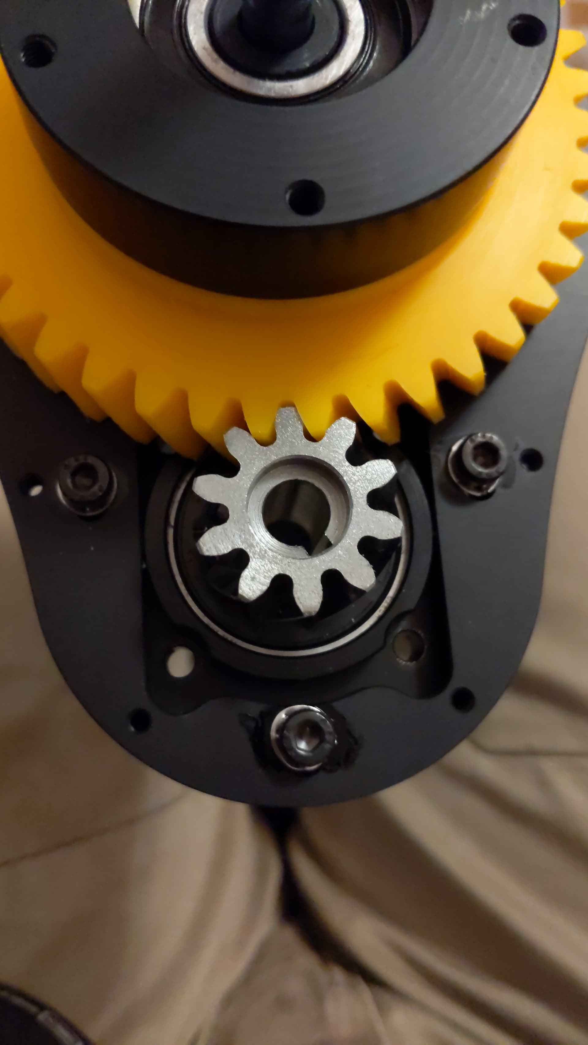

I’m assembling some drives at the moment, and noticed that the pre-loctited bolts still had some runny red threadlocker, and I could unscrew them without using any heat. As if it were blue.
Am I being too paranoid unbolting them all and using green loctite instead? My urethane gear drives came apart after I used red, so what gives? :confused:
(Also, I’m surprised how tight the pre-set mesh is. Doesn’t get stuck though, so – damn! Nice! :smiley: )
(Ironically, the angle adjustment bolts I cannot unbolt without heat, lol. Will leave them be then)
Nevermind, this one is too tight for me to leave it like that. Will fix.
looks like the motor shaft isn’t even in there, isn’t it the correct distance after getting the gear on the motor?
The gear is locked into place using those 3 bolts and the bearing beneath it. Adding the motor does not shift it in any way. On the other drive I can tilt the wheel gear a little back and forth, on this side the motor gear is pressing against it and I cannot; therefore it is too tight.
