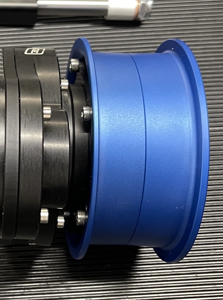

Xcell adapter is offset towards the inside of the rim, meanwhile MBS adapter goes against the side of the rim. Different designs do not require spacers, results in less hassle with centering.
is the xcell hub pictured the wide version?
The hub in the picture is the standard hub, but the gear drive fits the wide hub without any modifications.
