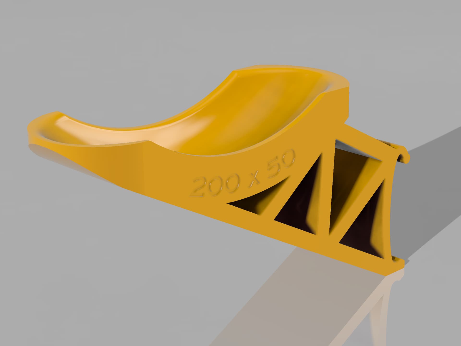

Made these to fit a Rubbermaid FastTrack system. Designed for 200x50 wheels/tires. I printed mine out of ABS and they work great. If anyone is interested I can post or host the files somewhere.
Add them to the wiki :slight_smile: Futureproofing and stuff
Fuck yeah! FastTrack is holding a bunch of my boards currently but I like this design. Please share when you can.
@Linesflag @Venom121212 Here you go - I just uploaded the STL to Printables.
https://www.printables.com/model/521545-rubbermaid-fasttrack-200x50-esk8-holder

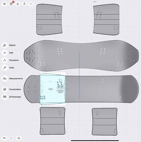

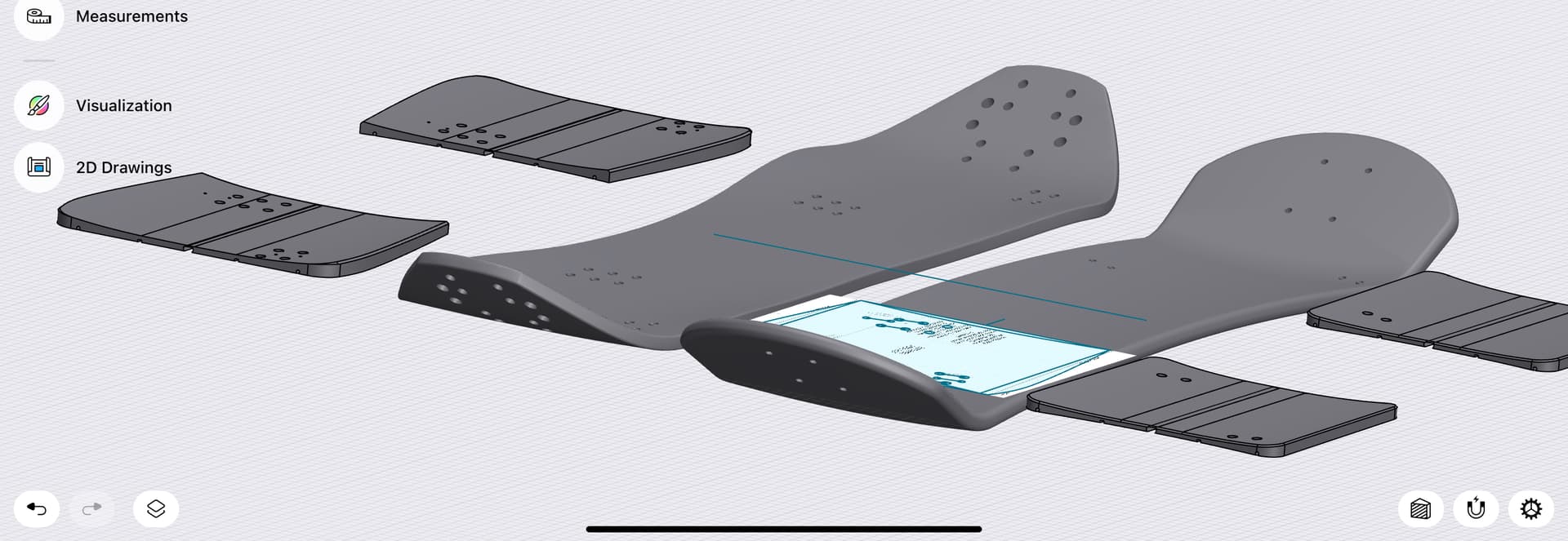

I designed and am currently printing 83a esun TPE (not tpu, a chemist knows… @jamie ? Or not that kind of chemistry?) AT Mountainboard pads with groves for wires and attention paid to binding mounts.
Designed for MBS 97 pro and haero bro. I saw the Apex board tpu printed pads for $80ish USD.

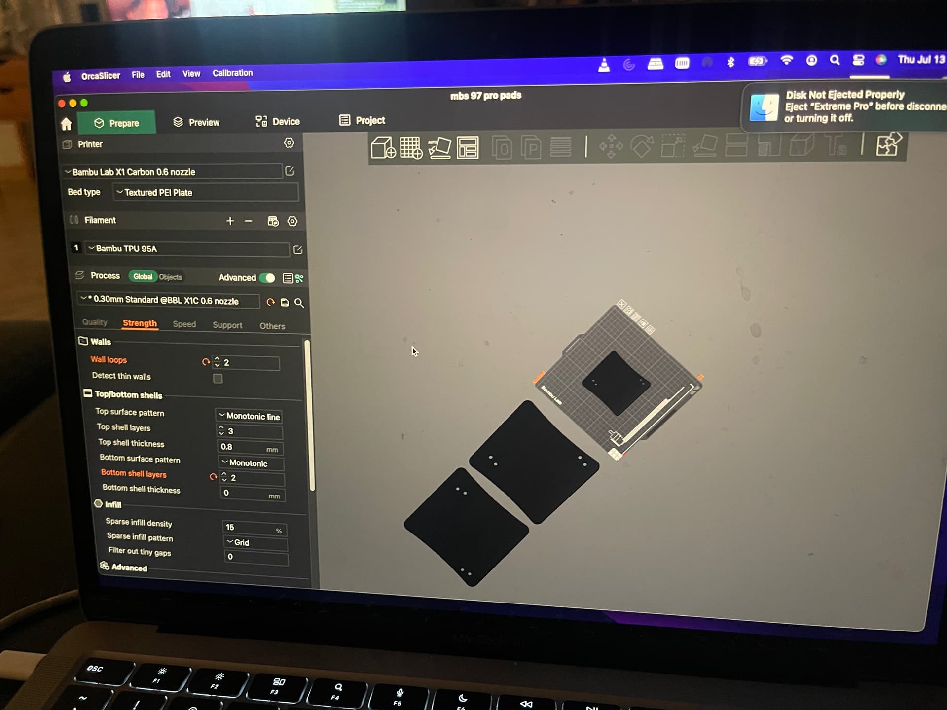

“I have a printer and skateboard why not diy?” :roll_eyes:. 50% scaled mock-up and filament tune test took 2 hours for one pad on a bambu x1c with a modified bambu TPU tweaked profile, 0.6mm nozzle.
For a set of 2 TPU pads printed with normal walls, 15% percent grid infill, 16hrs to melt 340gm of elastomer?!?
Are you pulling my creality ender 7 nozzle at 250mms2 or is this reality?
I’m guessing the apex pads were as reasonably priced as the jump drives. Asking for bambu tpu/TPE print advice, or I’ll post in 32 hours, 780gm lighter with draft pads mk1.
Even George thought something was off.
I “accidentally” printed TPU on my Bambu P1P with the PETG profile. It worked out totally fine.
I used the high temp plate and the tpu did NOT want to come off of it, engineering plate worked well for me with default settings for generic tpu
