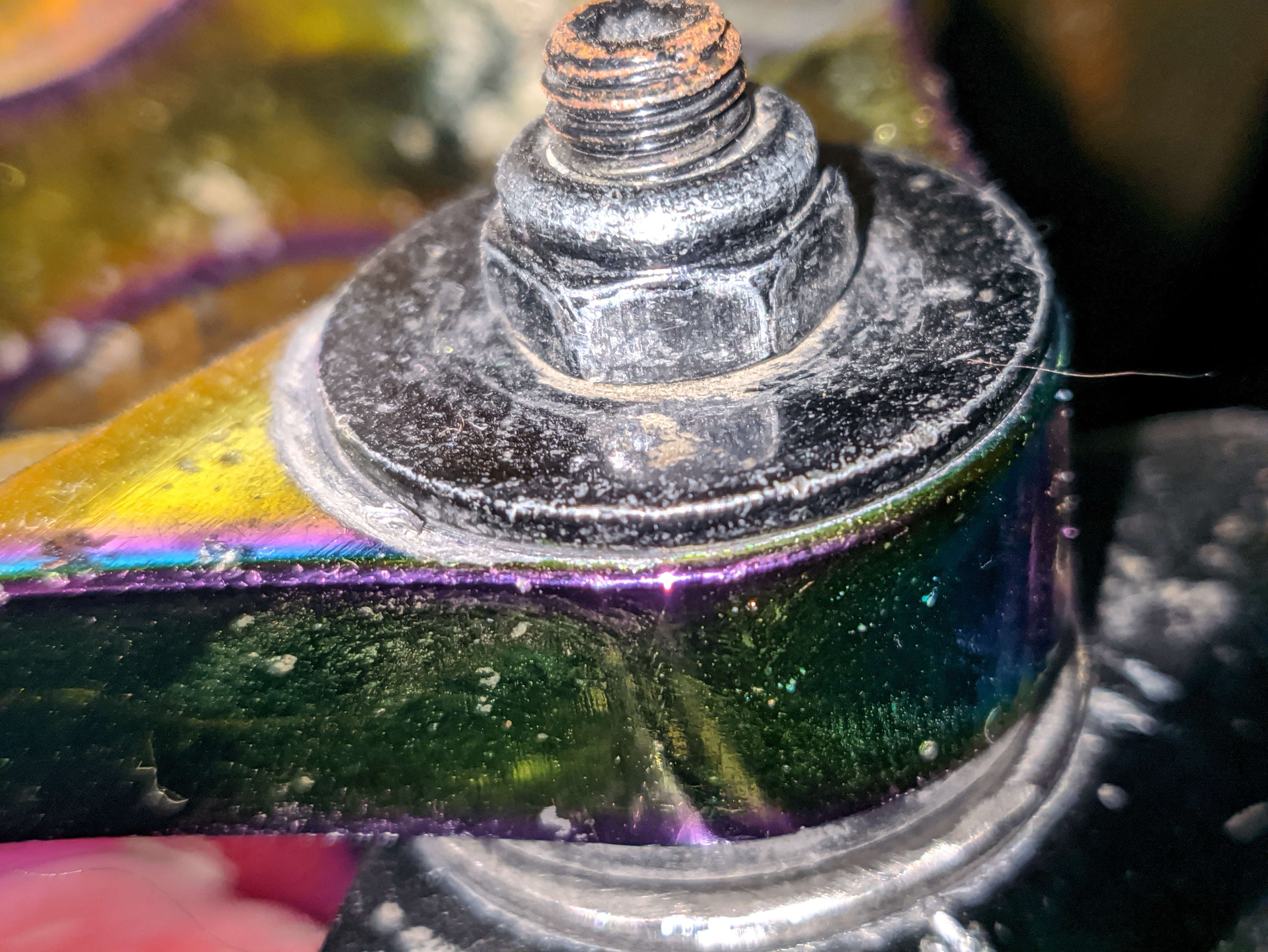

Next time you pull out the pivot pin, look inside the tube of the hanger, it will be galled due to metal to metal contact. If the pin was locked and moved with the hanger, it would rotate in the flanged bushings insulating the hanger from the base plate.
@tipsy
Here you can clearly see how much the metal to metal contact has eaten away.
Don’t the MBS Matrix trucks use plastic bushings around the axle like Tramps trucks?
On the inside yes but not outside.
Yes, on the inside of the baseplates if that makes sense
I find this happens when the washer is not centered on the 8mm shaft and instead binds on the shoulder. it’s then gets off center and loose. I suppose it could also happen from worn bushings.

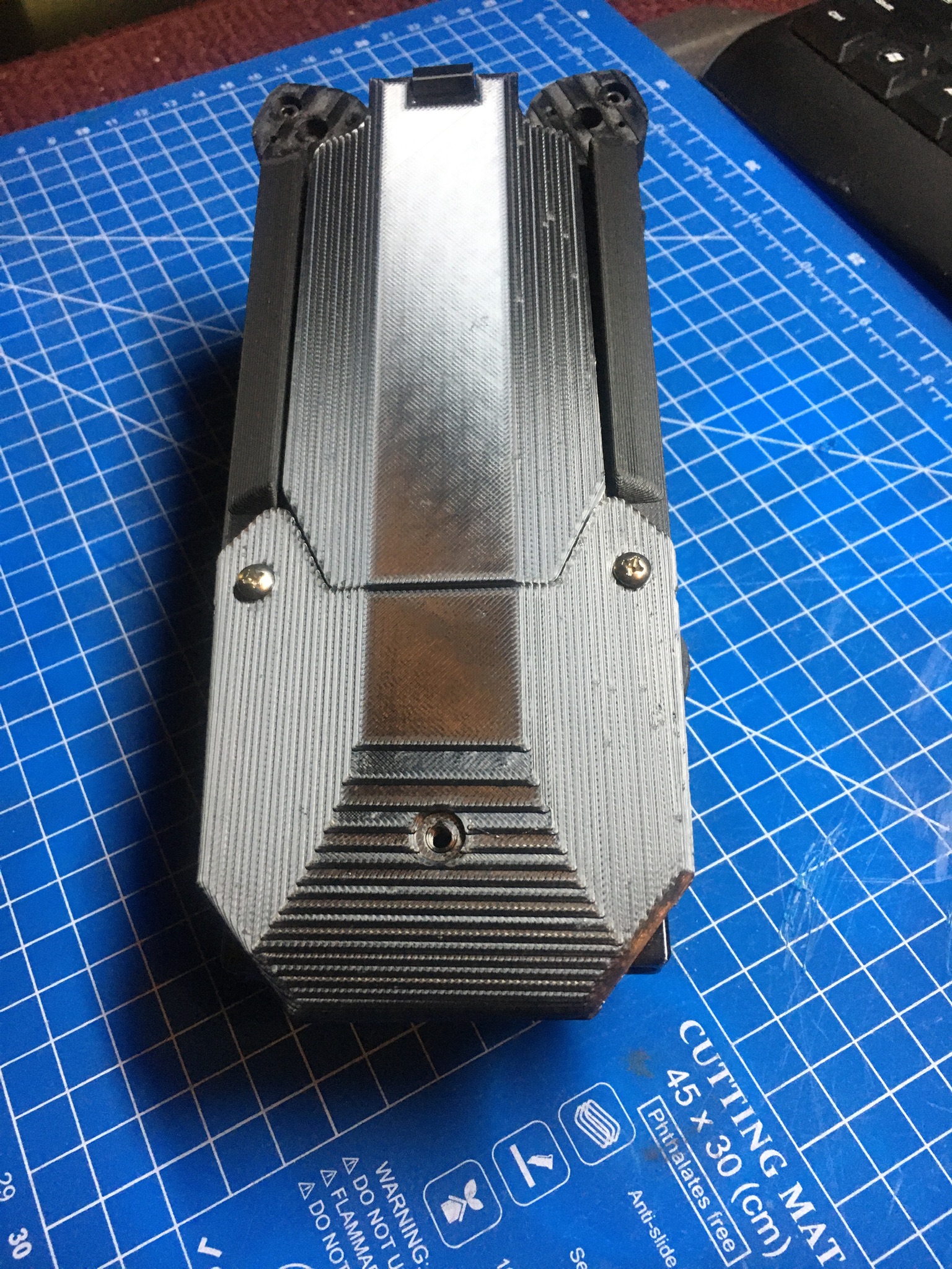

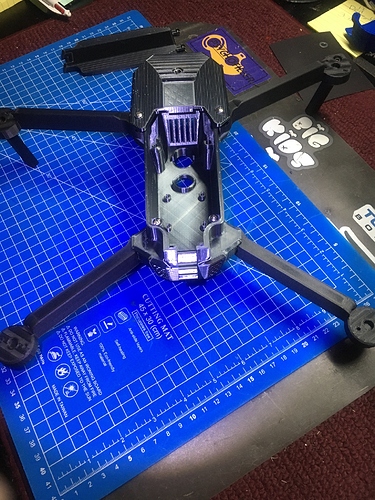

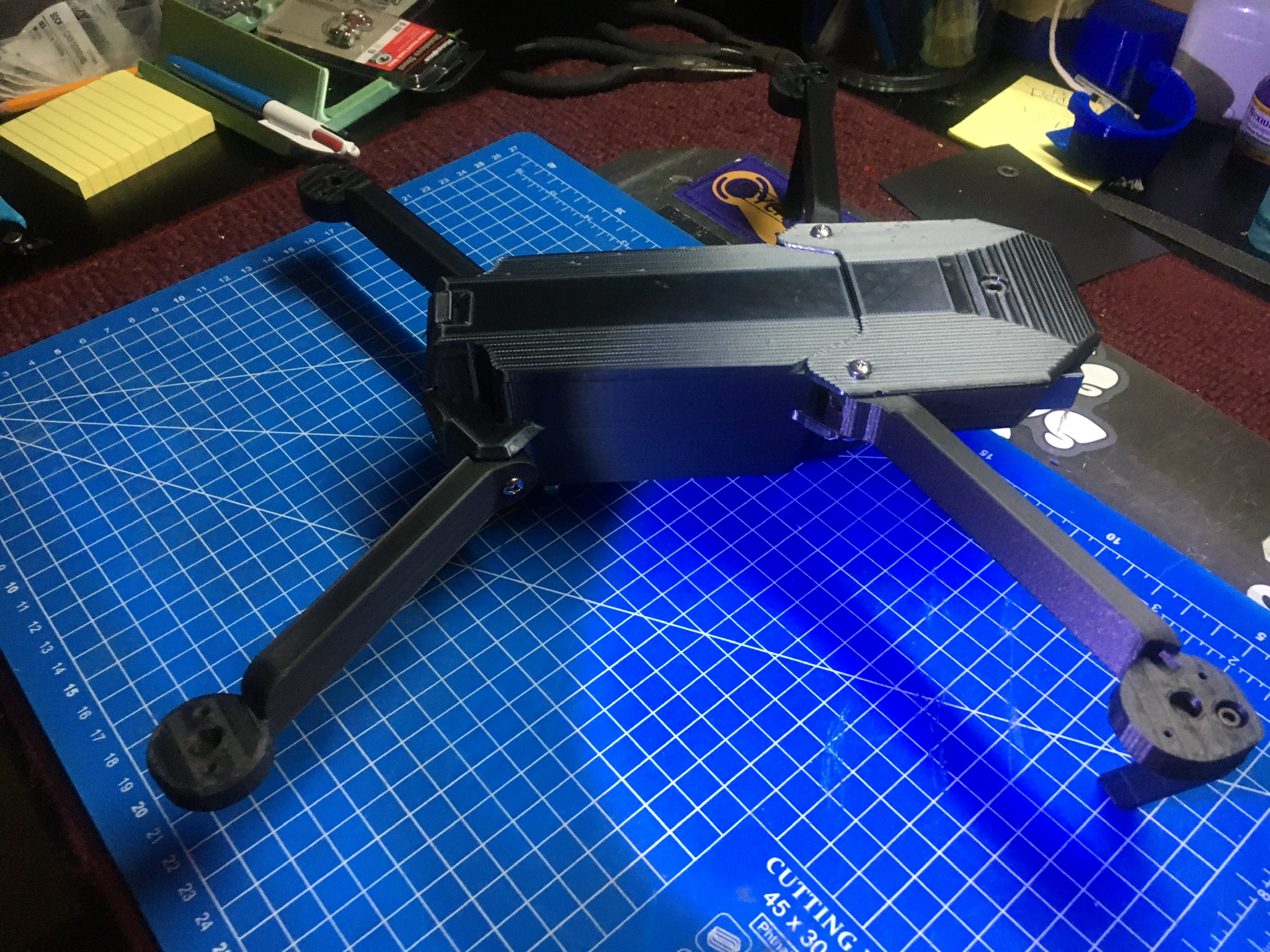

Might be off topic a little. Printed this on my ender 3 pro, mavic pro clone for my son to use while eboarding. Does anyone have experience building drones. Could use a little help
Not quite drones but I know @DEEIF had a thread for FPV quads and @kook seemed very well versed in the field
@poastoast
@monsterbuilder
What kinds of questions do you have?
I know a thing or two about building drones.
One of the questions im curious is if 8330 folding props (mavic props clones) will fit on 3.17mm shaft on racerstar 2212 motors?
Also, do i have to use nylon screws to build the body or are regular bolts and nylon nuts ok? Will regular 6x32 screws be too heavy, its what i’m using right now?
I seriously doubt it, since DJI props are proprietary. You are better off just buying DJI motors to go with the DJI props.
Also, there are several folding prop options for miniquads available today that didn’t exist just a year ago. So you shouldn’t have a hard time finding something that will work. Will just take lots of reading and comparing product data sheets to find the best combo.
Nylon screws will work just fine, for flying that is. That’s what we were using 5 years ago when miniquads were first developed. The problem is they dont have the proper shear force to handle a crash.
So expect nylon screws to break in a crash and depending on your frame design could cause damage to the internal electrical components.
