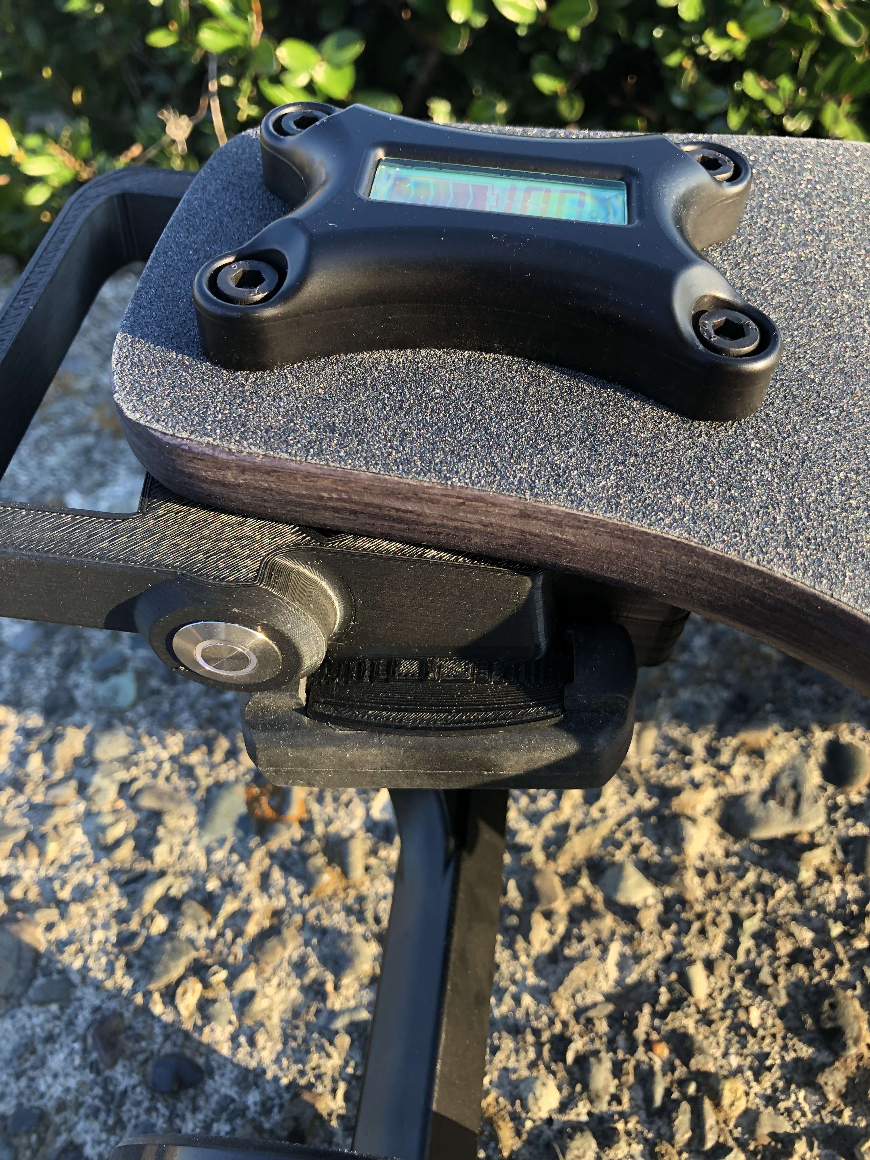

so you are thinking that PLA would actually work in this application? I was wondering how long it would last since it would be compressed by the deck and baseplate with zero movement

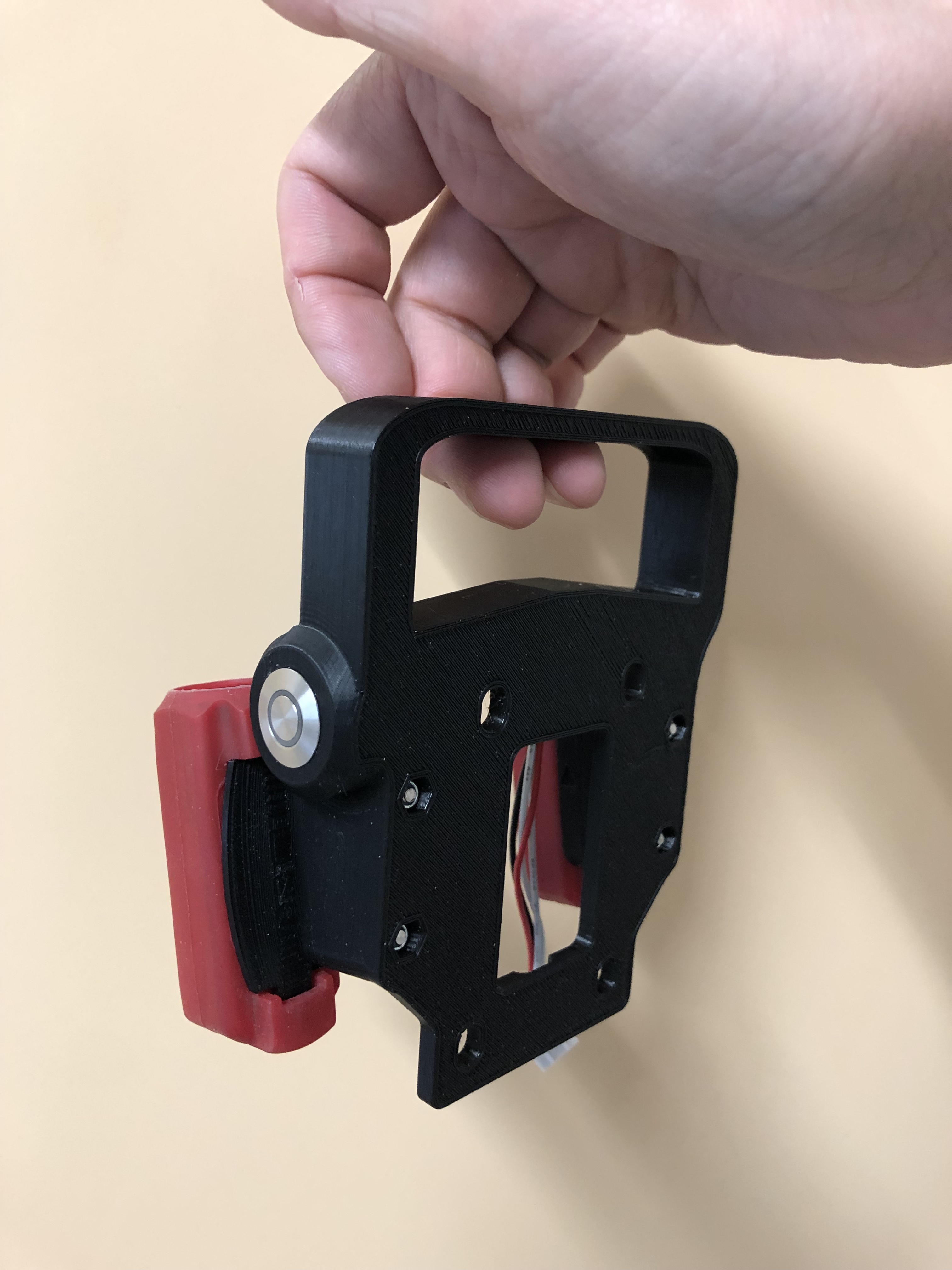

This handle riser is made from Raise3D’s premium PLA, but has withstood for a year and three months.
I’m still using it without any problems.
The thin riser probably won’t bend between the deck and the base plate.
This Raise3D Premium PLA is vulnerable to bending, but surprisingly strong against vibrations and shocks.
I was surprised to learn pla had more compressive strength than petg. Doesn’t do the bending as well though.
Damn, that one is also impressive. Nice work dude!

If you’re worried, you may want to add a thin rubber riser.

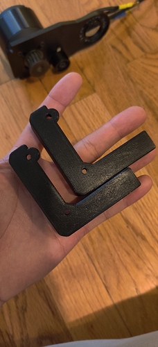

Would anyone be interested in files for these little bumpers that go on BN cal II motor mounts? I made some mistakes on the dimensions but it should be an easy fix
What is this riser voodoo? when why do you choose to use it? ( I can guess. )
is the hole in it big enough for the pin only or for the whole grub screw?
I use them because even the hardest shockblocks are way to soft for my liking and the screw for tension already was at its max.
