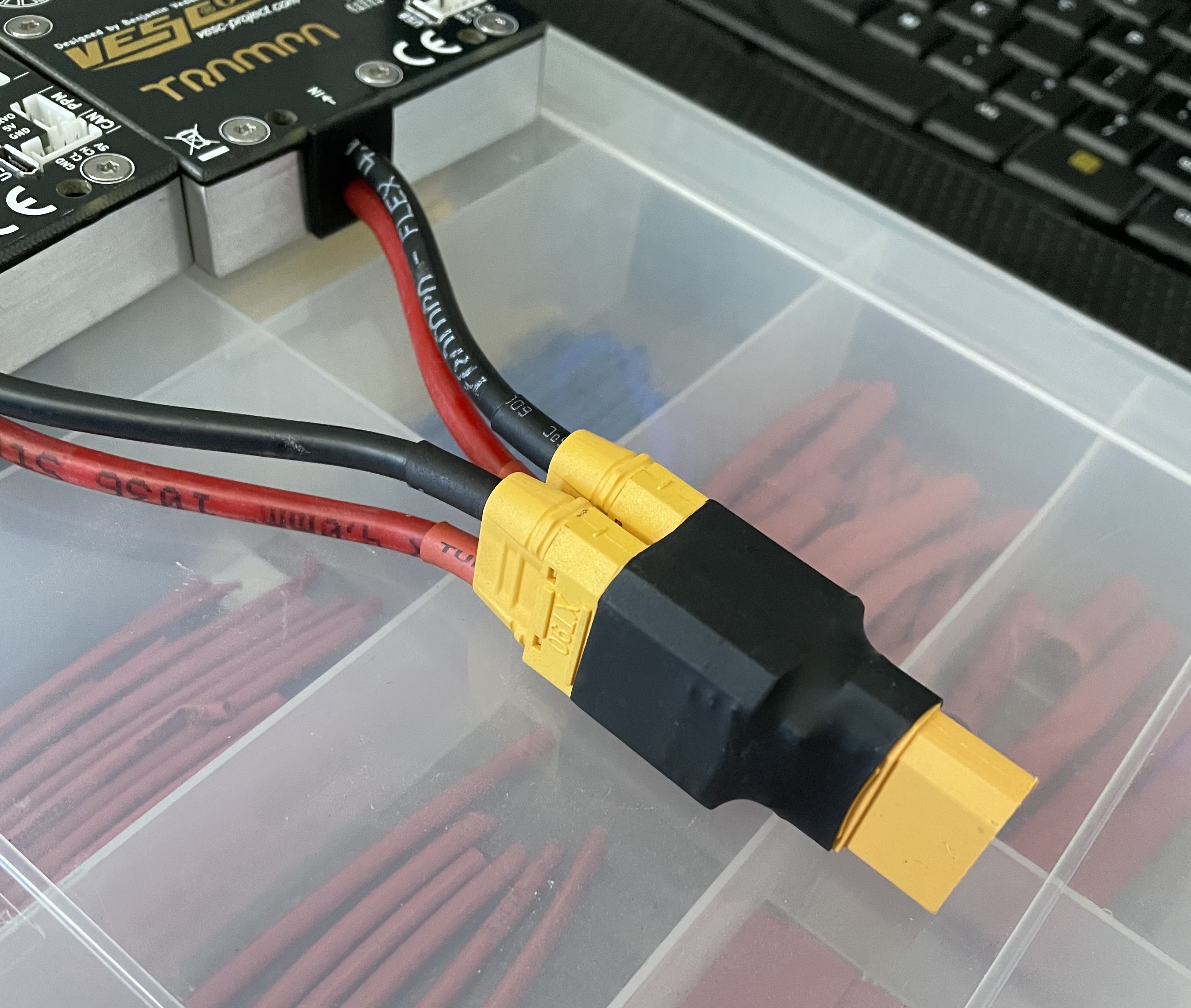

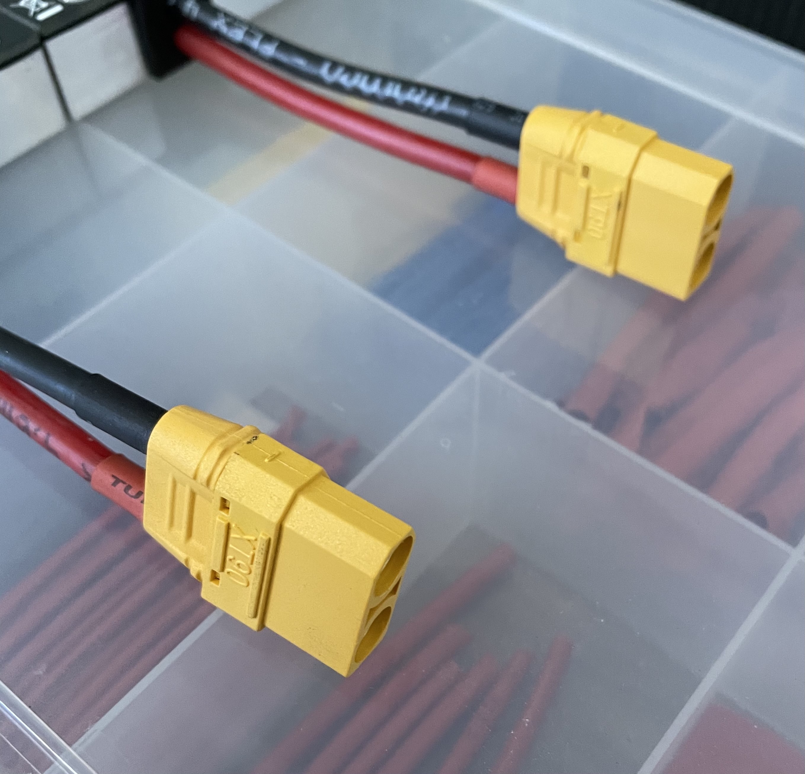

Since I bought this dual XT-90 plug that was done back to front, I had to change the XT-90 plugs on the VESC MKII so it goes in.
Fits in fine :+1:

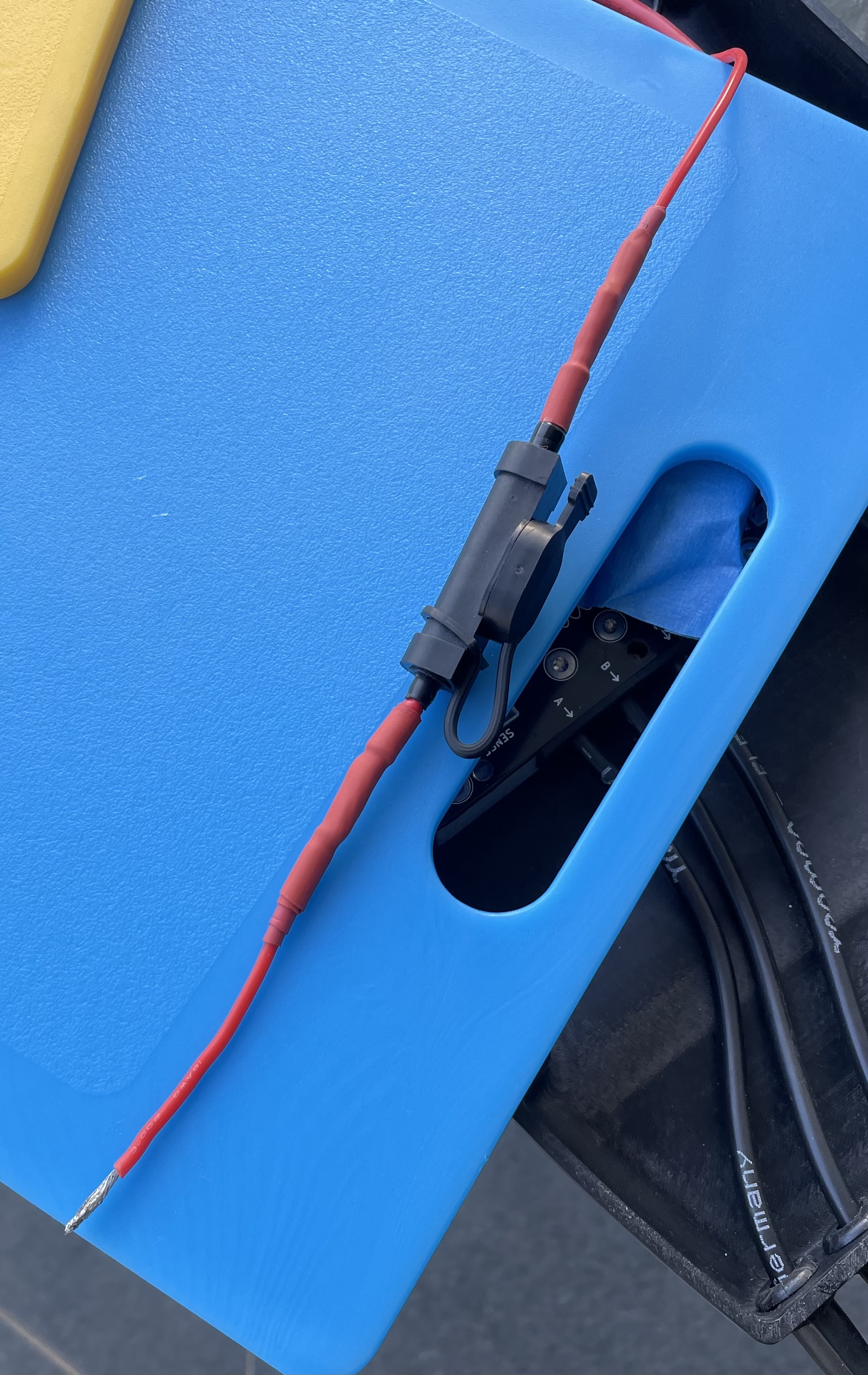

Tinned the charger port inline fuse.

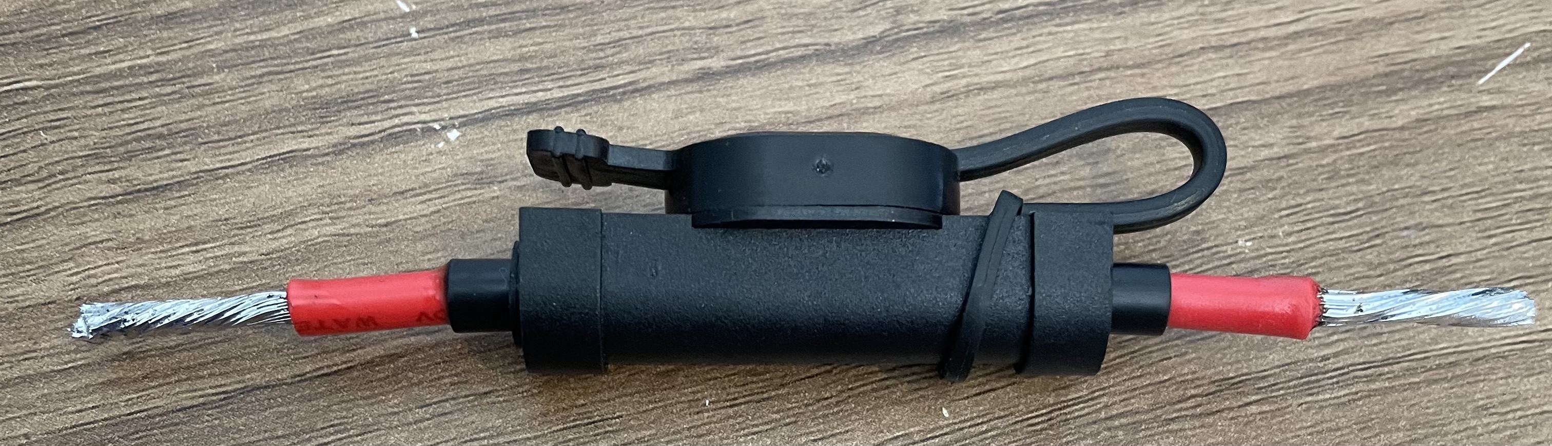

I have worked out where to put the inline fuse.

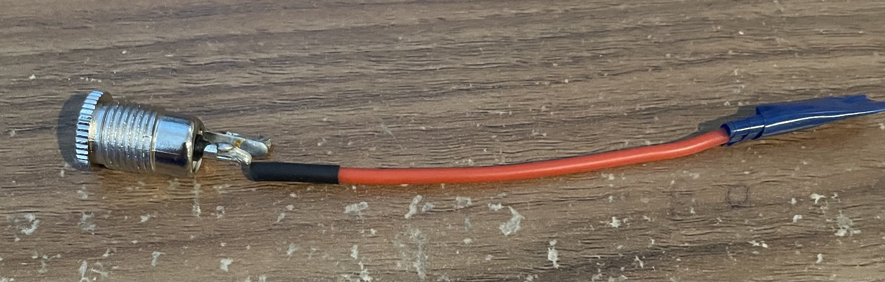

I cut off both charger wires and isolated with electrical tape. I cut off both wires instead of desoldering it, that way I only need to worry about soldering with live wires.
Had a length of the postive charging wire cut as well so the other end can reach the inline fuse.

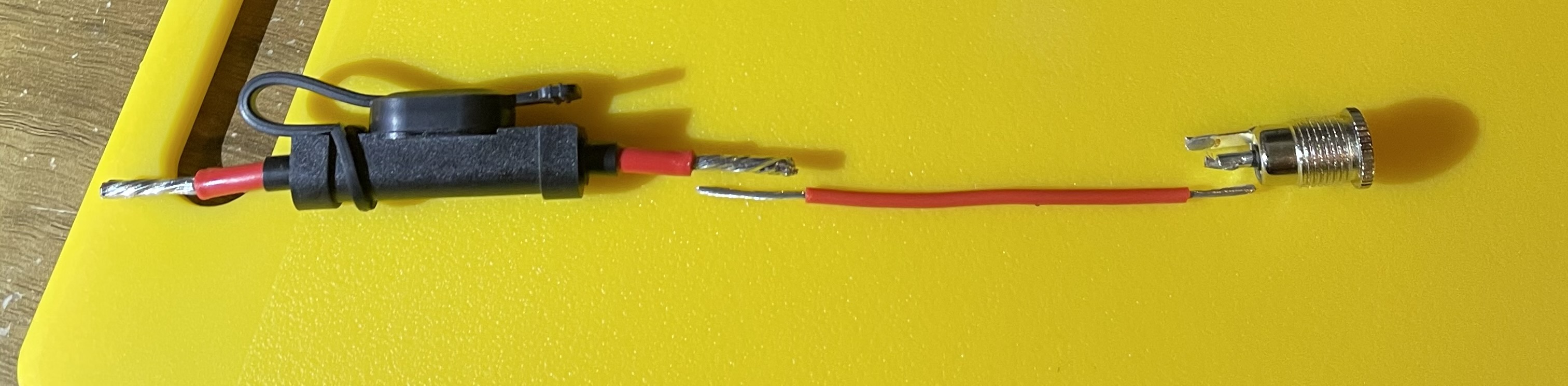

Will desolder the last bit of wires off the terminals before soldering on
Red wire goes to the middle, black wire to the side.
I suggest taking off the heat-shrink of the dual XT-90 to check how good the solder job on it is. Some people have found it not up to spec for the vibration-intensive application of esk8.

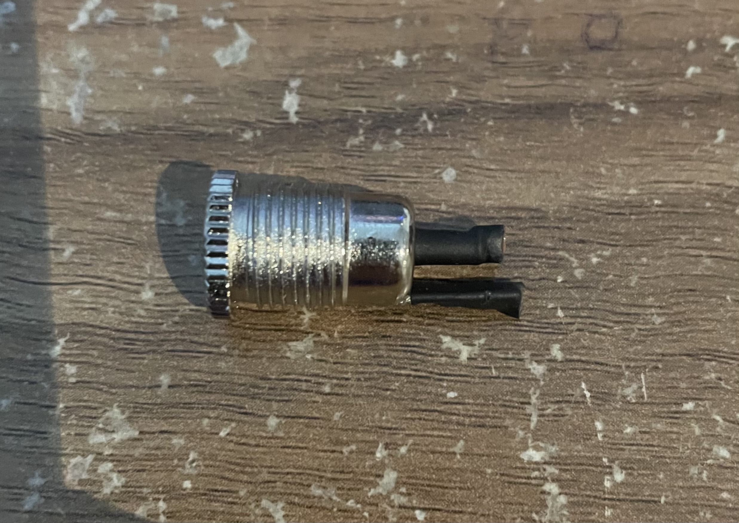

Discovered a minor problem, the hole in the enclosure for the charger is actually about 0.2 mm too small, will have to enlarge it with a drill…FML…
Will do that tomorrow arvo after I buy another charger port. Forgot to plug in the charging jack to help hold the pin in place and prevent overheating…
Played around with it (pratice) anyway and I feel that I got this.

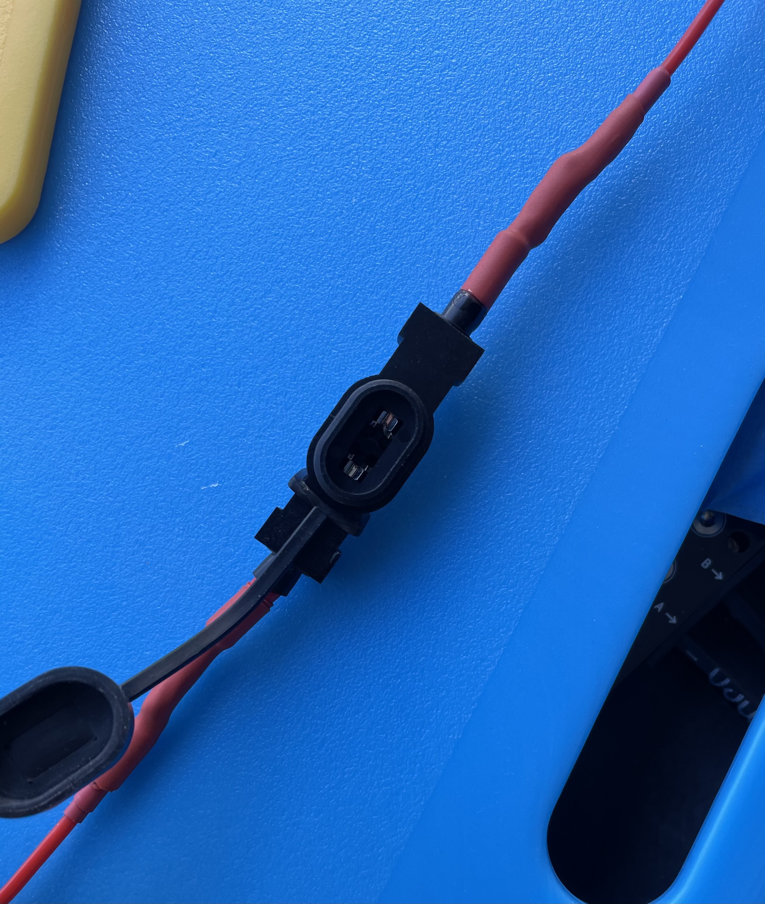

Got home and did the fuse line.

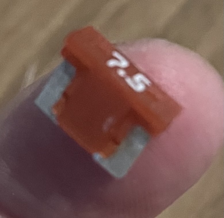

No fuse in the holder, no chance of short when doing the charger port :+1:
Touched negative and postive naked wires, no sparks at all!
7.5 amp fuse rated for 58V

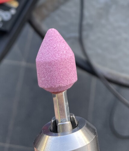

Instead of drilling a bigger hole for the charging port, I opted to buy a cheap dremel and got the hole big enough to push the charging port through
Now I just need to wait for Metr dual to arrive in the mail…
As a fellow builder-in-an-apartment, I feel you. My list of tools keeps getting bigger though. I’d say the dremel has by far been my most used and useful tool. You made a good purchase!
why not fuse the negative of charge port + antispark switch would open a significant amount of options.
