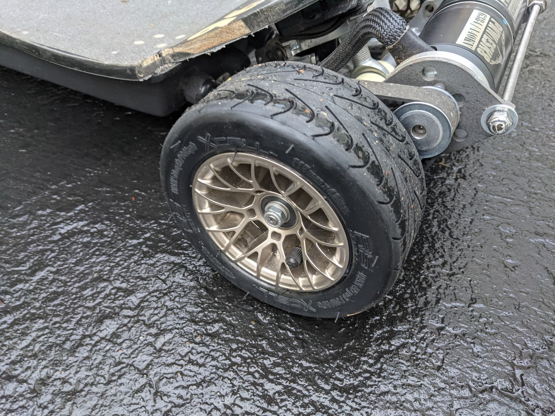

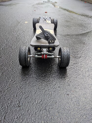

got some close up pictures of the trucks?
I want to see the belly and how the , 3 links interact with the angles.

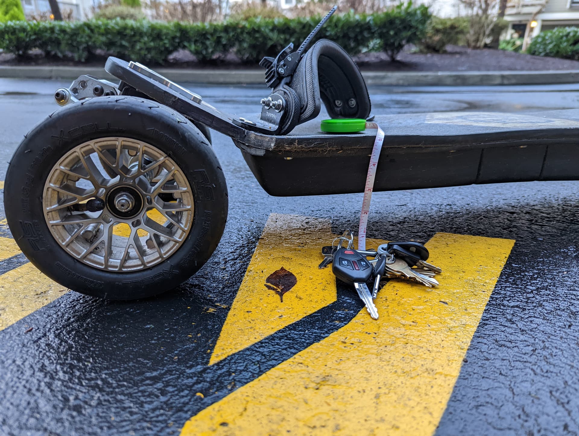

does it sit lower than with matrix II
I’ll get you some more pictures here shortly, a little bit… Closer. I can take some pictures possibly next to the mountainboard as well, it’s on a bro deck on matrix trucks so you may be able to compare a side-by-side even though the tires are a little different.
It definitely sits way lower on these three links. I have the back on half inch riser in the front on quarter inch riser, maybe a half inch, and it’s still super low with a double stack enclosure

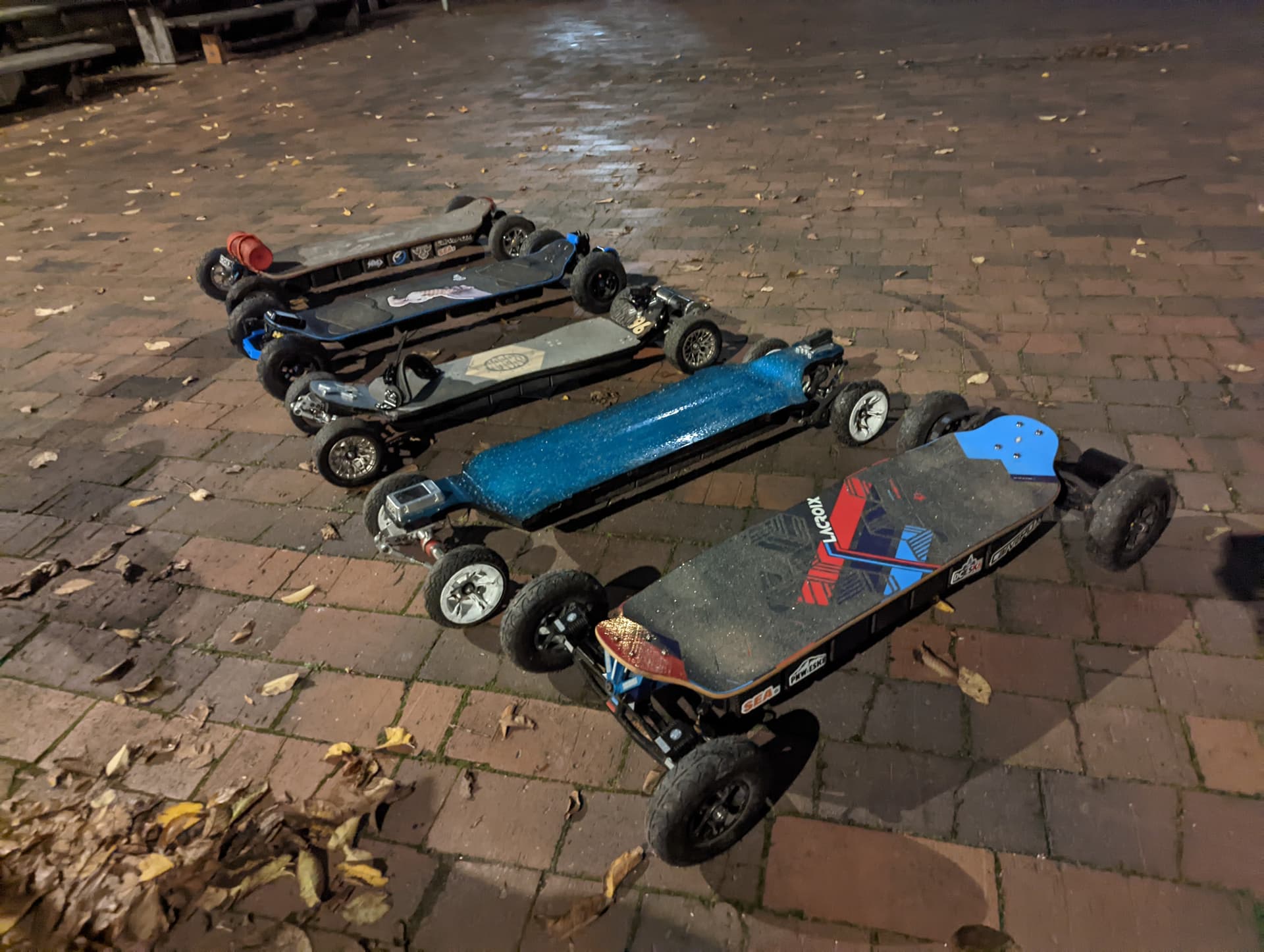

Should get all the bro boards together with different trucks to compare. I think we’re only missing a bro with hyper trucks.

3" clearance, unweighted on a flexible deck :cold_sweat:
