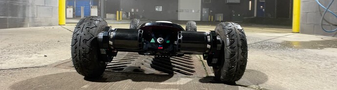

This build is mostly a remodel/makeover of @Yeahthatperson build.
Found here
What got replaced so far, deck and drive train
For the deck I acquired another 1st gen haero bro deck from @Sender
Then thru luck acquired some proto type lacroix hyper truck kites
What makes these special is they are the same width as normal hyper trucks. Vs 16in wide on the production ones.
For wheels I went back with the pentagram by @Ean.esk8.
Specs
Deck: haero bro 1st stiff
Enclosure :eboosted DS for 1st gen
Esc : lacroix stormcore 100d 2
Battery: p42a 18s5p
Motors: flipsky 6385 140kv
Trucks and mounts : lacroix hyper truck lite prototypes
Ratio: 62 newbee wheel pulleys 16t radium steel pulleys
Upcoming upgrades, replacement enclosure, new batteries, ossr, newbee 4g gear drives, skp reachers, skp solos or a 100dx maybe, hellcat wides perhaps. Also lookin at splitting my angles by about 15 degrees but we will see. Etoxx base plates won’t fit. Too narrow of a truck
It’s currently raining and I was rushing with repairs and etc to get it rolling. So will report back with thoughts.

Motors in. Now to swap.
Installed, couldn’t get a good detection with these motors tho. I did 6.0 with flipsky 6385 and it was fine. One side got flux linkage failure with wizard and manually. Swapped the sides and got over current errors for both.
Moved back down to 5.3 and it was fine. So something in the firmware did not like my combination.
Any other 100d2 or plus folks have any input?
6.0 assigns a bad default for Slow ABS Current Limit, and this will cause you to throw over current faults.
It assigns false after wizard motor config., when it should be true.
That is the first thing I would check, but it could be something else too. VESC is fun like that.
My 100d+ has gremlins, and will throw DRV faults on 5.3 and 6.0, but works perfect on 5.2. I’ve spent hours with @jaykup trying to figure it out, and I have now given up. Likely a DRV chip issue, but bizarre how it works perfectly well on 5.2. I want that extra UART dammit. Guess I’ll need a usplit.
Yeah I manually changed some settings then try manual detection. Same result. I’m gonna try to take it on the test loop to see what it does.
I forgot to mention above, I’m also using 6485 reachers, so nearly the same combination. I’m curious if my 100d+ would throw the same faults with other motors. Probably something I’ll never test though.

After some troubleshooting with @Shadowfax and @jaykup @Skyart
Got 6.0 working on this 100d2 with the 6495 reachers.
Will need to bring in some gear to go testing on it
The 3.44 ratio and 145kv motors doesn’t fill the launch feeling for me. Curious to see what logs will look like on the test loop.
You have pretty high top end speed (60mph), and not a whole lot of force/accel with that gear ratio.
1:5 or higher would still give you plenty of speed and give you the launch you’re looking for
