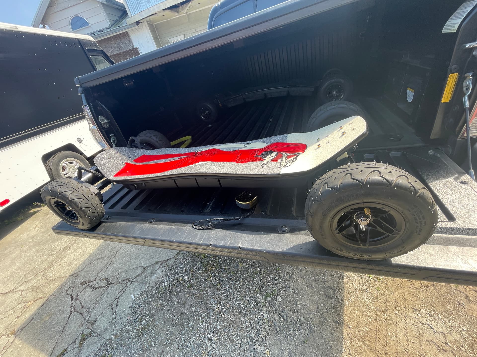

Rexxy the 18s street carver
Even 4.0 would be better. But yeah 5.0 newbee 4 gears whenever they come back in stock
:grinning: @Ean.esk8

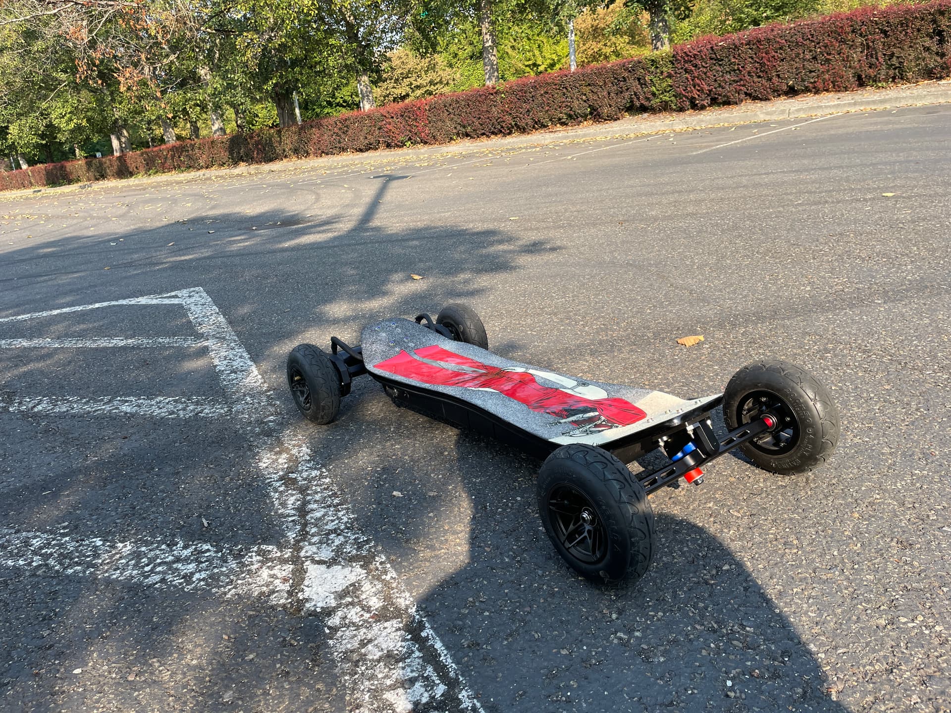

Went test riding before the rain. Pulls good, but I can’t stop :joy:

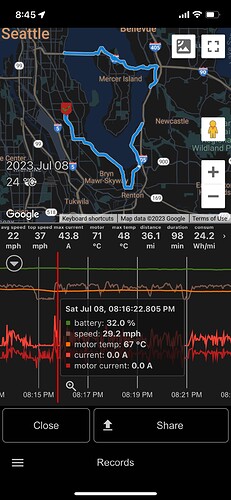

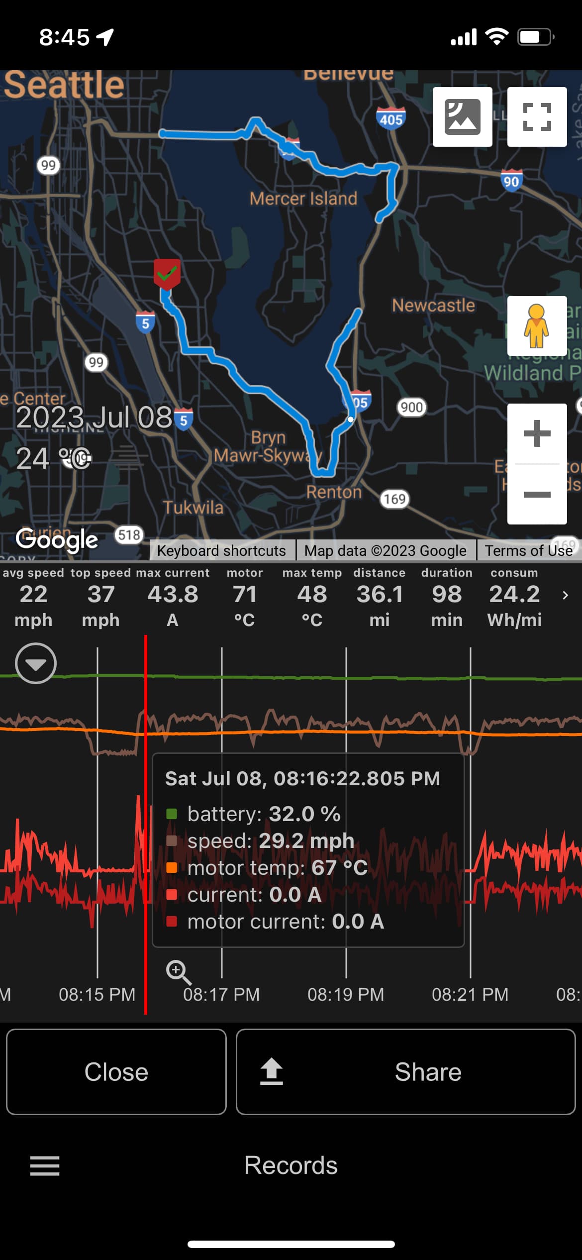

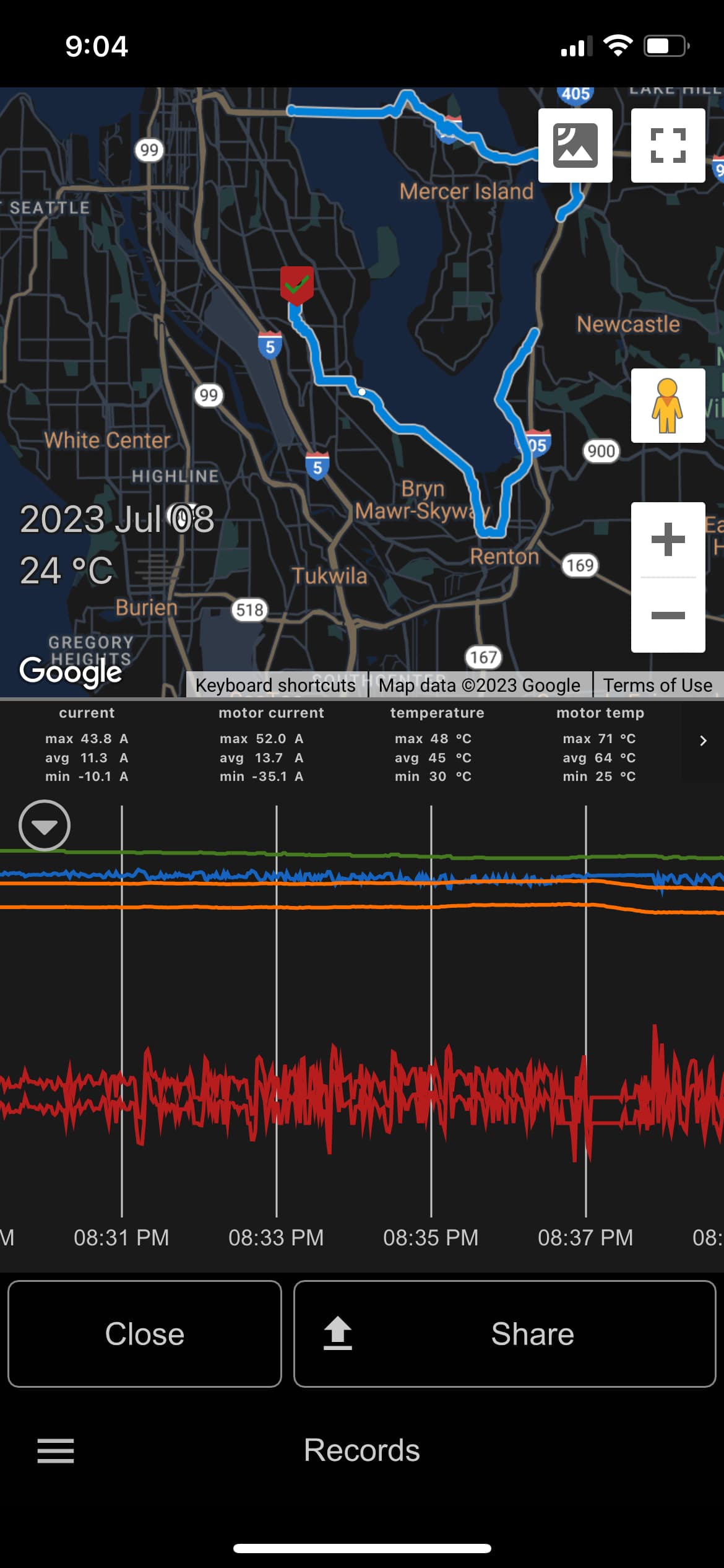

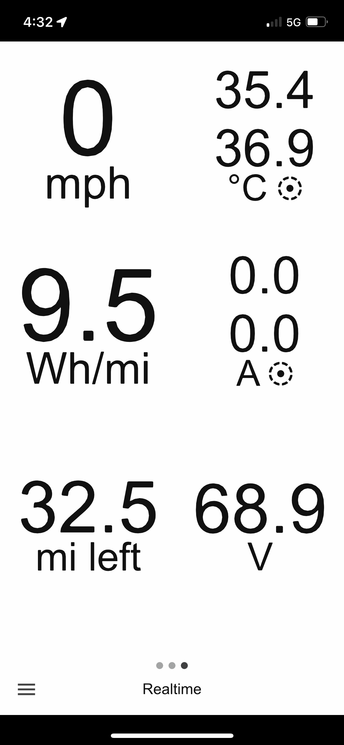

Metr picture was me limping it back to my office haha that wh/mi

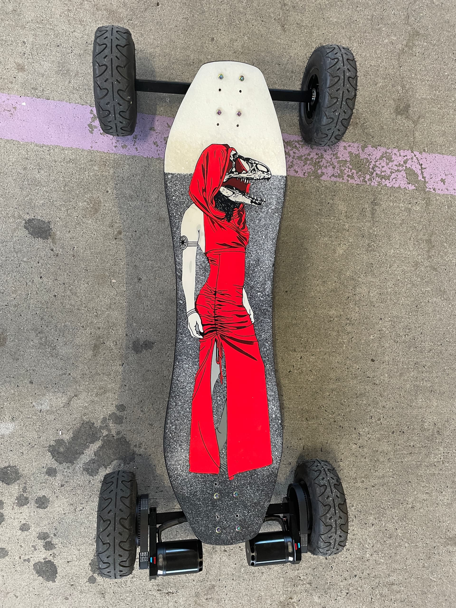

#Ilovegeardrives

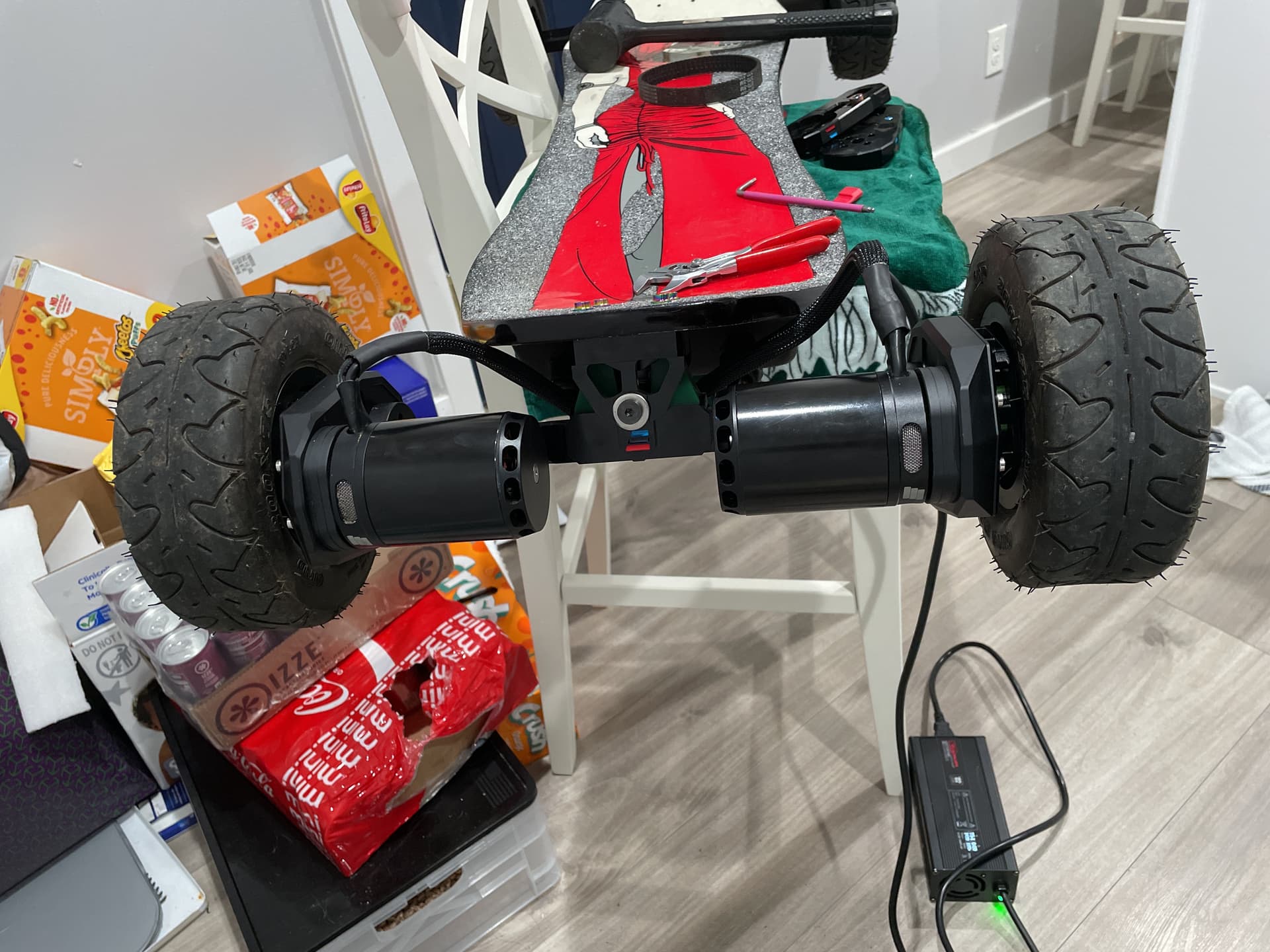

Gear drives in well atleast loosely installed. Need to go thru and locktite everything now.

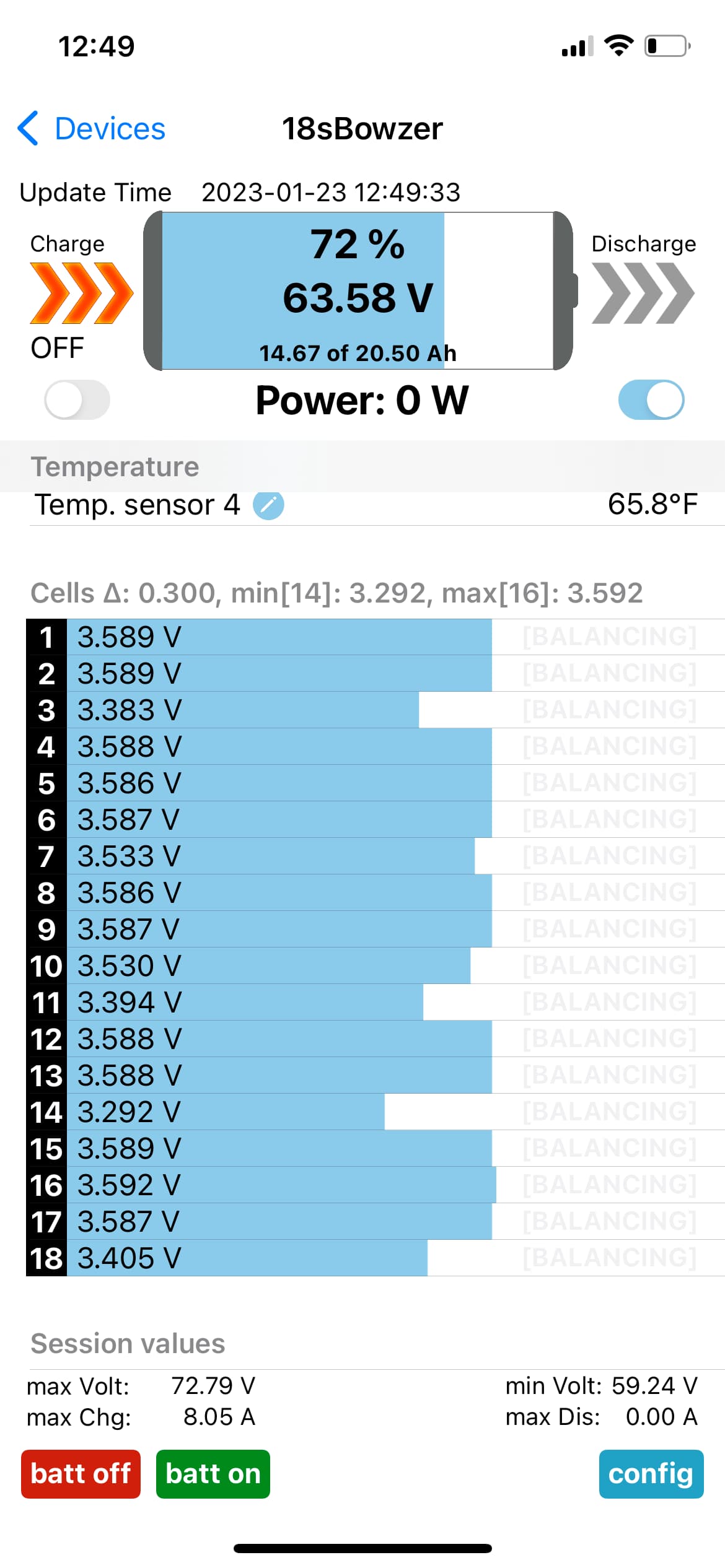

Also looks like I’ll be accelerating my plans for battery since we’re at about 5-6/18 p groups going bad :joy:
I knew what I was walking into so no heartbreak there.

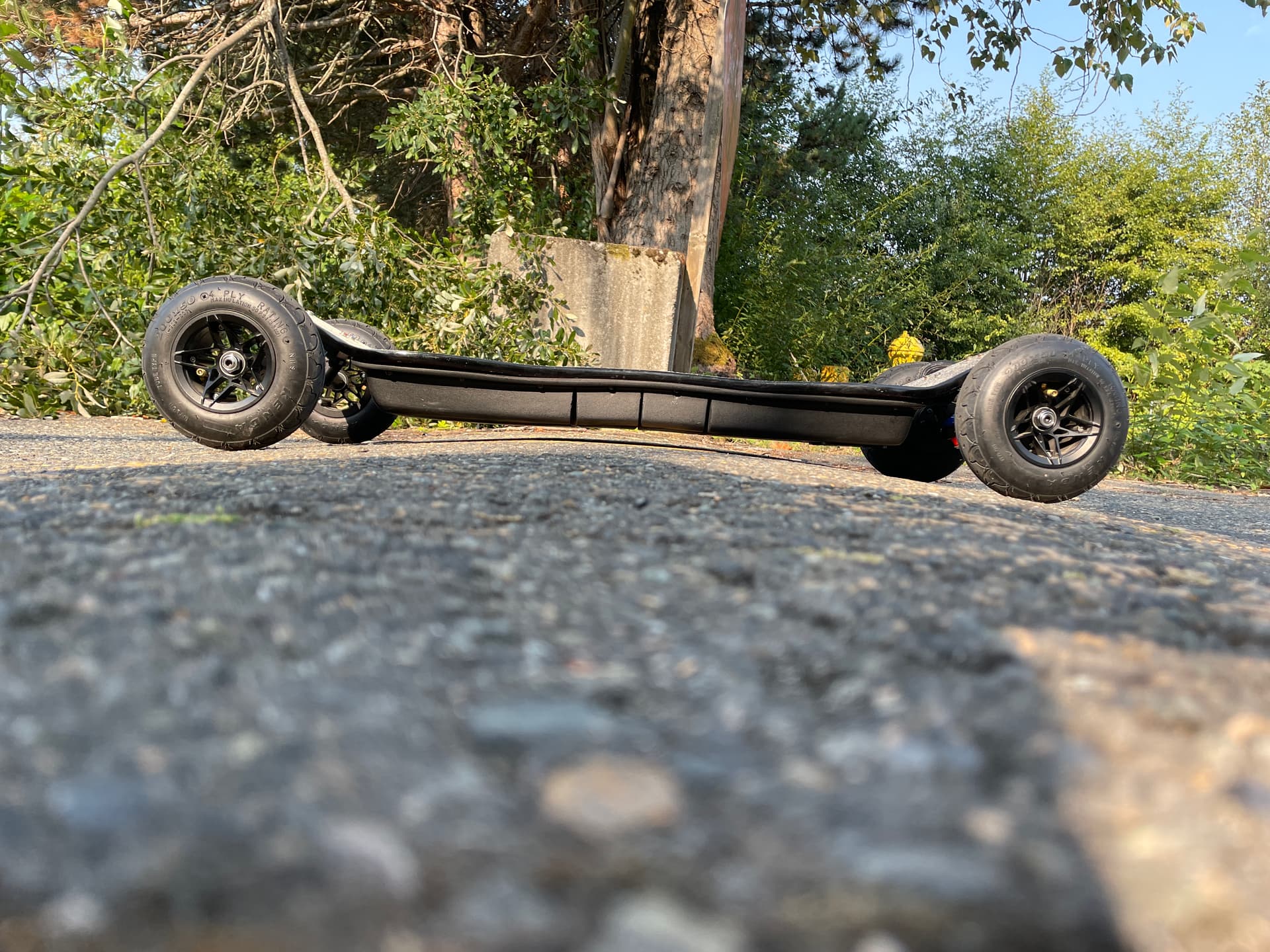

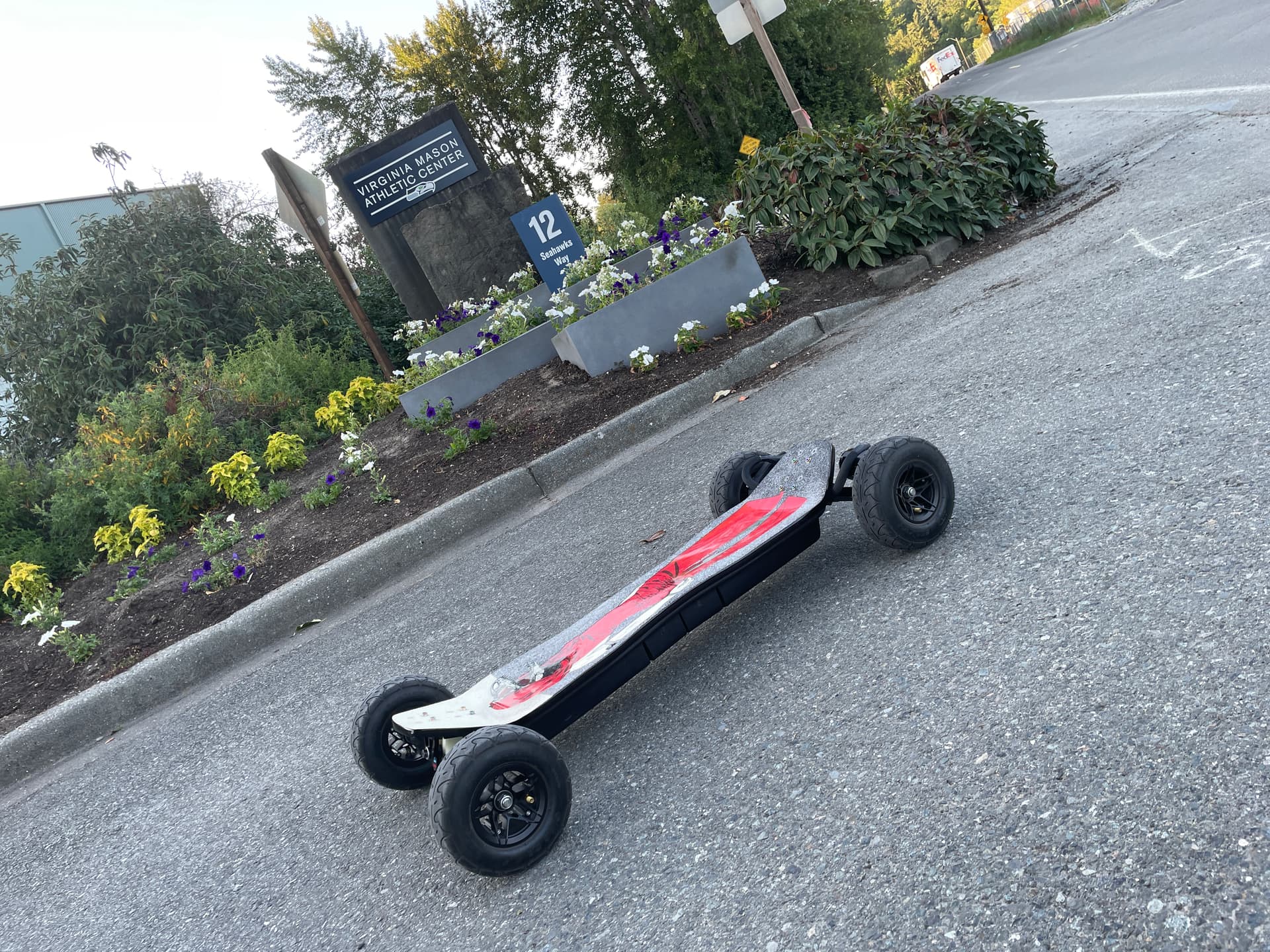

Were you able to stretch your tires even more!? :open_mouth:

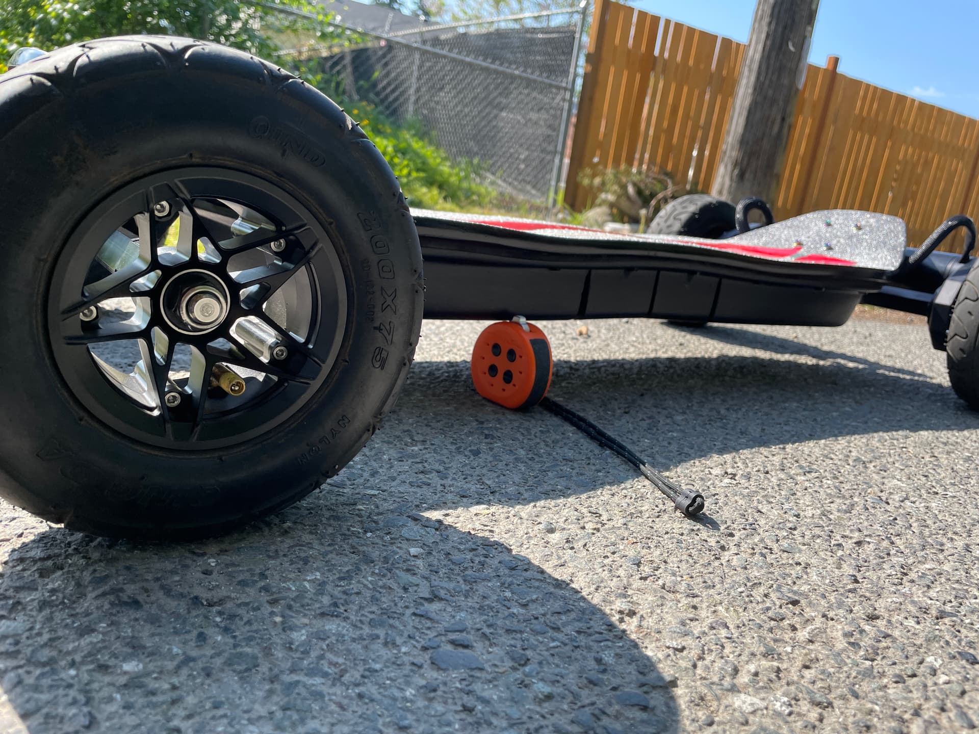

Damn looks amazing!! What tires are you using?
Kaly fatties aka qind tires 200x75
Thanks! Now just gotta wait on his website to start working :joy:

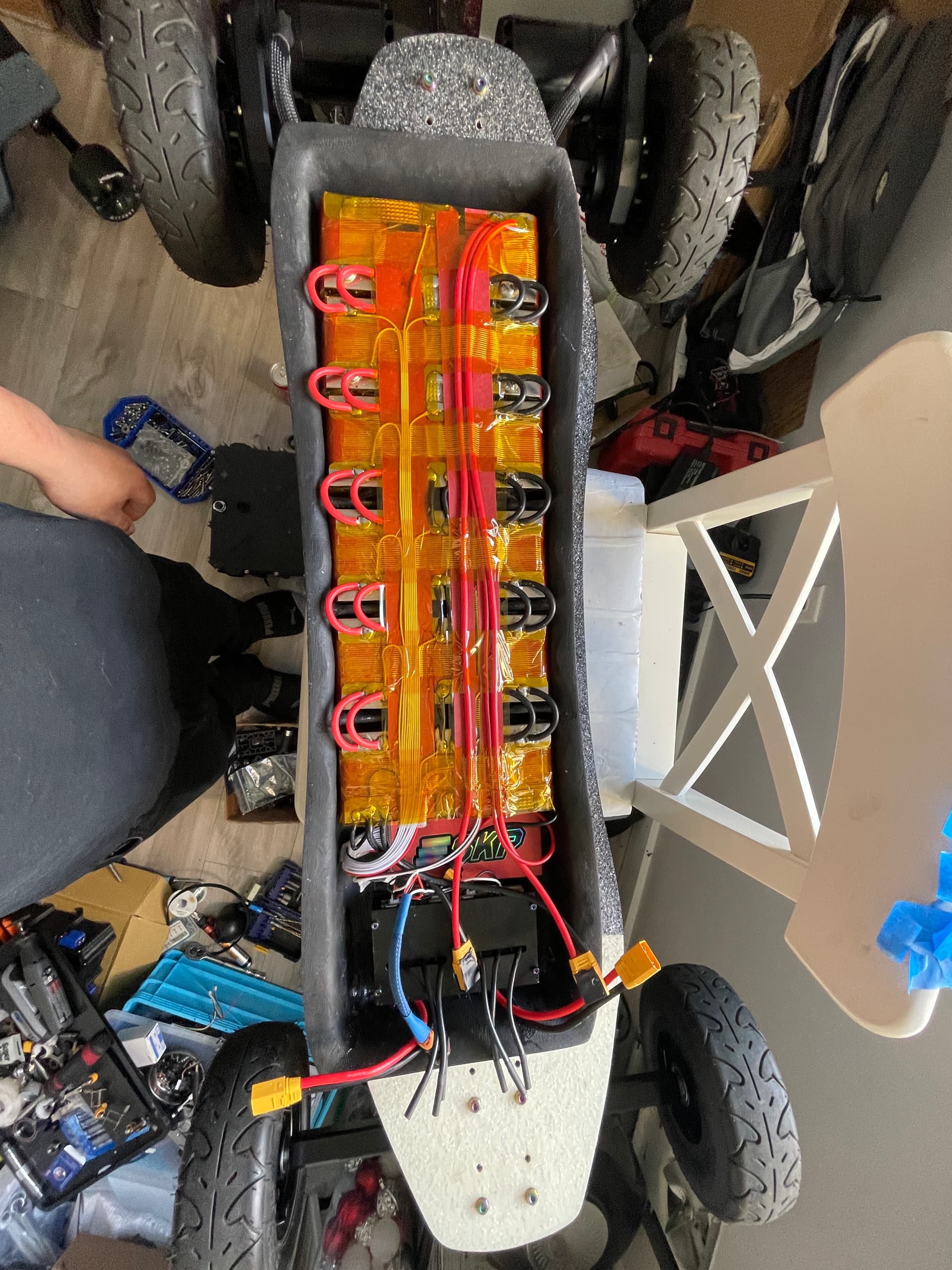

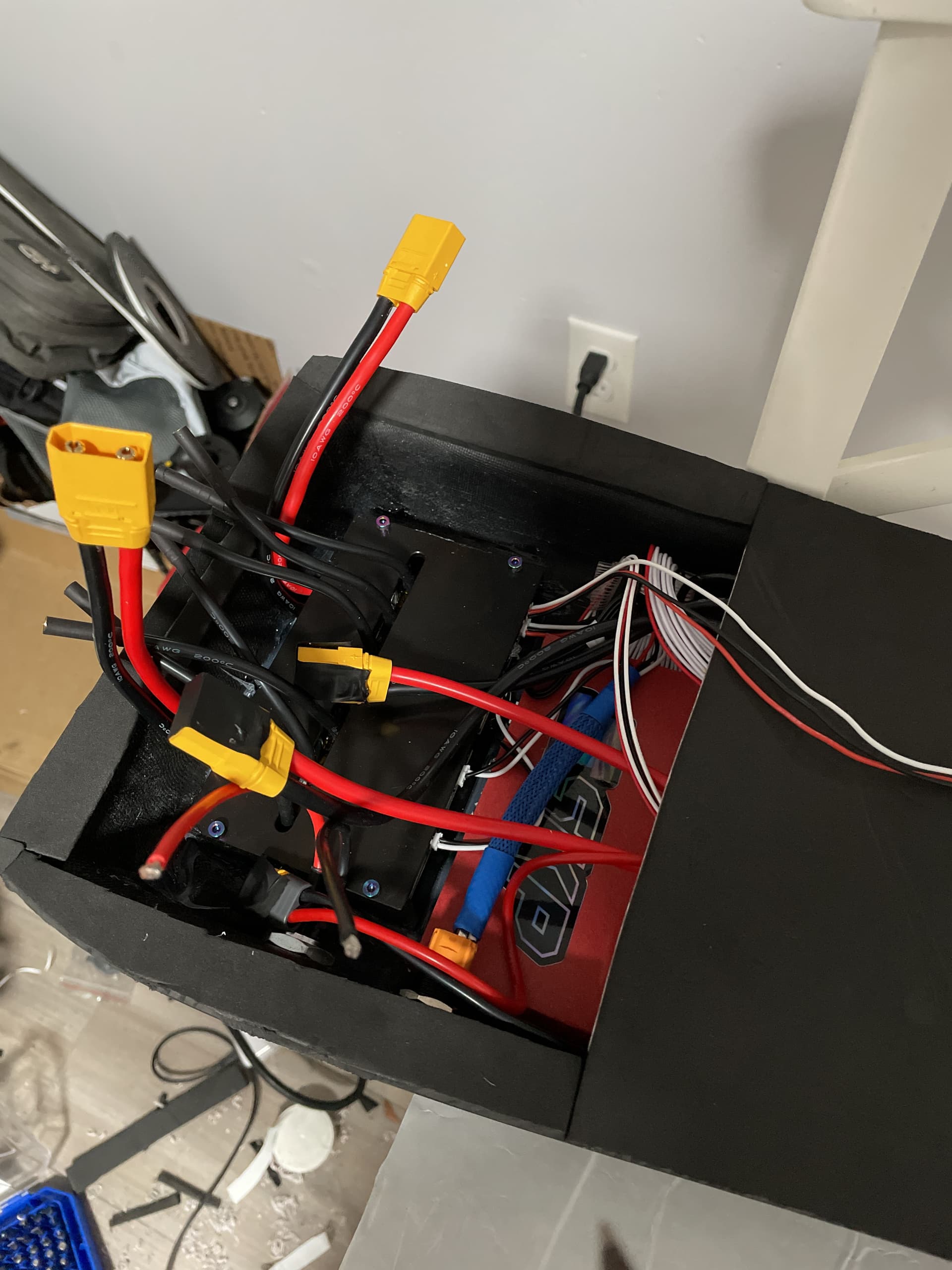

Update got new batteries Samsung 40t3 built up by @Skyart
Running solos as well

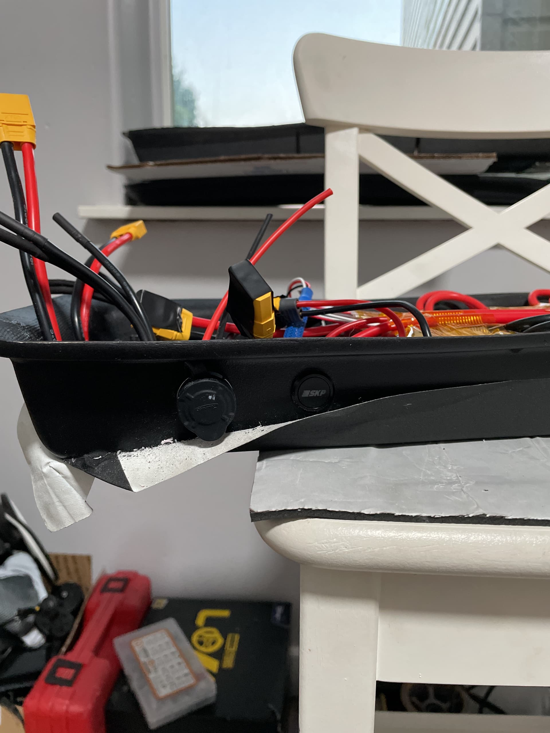

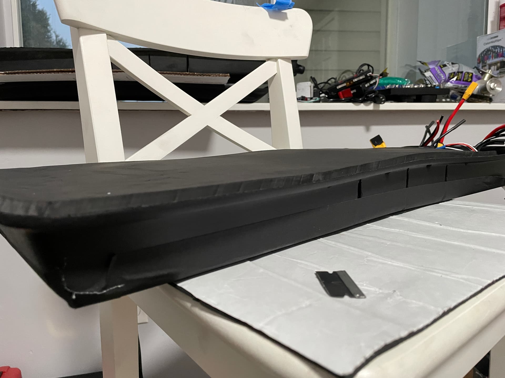

Last step before I do motors and detection is making sure it actually fits :joy:
Previous enclosure has some miles and age. New one but it looks like half my holes fit.
Update maybe tomorrow

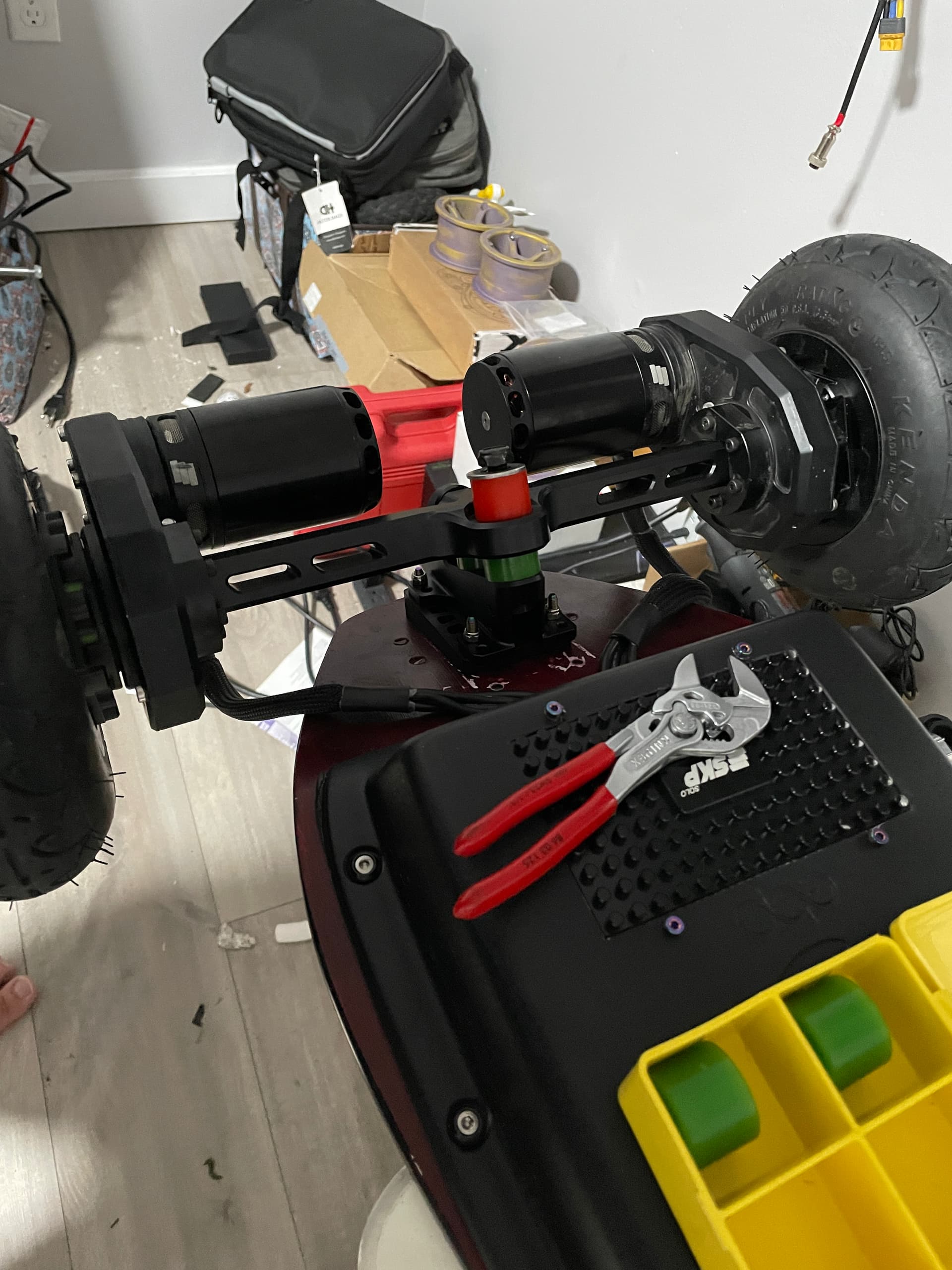

Interesting tool what’s that called?
