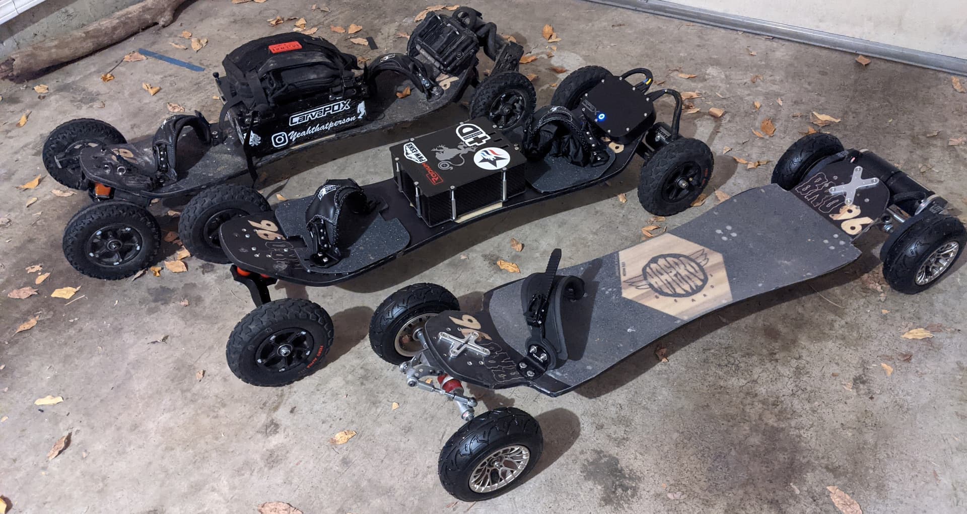

3-Link 18s5p Street Bro SS
That’s a nice one! I like how the motors fit the narrow truck in combination with those wide wheels.
Left my mountain bro
Center @bboybowzer apex bro
Right NKP street bro

Dude, I’ve been wondering, what’s the score with the 3-links on angled tips? They’re intended for flat mounts, right? Do you compensate for the angle by adjusting the truck geometry? If so, does that then limit the range of adjustability left available?

They work based off of the angles of the control arms compared to the ground. So with an angled deck there’s some things to be taken into account. For example, the front is tuned down with all the steer out in the rear is mounted in reverse of what it would be on a regular flat deck. With kind of the nose going forward and down. In the end, I still end up with good angles controlling the turning and extremely stable ride. There’s several people now that are riding mountain boards or lacroix or something similar with three links

Sorry, man. It doesn’t matter how many times I read this, I can’t figure out what you’re trying to tell me :joy:
Fuck bro. I don’t even know if I know what I’m saying!
The front truck is it adjusted to have the least amount of turn possible, which is actually still a lot.
The rear truck is mounted 180° opposite of a normal mount position for the truck, and the way the control arms are adjusted on it. Give almost zero turn in the rear
Hahaha! Gotcha, thanks.
