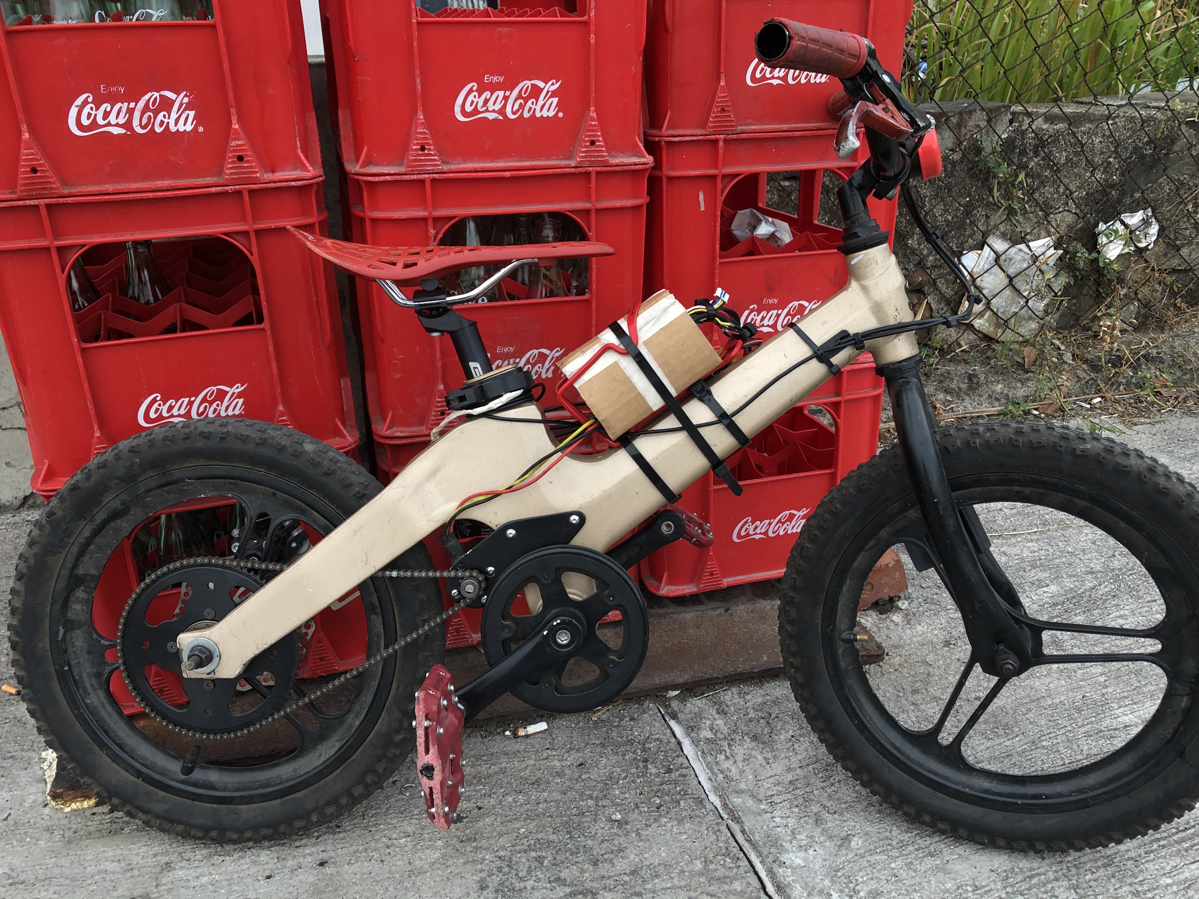

A few people asked me how mine worked. I have put in my 5year olds bike to test if it’s safe for me to use on a more powerful setup. :joy:
It works fine here but it’s only drawing like 30 amps at 15v.
Eventually one day it will get used more heavily I will report back.
That bike is sick! DIY much :hushed:
