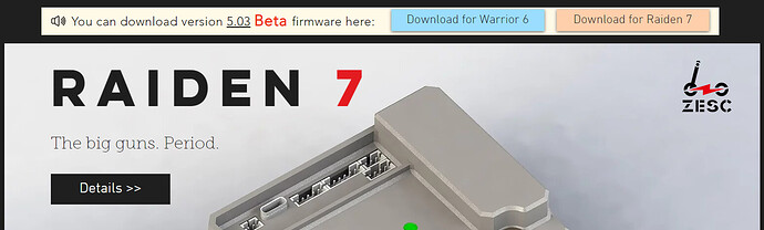

As you guys asked. Beta available! Take your own risk!
For everyone that hyped thinking he had them in stock, this is just custom [beta] firmware based in FW 5.03. Still no stock :sob:

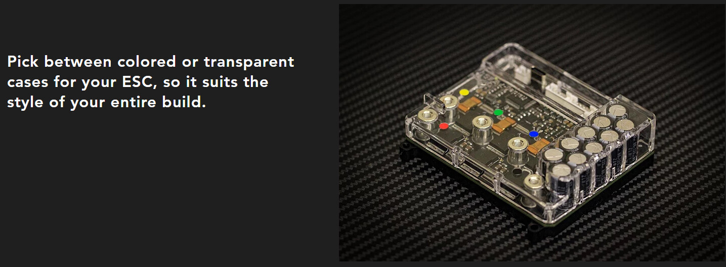

A transparent version is released, limited availability.
@PixelatedPolyeurthan
Ordered already, thanks bro
Oh man Im getting nintendo 64 transparent edition vibes from this, hope its still around when payday comes! beautiful!
