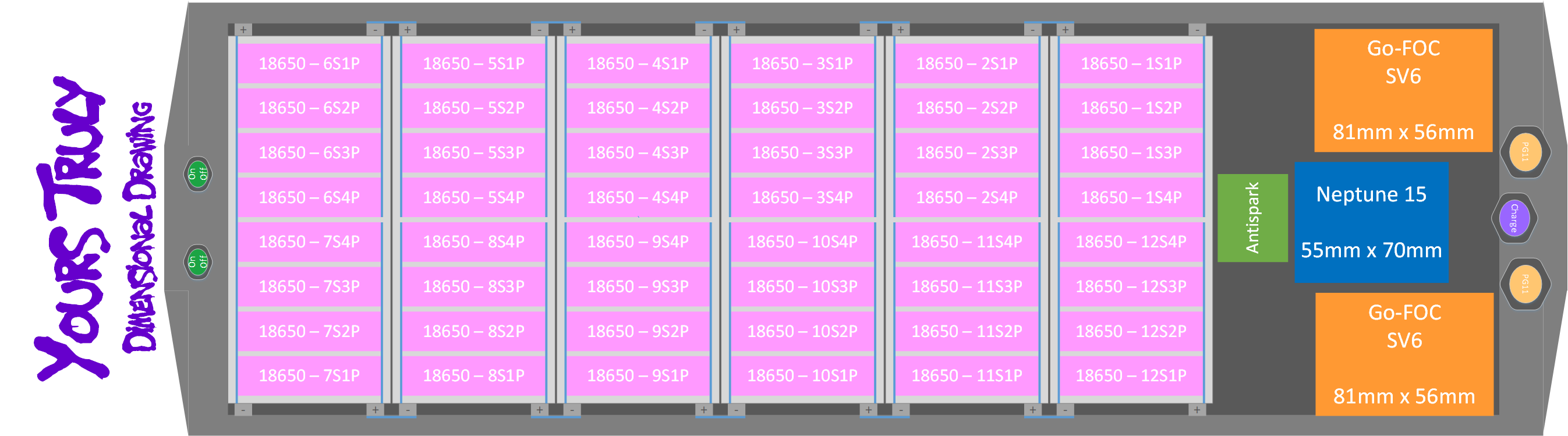

Smaller Cable Glands
Since deciding on the RJ-12 connector for the sensor wires, I was able to move from the PG13.5 to the smaller PG11 cable glands. This allowed for smaller holes in the enclosure (which is always nice) while still capturing the three phase wires and the sensor wires. This change required an update to the dimensional drawing:
