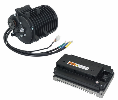

For the ESC, Motor, and pedal controls, we picked up a kit from Aliexpress that had a combination of the motor, speed controller, and a pedal.
Normally they come with a twisty hand control but we were able to message the seller and they switched it to a pedal for us, pretty great! I think that the go kart frame probably has mechanical brakes in it still too so the combination should work out well.

I wanted to split this up as an update post, so here we go. As of today, the motor kit has arrived and some of the batteries. Here are some pictures of the motor, pedal, and ESC.
It’s convenient that it all came from the same seller because that means we can just plug and play. Unfortunately, we can’t really see how powerful it is until we get it hooked up though.

This would of been a great motor and controller instead of the cheap one :sweat_smile:
