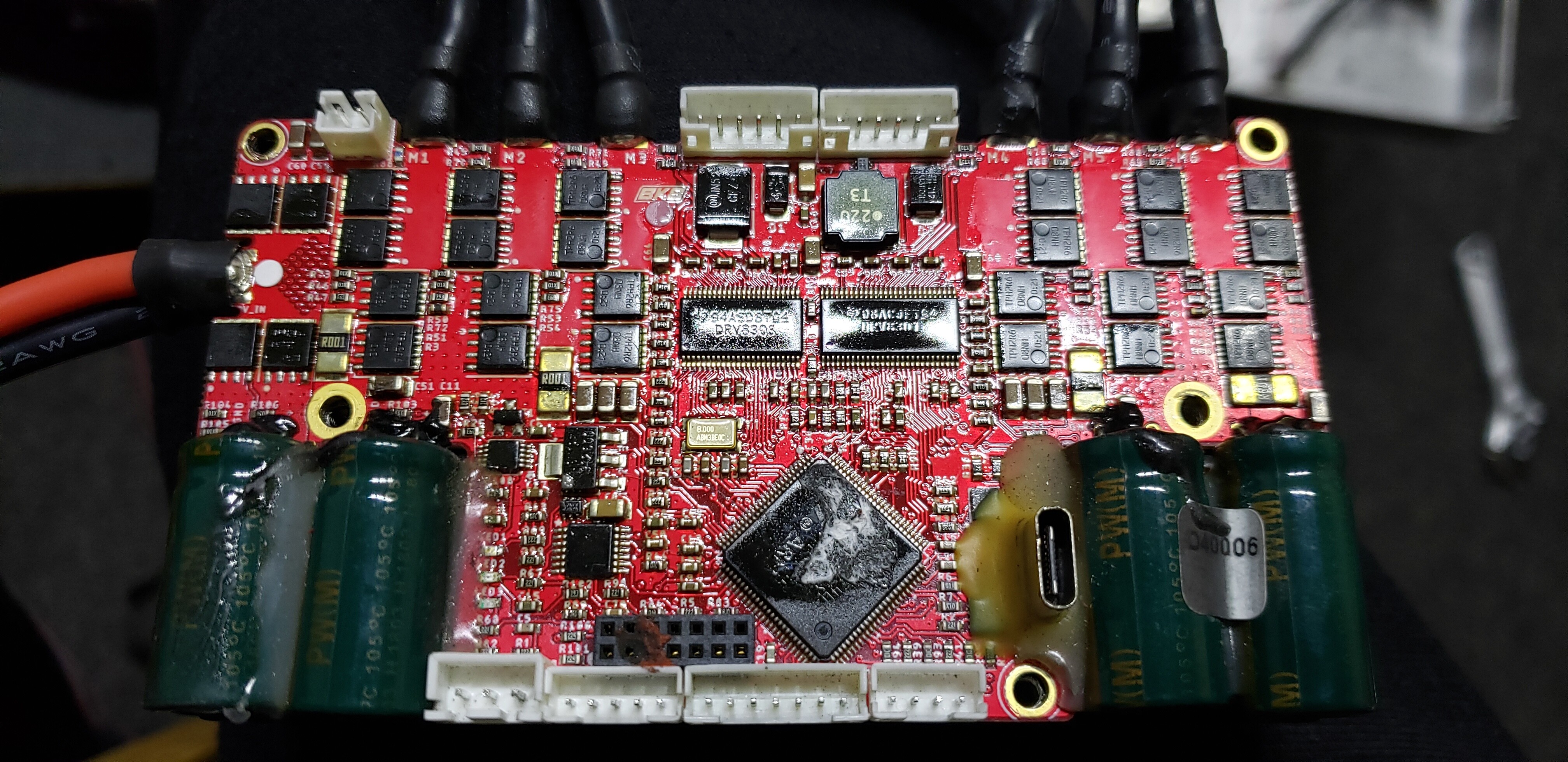

Hi,
So i went for a ride yesterday, hit some big bumps that were fairly close together, almost lost my footing but stayed on and my board shuts off. Quite disappointed my xenith died like this. So i opened it up, check all wirings, check voltage and battery and the power switch and port. They all seem fine so it narrows it down to the vesc and i have no idea what im dealing with. Can anyone with experience of unitys/xeniths suggest what might the problem be? Have a pic if it helps
Thanks!
Edit: im pretty sure its not my anti spark. The chip for it has no hole according to unity thread, switch is ok and when bridging mom pin, draws 0.3a at 12v if that means anything.
Does it turn on if you hold your finger on the button?
Wow that was fast. Nope.
Its fucked.

Explain?
There are a few people in the world that may possess the skills and materials to fix it.
Your location would help in recommending the right person to you.

You MAY have some luck talking to @Scepterr
Short of that you could try @JohnnyMeduse
U think theres any chance bkb does repairs. Ok thanks
I highly doubt it. They might offer you a replacement though.
Id consider if its a nice price but i doubt it. Especially when i got mine at 200 and now its 300.
Its highly likely that its not your fault it blew up. Its a known and common fault
Common on all unity?? I thought it was just a problem with the unitys from massive stator?
Its the same shit in a different colored jacket
