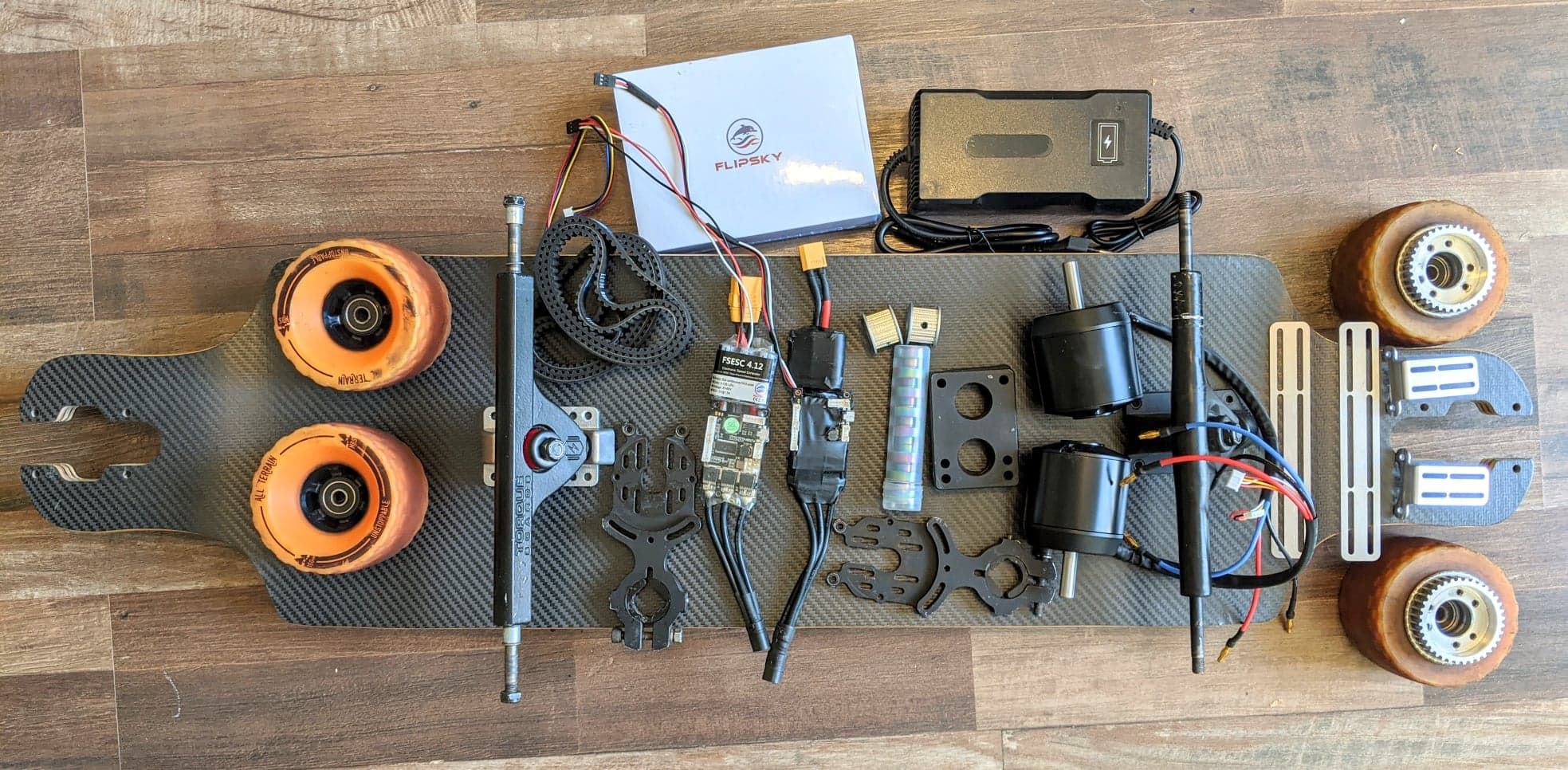

By the way… i have more or less found the following items up to the line, although i have not purchased any of them yet
Hummie + BB encl.
MakerX dual
Some random wheels + metal pulleys (+belts?)
10s3p Molicel battery with the most basic bms
Caliber II Trucks with Torqueboards mounts (Can get TB210s for 60e, without mounts and get Athrx’s free mounts)
Some random remote (mini? i still prefer arduino + 3d printed boosted remote case or sth like that)
And here is what i have not found deals on :
Charger
Motors
tools ( lol )
Bushings (don’t they come with the trucks?)
What else would i need to make a complete build, out of the parts above? I’d probably need a power button or something for the ESC, i dont know how that works exactly, i guess once i get the parts imma do some LEGO-level figuring out.

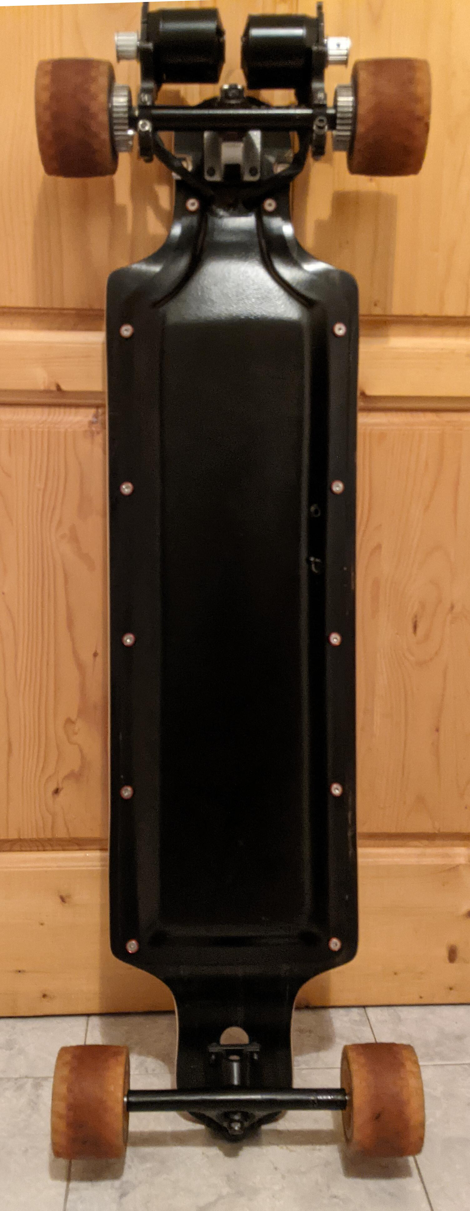

Ah, here is a short pre-post post of my build, as the build probably won’t happen until next year. I am leaving my board with my parents, as 1. it became kinda heavy to move with other luggage, 2. its literally sub 10 degrees here, i’d die out there with it, 3. it would appear that i have a faulty vx1, as the batch apparently has some issues and would need replacing. By the time it gets replaced it’d be well into winter anyway i guess, so…
But here is my build.
Deck - Hummie
Enclosure - BigBen Single stack, deck and enclosure from @Froodle
Battery - 10s3p Molicel p42a, Bestech d596 - courtesy of @tinp123
Wheels - 100mm All Terrain wheels with metal 36t wheel pulleys and bearings from @Athrx
Motor Mounts - Free from Athrx with the wheels.
Motors - c6374 Generic Chinese Motors
Motor Pulleys - Steel 15t
Trucks - Torqueboards 218 back, Generic paris clone front
ESCs - 2x Flipsky 4.12
Bluetooth Reciever for the ESC
Remote - Flispky VX1
Charger - 42v3a
Everything from the motors below + extras are from @Anubis
Extras - New Bearings, Lots of bolts and connectors, Risers, Velcro, Metal Motor Bash Guards
Now… all of this came at about 650 euro + shipping . Huge thank you to tinp for going into more detail as to how batteries/bms’es work, to Athrx for being there to answer some of my silly questions and especially to Anubis who not only helped me through the entire thing, but made sure that everything was compatible, i was informed about the items themselves, he threw in a couple extras as he knew I was on a budget, he received my deck+enclosure from Froodle and the wheels and mounts from Athrx and then packaged everything with great care and sent it over to me.
Thanks to everyone who reached out to me and help me get atleast different options, even though i might not have bought their items.
This board might probably be the budget king of this forum. Of course there are other things to consider such as buying loctite 243 which is hella expensive, silicone for the gap ( which i didn’t get to use yet ), heatshrinking tube, but these are relatively small costs.
All in all 10/10.

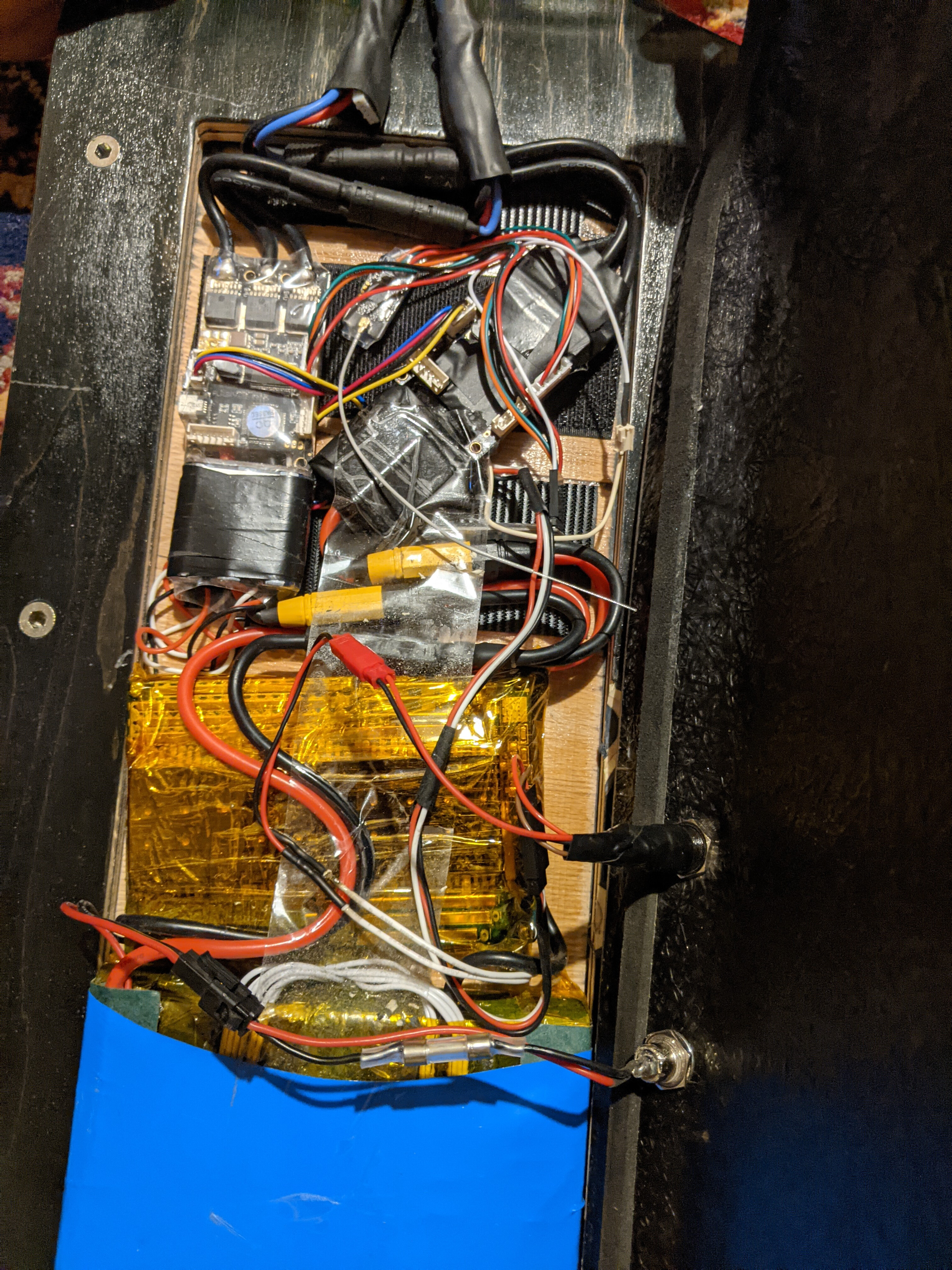

The build is not complete. I need to wait for a replacement remote and buy a mini-usb cable so that i can configure the vescs (i fucked up a setting and now i cant connect it to the tool with the bluetooth guy).I need to align the motor mounts and tighten everything and put some loctite and stuff. But its almost ready. Too bad it took me like 5 months of planning and shit and winter is here.

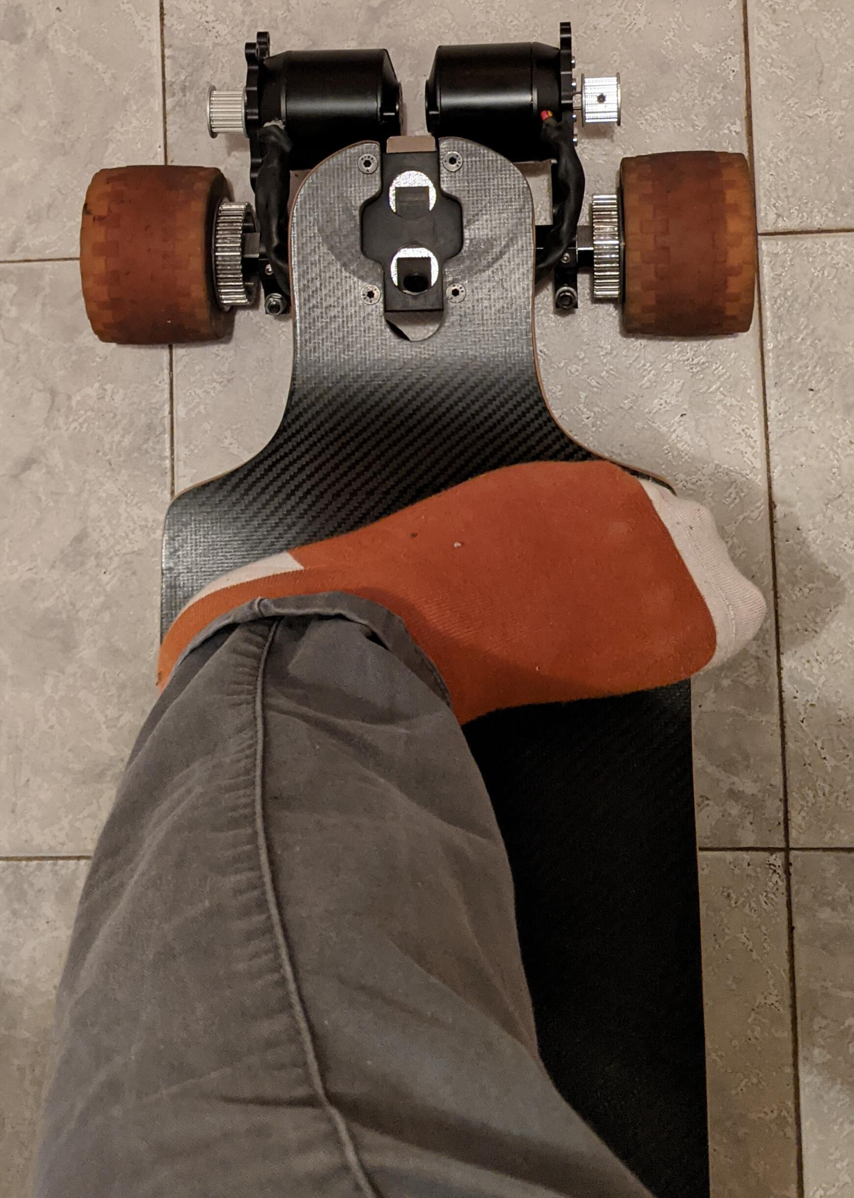

Anyways here are some simple pics :
If you can, cut grip tape so that it leaves out some of the carbon fiber layer, and make that damn wiring nice… you can fold the capacitors on those flipsky’s under them i’m pretty sure, keep main wires on the side, coil up and tape the button wires, put foam under and over the battery. You will see after a ride what starts to rub down and hopefully you adjust to that before you start a fire
