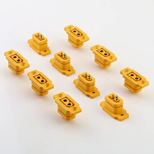

I got these, they are so tiny. Hard to solder to on the middle pin they are so close together.
Put a tiny piece of fishpaper bent in a U shape around it while you solder it.
Solder the middle first… you can also transfer heat from the backside of the terminal with the smallest drop of solder on the tip of your iron to bridge the gap for heat transfer. Thermal mass is small enough that you can then easily press a tinned wire into the open cup face & it will liquify

@Fosterqc yeah I can imagine 14awg would be pretty cramped on an xt30. I was thinking 16awg at the absolute largest. Anything larger than that and I’d solder middle first which would be a bigly ass joint, shrink wrap it, let the outer terminal joints flow over and hope for da bess
