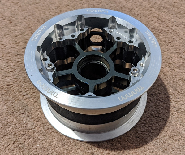

@ducktaperules I was looking at your design again and only now realized that we did the same thing :smile:, the credit is all yours, when I first looked I understood that the spacer would be the new bearing seat
@ducktaperules
Is this what I think it is?? One of the outer hubs is now seating in the middle (with the printed ring) and thats how you overcame with the bearing seat issue? Fucking awesome!!
This thing is genius!! :heart_eyes::metal::yum::smiley:

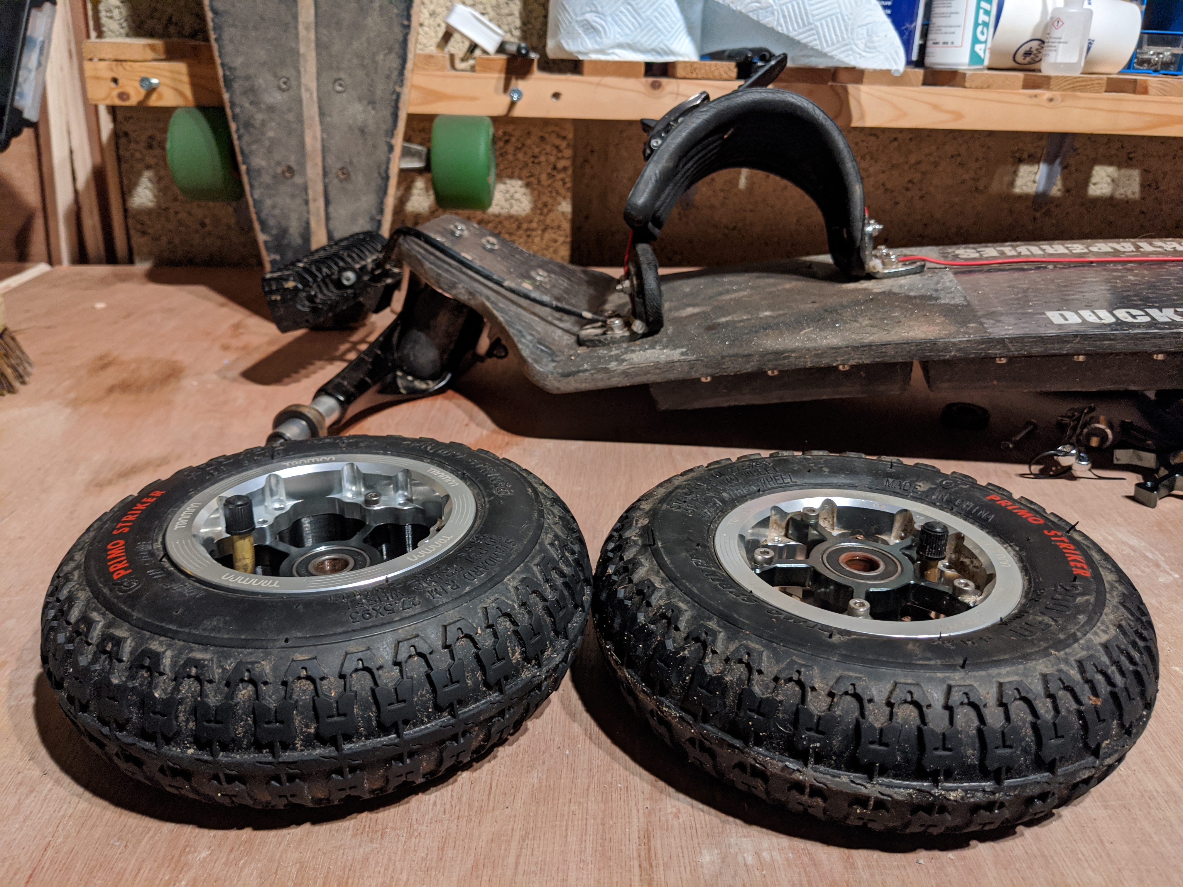

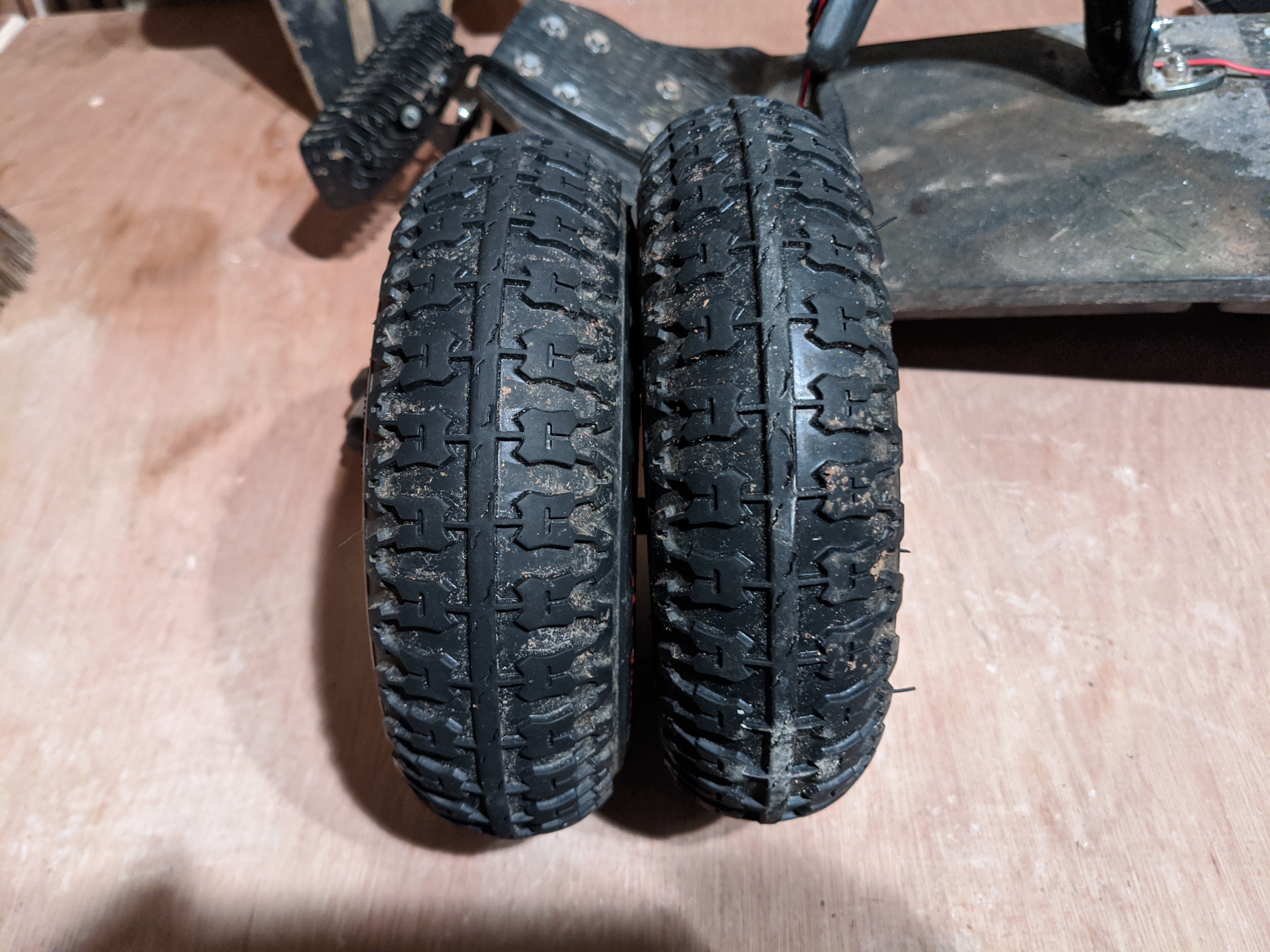

So side by side comparison:
So whilst the hub is much wider it seems that the overall tyre width does not increase to much. This means that the hub sits closer to the outer edge of the wheel.
Also the offset is considerable :slight_smile: I think this would add much width to the board overall.
Another thing i realised (which seem obvious now) is that increasing the width slightly reduces the diameter. Don’t have a way to measure but it is worth considering.
Overall it looks like whilst the tyre is not that much wider, a lot more of the tread will be in contact with the ground .

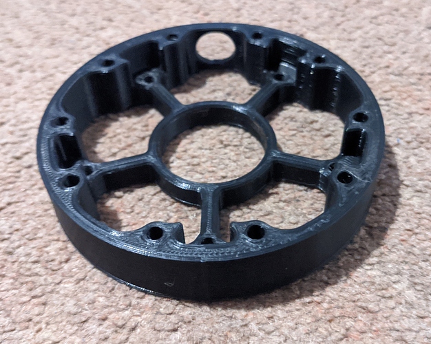

Yours do need the two little ears that the @Pedrodemio design has to cover the original valve hole halves though.
How do I get a set?! Do want!! Want now!!!
I can print for you out of PETG if that will work
The ‘ears’ would be hard to print on both sides as one side needs to sit flat on the print bed. Unless the each spacer was 2 parts… or the ears were printed seperately and glued on
With thin urethane like gummies on hubs like this, at high speeds it will expand and possibly fall off the rim.
So thicker wider urethane gummies work better IYO ?
I think it’s doable with supports, I design with them in mind,
