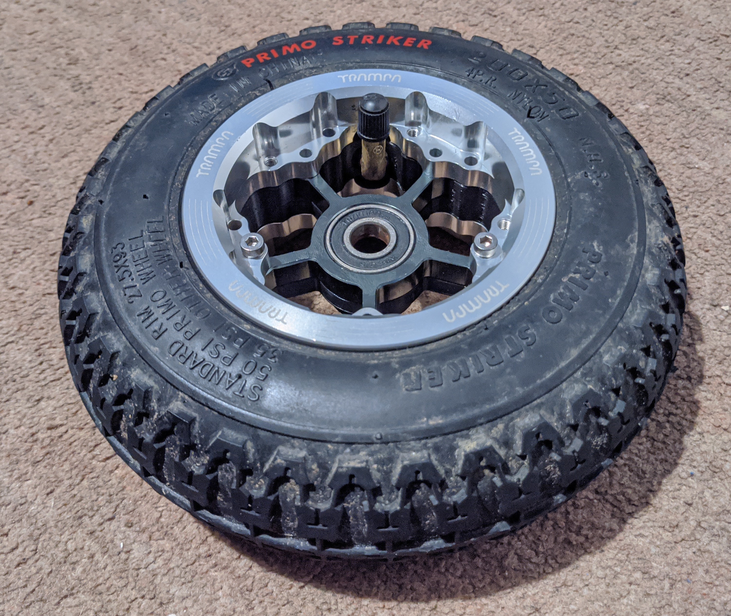

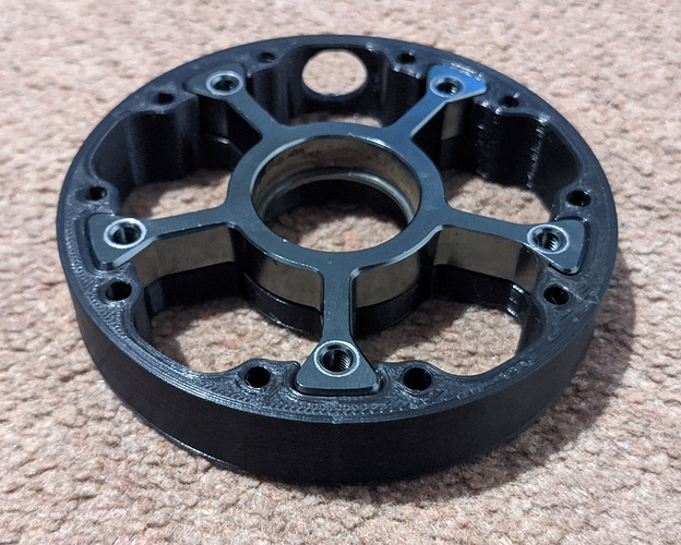

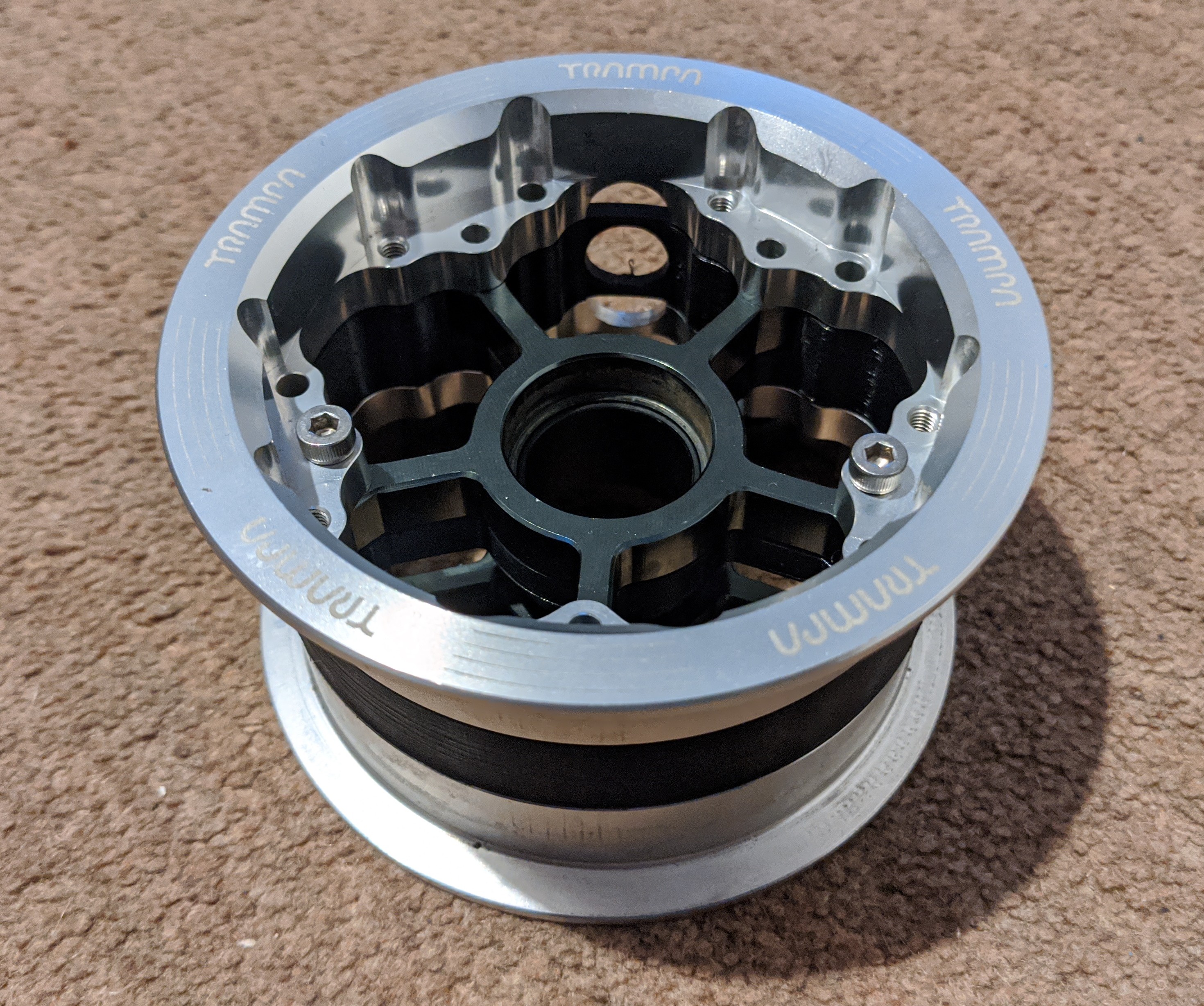

Here we go guys. Prototype time.
These spokes keep the plastic part strong. Then the metal spokes press fit in to support the weight of the wheel.
This then gets wrapped in the standard mega star hub parts.
Then finally the spacers go in and other set of spokes goes on the back.
Don’t forget the rubber

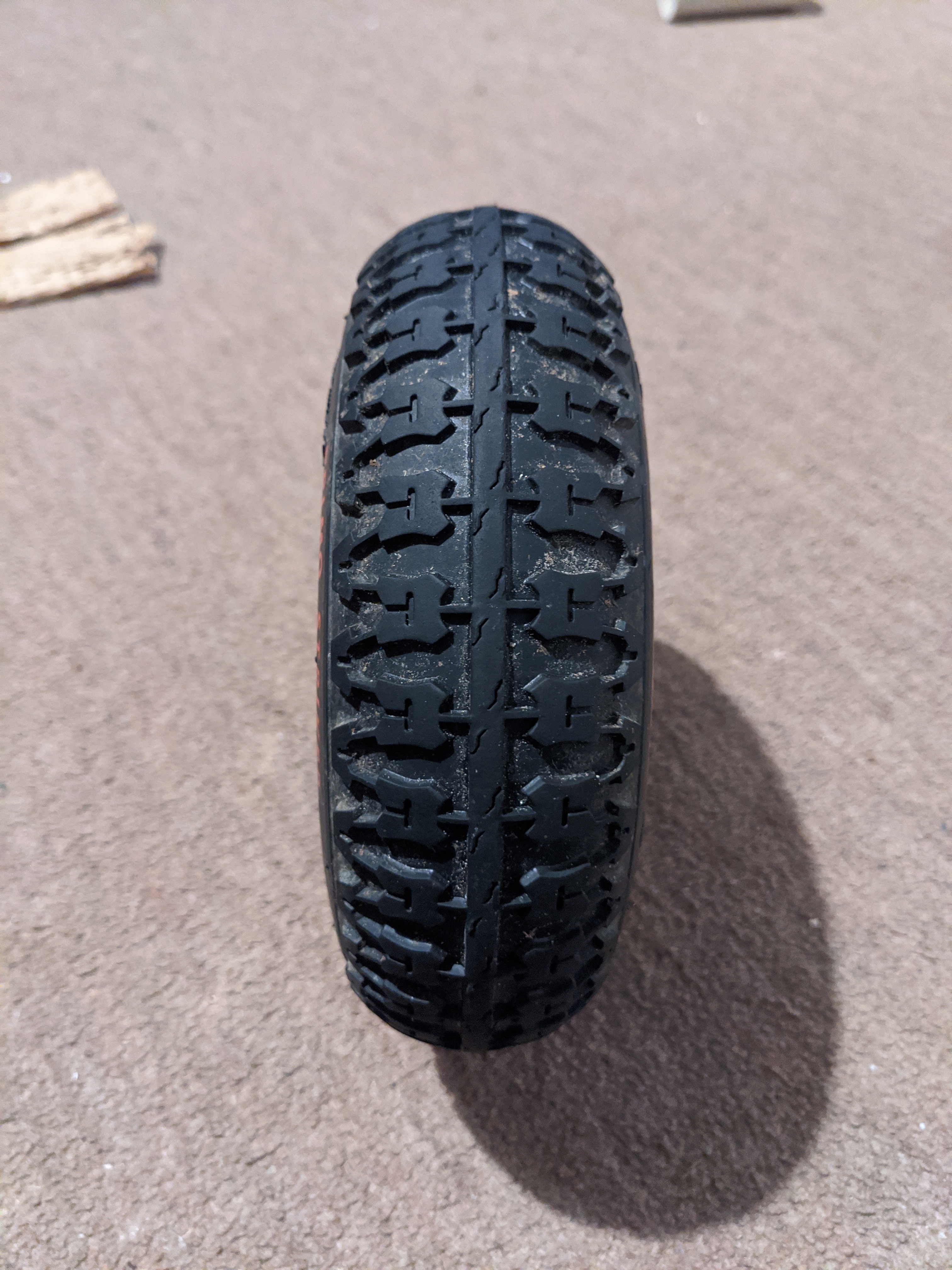

Got a bit of a chub on

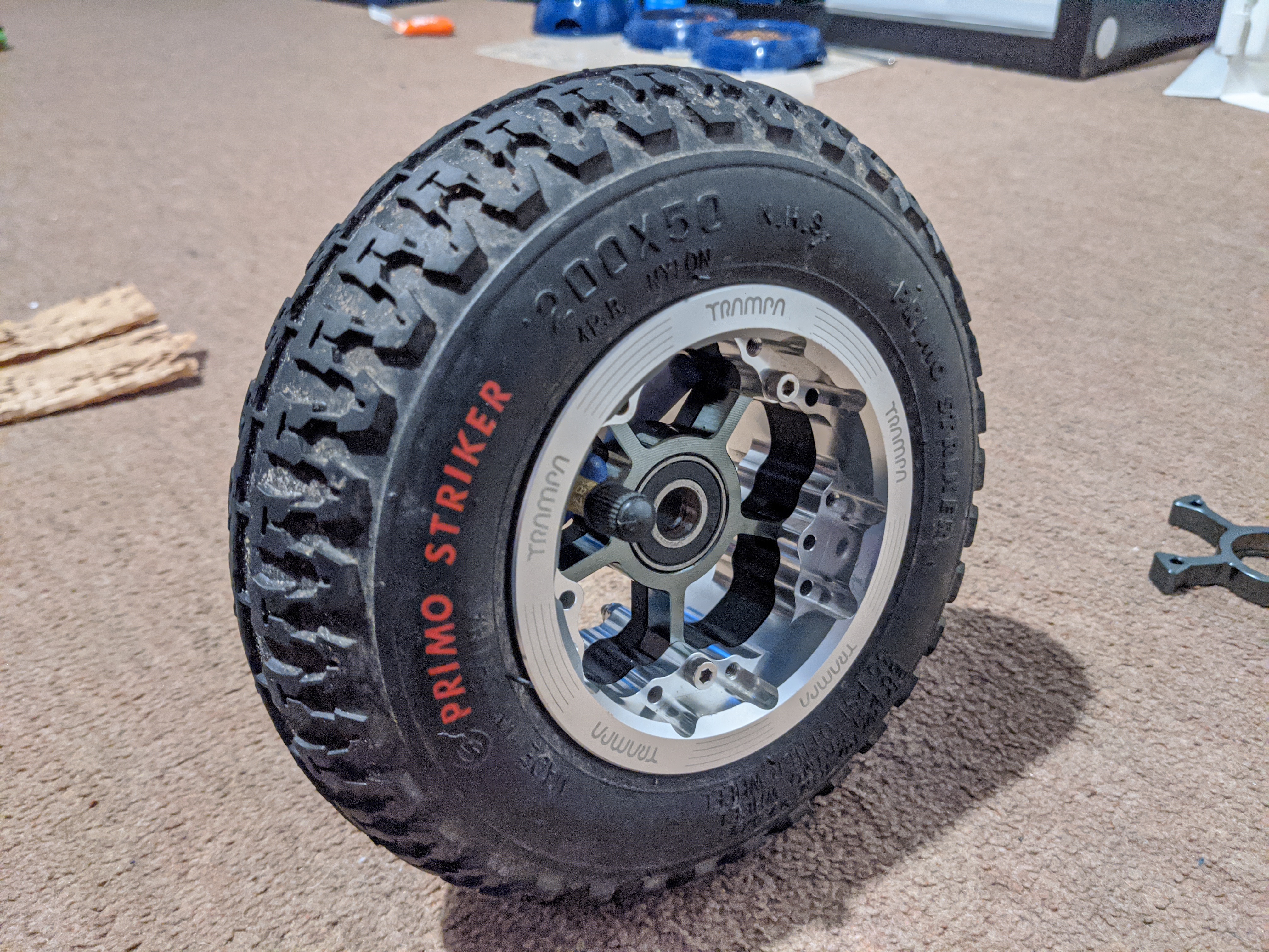

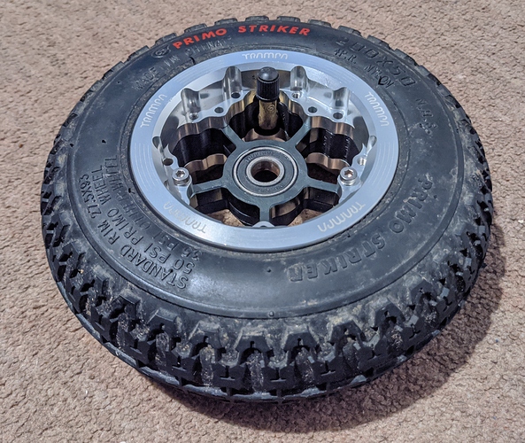

Tread looks much wider. Will go out to the garage and do a side by side in a bit.
How’s it look?
Made a lip to center the tire

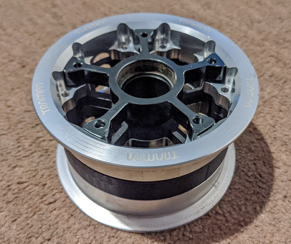

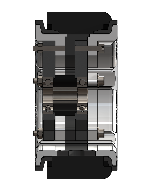

These spokes keep the plastic part strong. Then the metal spokes press fit in to .upport the weight of the wheel.
Wow!! This tread is flying a supersonic speed!! Custom adaptation is happening boys!!:metal::grinning:
