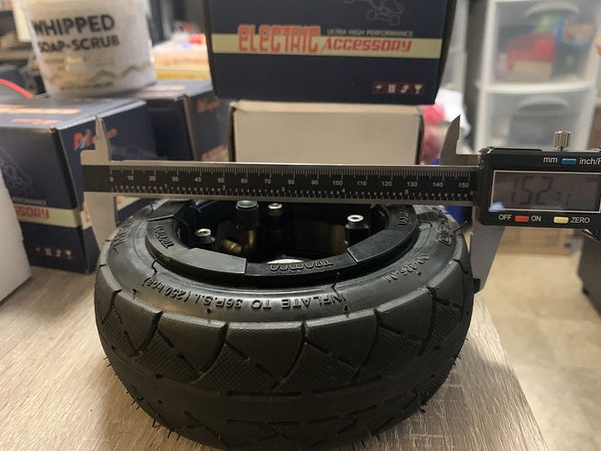

Here’s a shot comparing the 6" and 7" tires on the Janux 4.25" hubs:
These look sweet the 6 inch with 150x50
@kook for scienzesss
dats sweet as Faaaaaaaaaaaak brother!
Is this sunmate (TRAMPA) and printed spacer?
Uhh sorta kinda it’s kinda a mixed bag. Half is a 3ds 3.75” hub then the spacer and then the superstar hub.
Wanted to make the wheels wider on the 3ds drives. So had to Kinda n match.
Most credit must go to @kook cuz uhh he helped scienze it.
Sweet. What’s the hub width of that? Tyre shape looks pretty good with the tread pattern.
(Sunmate hubs with 150x50 tyres inbound and friends 3D printer waiting…)
Total hub width is approx 60ish mm. About a 19mm difference with the spacer in there.
