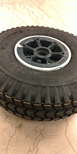

They are here, still some tweaking to be done but they work

For science!:
TB AT 160 x 50 pumped to 10psi… NO HUB… (I got askeered to go higher) 50mm wide 145mm dia. (Right)
Stock TB mounted on Kaly hub left pumped to 50psi. 50mm wide x 160mm dia.
Hold my beer…
I can get this wide on a stock kaly channel truck without even fukking with dish etc…
I’m designing a spacer to be a bit less… Bead to bead dimension at about 60mm
Presently the hubs are 35mm… So a 25mm spacer…
