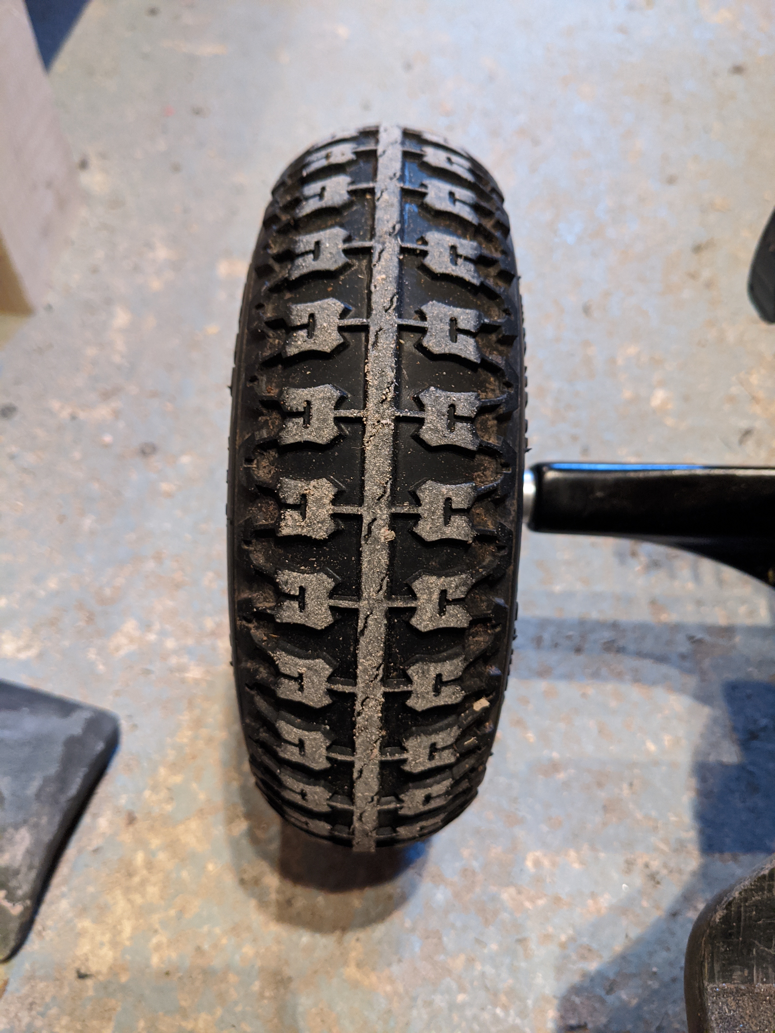

I got the MegaDeep mounted to my front 2 wheels so that I can put some miles on them.
They do look slightly wider but not by as much as I was expecting.
The tyre center has gone from 350mm to 367mm so 17mm wider. The outer edges from around 410mm to 430mm so about 20mm wider.
Just taken them out for a first ride and they feel ok. Had them at around 30psi. Did some small hops and dropped off some pavements but they seem to be holding up so far.
It’s hard to tell if there is much difference in grip when it’s cold and wet outside but when I got home and rolled into the garage I noticed something interesting.
The wet tyres picked up the fine wood dust wherever they touched the floor. This provided me with an accurate measure of the contact patch.
What I found is that the width of the contact patch is about the same front and back.
It’s got me thinking . . . Does widening the hub actually make the contact patch wider on curved profile tyres?
Negligibly. The biggest thing you will notice is changes in sidewall characteristics, and how different levels of inflation effect grip mechanics.
What we really need is ~70mm+ wide tires to put on these.
care to elaborate?
Namely their height (which you noticed) and their willingness to flex. Depending on how the tire is made, being above or below square to the rim will increase or decrease sidewall flex.

The 9" deep dish can take the 8" tire and increases contact patch. Contact patch and grip is mostly determined by inflation pressure. What makes more difference than widening hubs is the tire design. That’s why we designed the new 9" Mud Pluggers.
Yeah this is the conclusion that I have been coming to after doing some testing. You can get the wide contact patch Benifits by just dropping the pressure by a few psi so unless you just want it for the look I don’t think wide hubs are worth it just for the performance gains.
