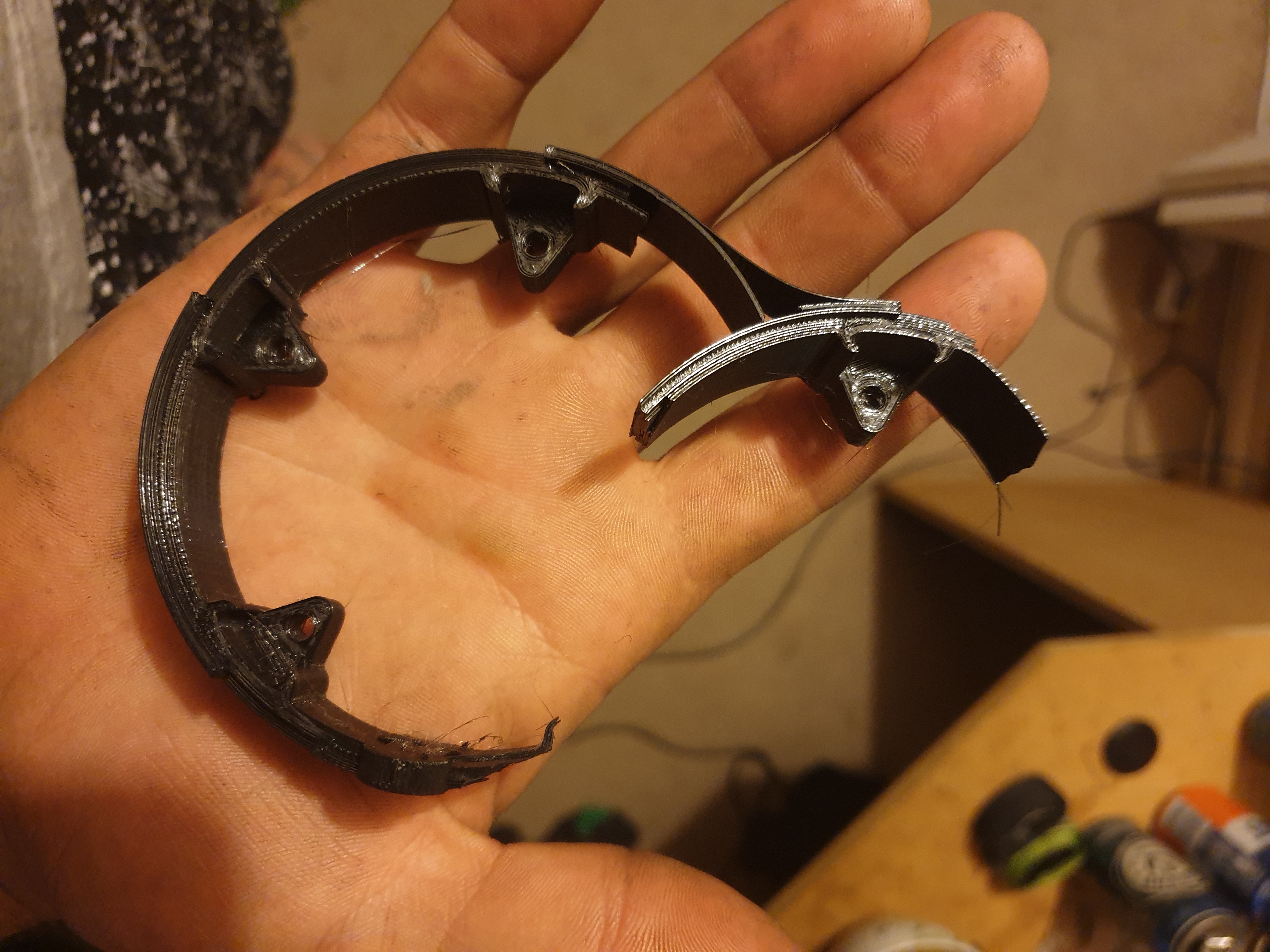

Hmm. Didn’t pass a pretty light squeeze test. Might have to tinker with my settings later
What type of filament/plastic, and what infill settings are you using?
That was petg 100%
The petg has been printing perfectly and strong on the evolve risers that ive been doing… i wonder if decreasing the infill will make it stronger :thinking:
I wonder if adding spokes before testing would be the way to go? Most rims without spokes do badly at compression tests.
Remember these are predominantly there to structurally widen the hub and provide a placement guide for the spokes.
It might, especially when using honeycomb infill.
I’ll be printing structural parts in the new year predominantly from Taulman Alloy 910 nylon filament though.
Jeez, that failed spectacularly for petg 100%. Did it take much force?
I think a carbonfil filament would be perfect for this application
Not much force at all.
I have a feeling my bed height could be a tiny bit low, affecting layer adhesion. Will have a tinker tonight.
Increase the temp and increase perimeters.
I would print one of those temp towers and see what is the highest temp you can print with that will still look acceptable.
Good plan, will change to new filament tonight and try that
I will print here latter this week to test
But keep in mind that by itself it may not be strong, when it’s between the rims and with a even compression from the tube it will have way more integrity
Yeah that was my thoughts too. Will see how I go with different settings :+1:
