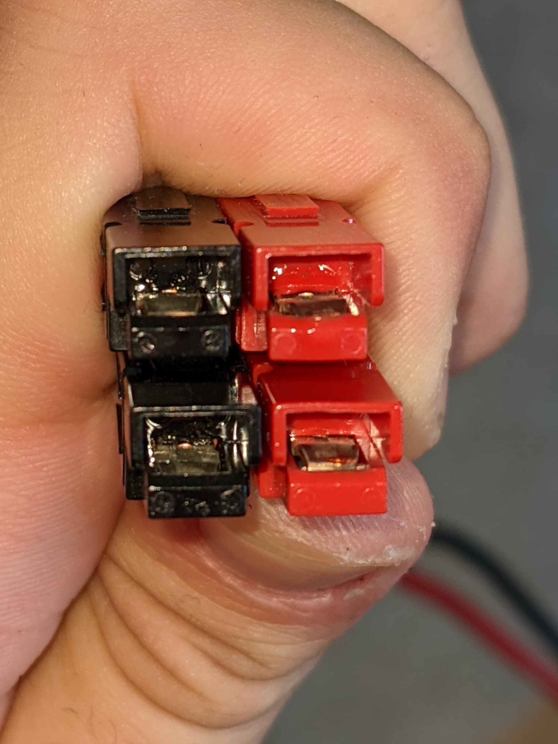

sooooo these connectors are crap. They melted on me after 10 minutes of 30A charging. Don’t ever use them, please.
It’s not that visible, but you can kinda see it on the bottom left ant top right connector. After getting super hot, the plastic housing melted and the contact sunk into the casing. Thus, no electrical connection.
It seems these connectors aren’t made from heat-resistant plastic like the amass XT connectors we are used to.

yeah, that 6p 30q pack sure didn’t like it xD
but I had practically no time for charging and wanted a quick ride before sundown with my buddy who was already on the way.

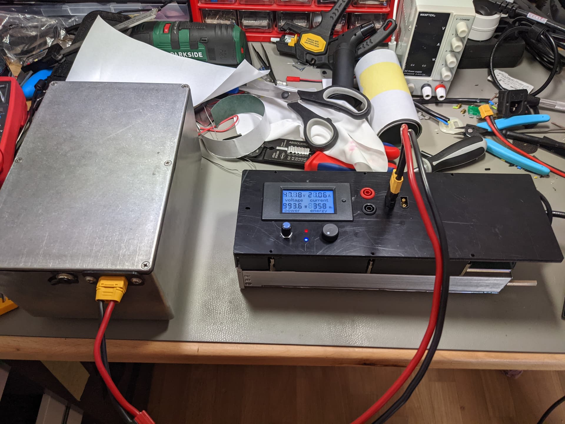

this is the setup (messy testing phase of the psu)

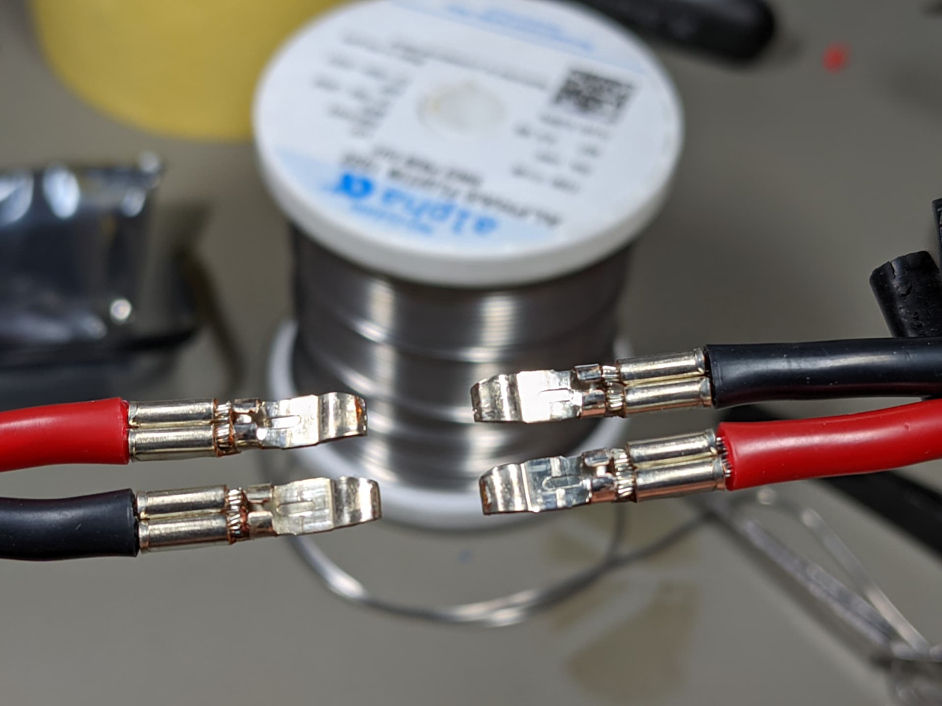

Check the quality of the crimp
While a good crimp is better than a good solder joint, a bad crimp is significantly worse than a bad solder joint. The reason why they need a ratcheting crimp tool is because too little force and the wire doesn’t actually crimp, too much force, the casing and the wire will shatter. The ratcheting action makes applying the correct amount of force much easier.

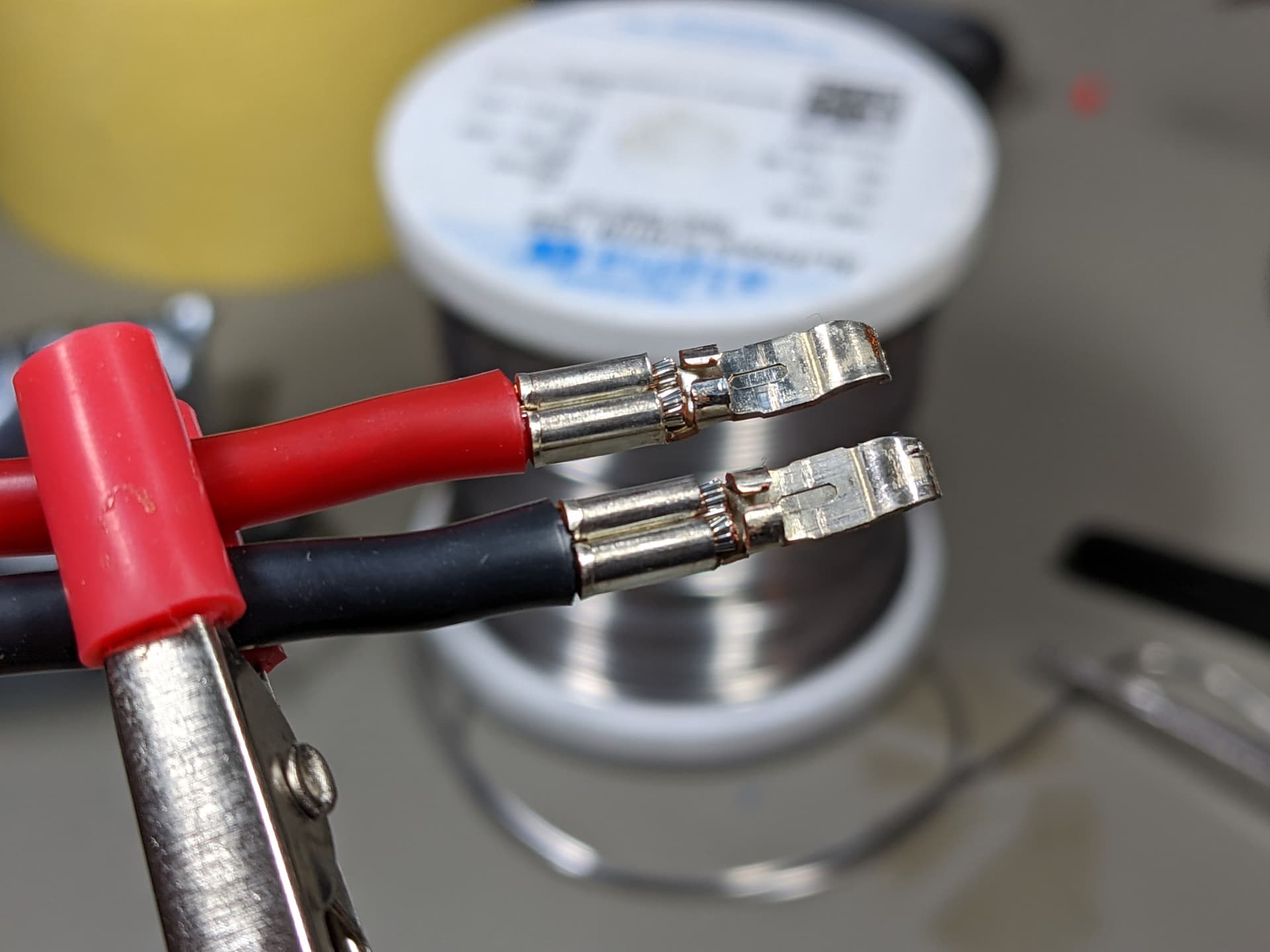

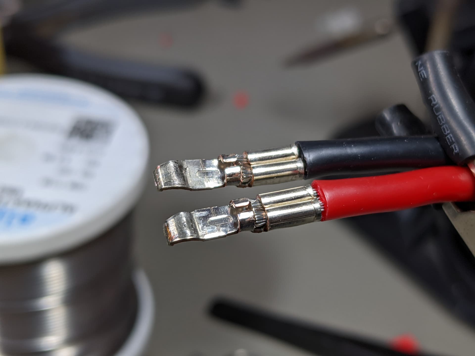

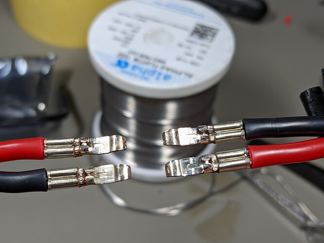

Doesn’t look too bad I’d say
What does the backside of the crimp look like? That’s the important part for split terminals like this.
Someone else I talk to who uses PP45s up their rated limited also mentioned that if the terminal is not properly seated it can also get excessively hot since the mating force on the PP45s is relatively low. If you are using highly flexible stranded wire, you have to jam the terminal into the housing pretty hard with a screwdriver. There’s a distinctive click when it gets in far enough.
So then yes, then we shouldn’t use PP45s by virtue of the higher chance of incorrect assembly from third parties
