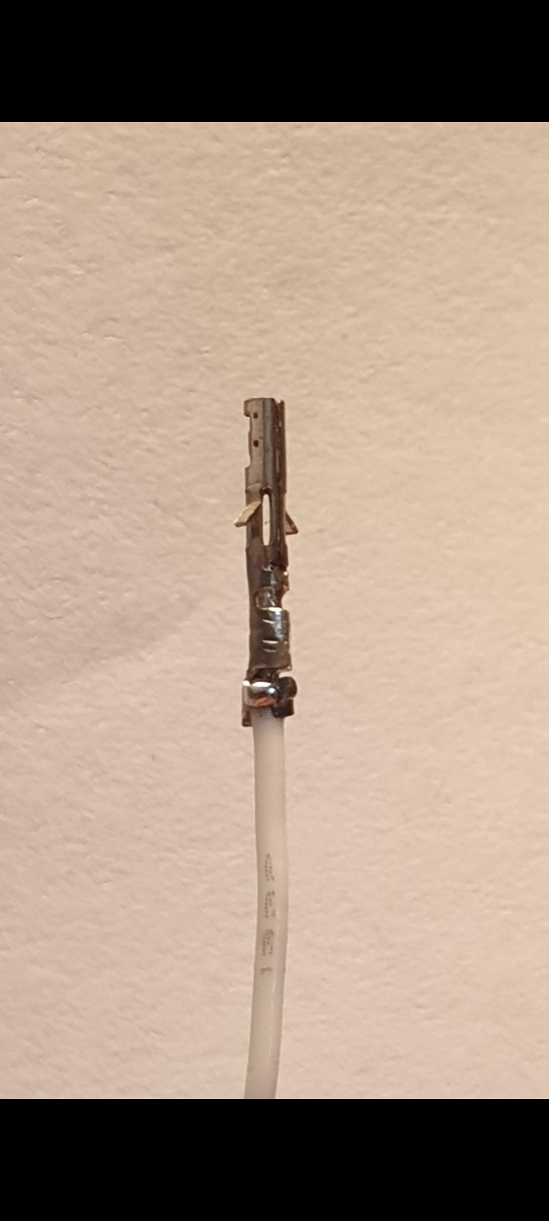

yall are all arguing over solder or crimp… yet you’re all sleeping on crimp, then heat and fill with solder. I would say that’d be indestructible :joy:
this was for my DieBieMS… she feels indestructible :joy:
I’m sorry, How are these better than Bullets? - They dont have less CR than Bullets at a wonderful 0.025 4mm or 0.02 on the 6mm
Also heat conduction and loss with be no way better on these they may however be lighter
If you have the perfect wire diameter and the perfect crimp tool then crimping is better. It’s just that this is never the case for most hobbyists.
Depending on the application I use so many different wires with xt30-60-90s that wouldn’t all work with a crimp connection.
If you are a company and plan everything in advance crimping is good but it’s not flexible enough for me.
This is actually probably worse than either just a good crimp or a clean solder joint. The second you add solder you’re reintroducing that potential failure point, as your solder wicks up the strands and makes it more brittle.
At the same time, it looks like you no longer have room for heat shrink, so you can’t mitigate that risk by preventing excess vibration.
If you had a good crimp from the start, the connection was already as good or better than a soldered joint. You only added a weakness by soldering.
yeah interesting. With tiny cable not conducting very much current i just have major trust issues with crimps but that’s just a personal thing.
For monstrous applications, definitely crimping is the answer, for small shit, i prefer to solder. each to their own! :blush:
Same!
It all goes back to having the exact right crimper for the job. If you don’t have that, crimps are less reliable.
