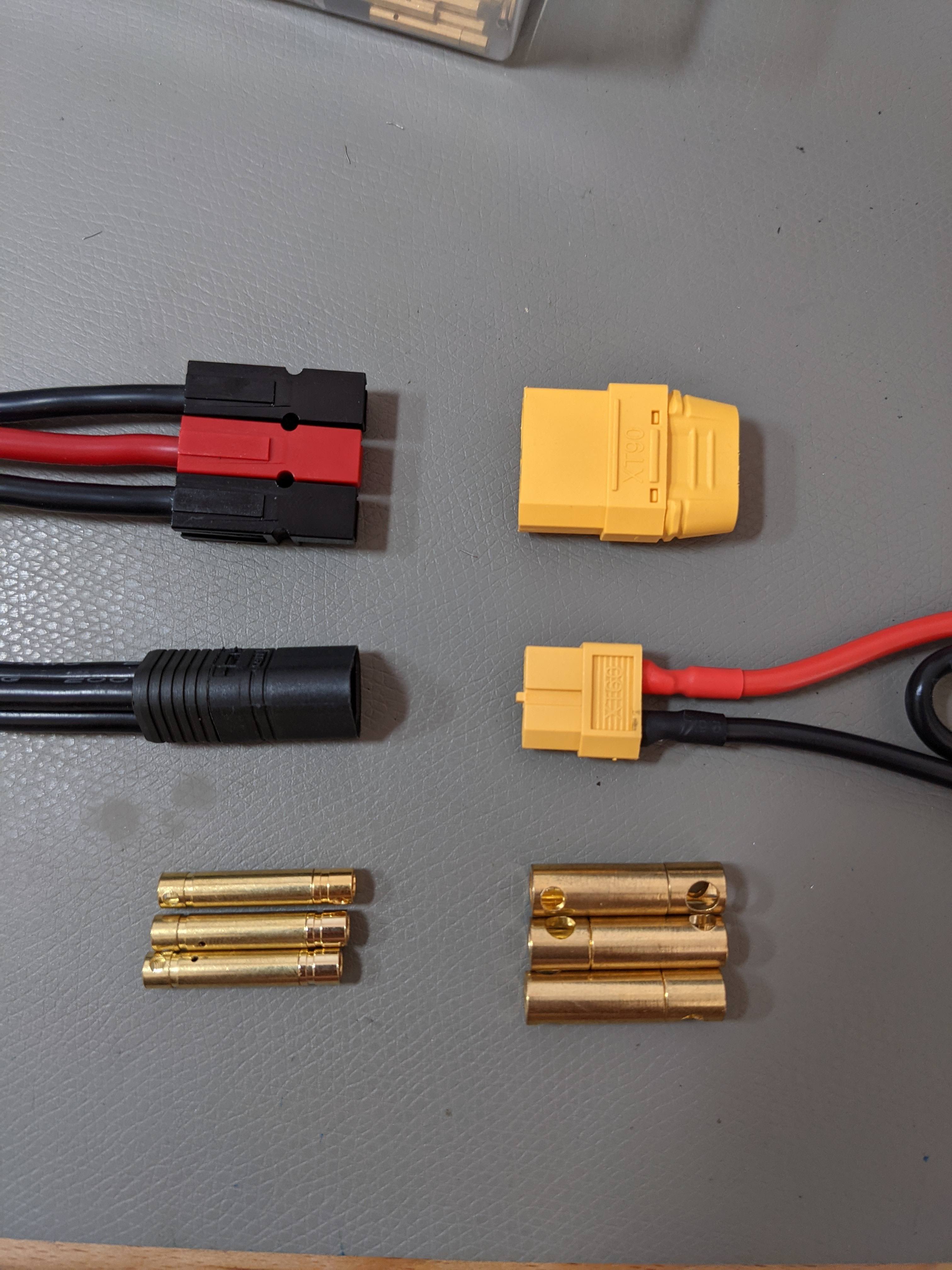

I thought the question was about why not use PP as motor connectors instead of bullets?
Either way yea for cables connectors (battery and motors) it could be interesting as long as it as enough amps ability I guess
I’ve used power poles before (we used them in FRC) and I hate them, so chunky for no reason at all. Bullets route so much better, only thing I liked was the lock inserts

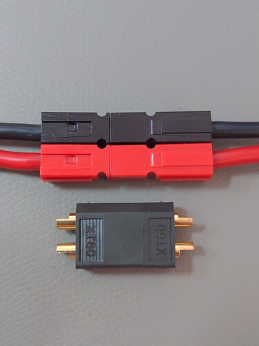

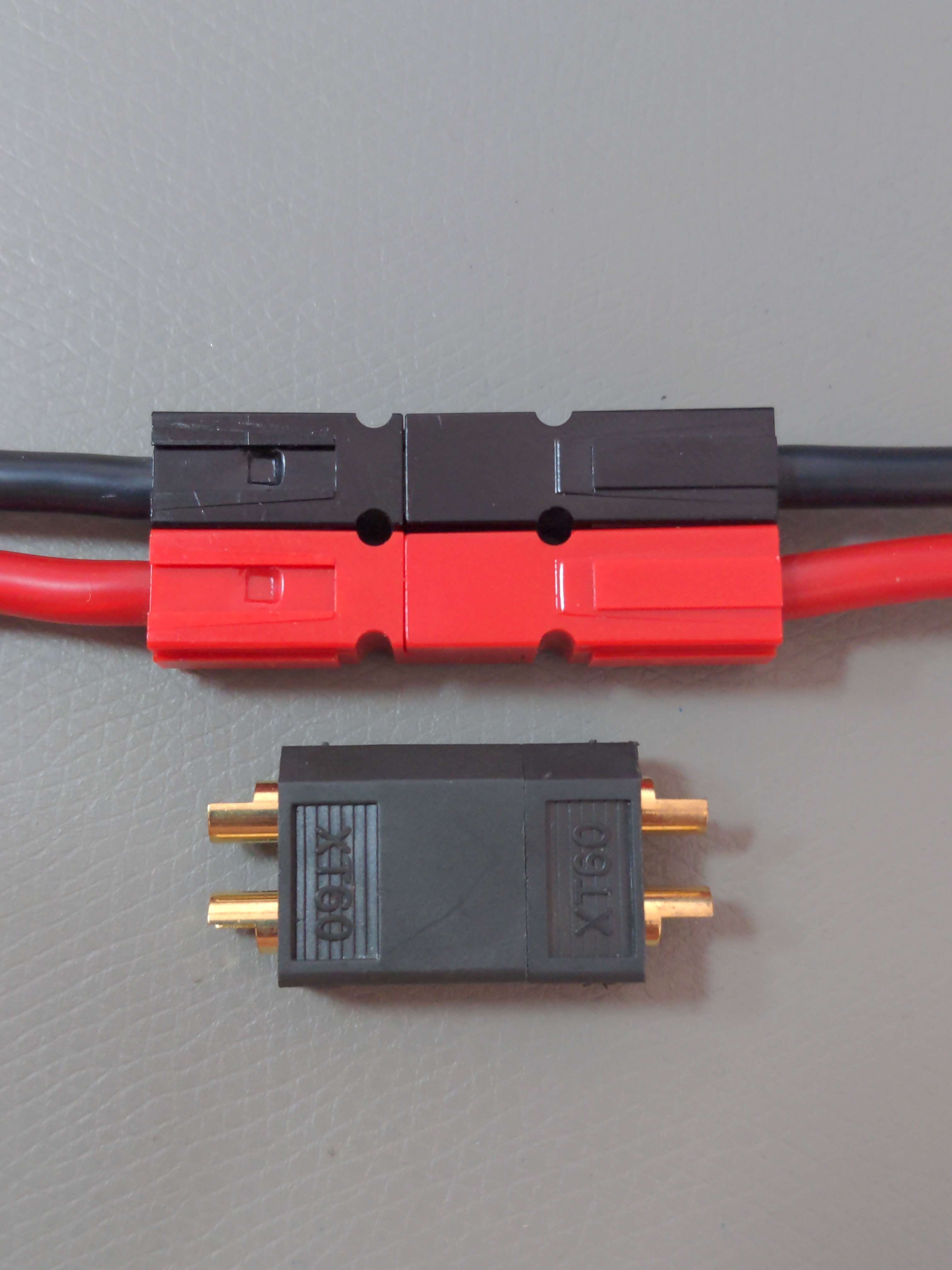

Here is your comparison guys :slight_smile:
And this is it against xt60
