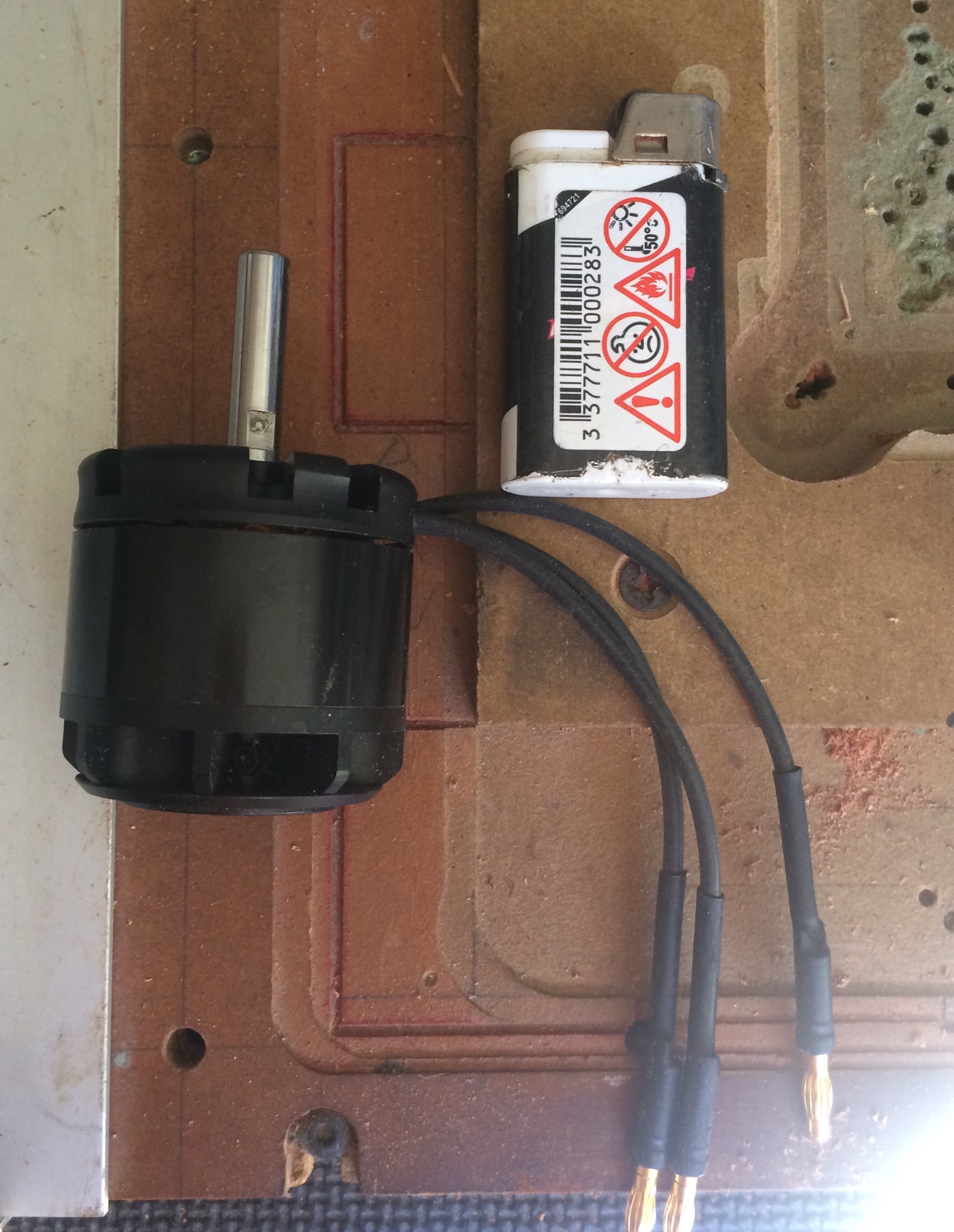

Totally unrelated but do your remember selling those on ES? Have you used them, I left them in a drawer for all this time and just saw it now.

Omg I forgot you were part of the group buy!! We had the Kv for everyone but I got my shafts shortened and inverted haha
50mm 85kv motors from E-Max right there :ok_hand:t4::fire:
Not yet, I disassembled mines to add some structure for DD/Hub use in my inlines + do experiment with them (rewinding with 18awg wire, extra magnets, big ass bearings) and these are still waiting for reassembly. I tested them before dismantling tho and they were spinning smooth on VESC Tool. QC is good and inner bearings tolerance is tight. For bulletproof you might want to seal the magnets in extra epoxy before use, so you’re sure they never move.
Also my lazy ass bought two Landwheel L3X hubs from @BearBoi so I can just focus on outer structure and not mod these ones, quick design for integration in my 110mm wheels.
You have a plan for them? They’ll do great on higher voltage for instance :grin:
