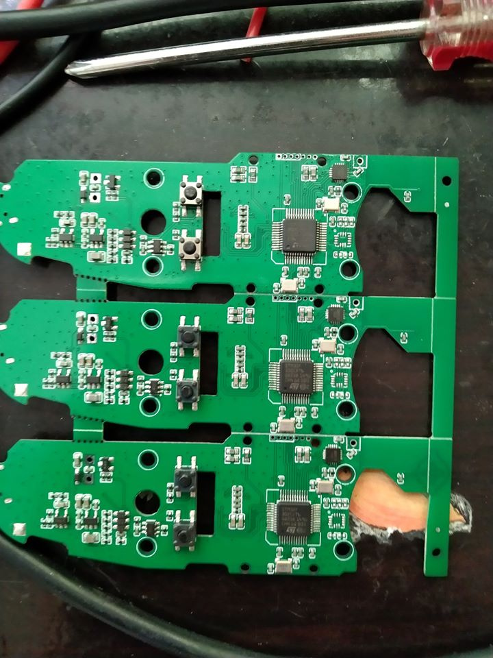

remote pcb (from their fb page)

Ahaha, but I can see why. Your I insta is pretty cool. For sure their products are real. To many details match up between remote and vesc. The problem is to understand if it will work and for how long.
The possibility to turn on/off Canbus connection is great. That will allow to switch between single or dual motors config.
