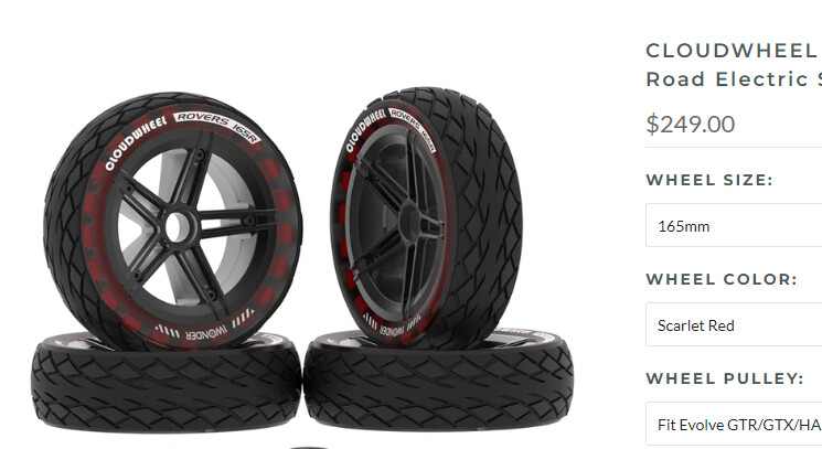

That was the picture I took at the lame Electrify Expo event last year (they’re better put together now), there was no one to talk to at the booth and no description on the wheel itself. vaporware
This but full thanes?
Brian brings up a very good point. larger diameters like 130mm would be pretty cool but finding/making pulleys would be a pain in the ass. With a 120mm wheel, most builds can get away with a 44-45t pulley. Once you get to sizes exceeding 120mm, it may be better to use a small AT rim (Hoyt, Berg) with a urethane sleeve. Not a thin one like the Trampa but a thicker one with shock absorbing holes or something like that.
Not quite. The wheels are 165mm in diameter with about a 40mm contact patch. If they were around 130mm diameter and 80mm wide (contact patch around 65mm) then you would have something.
