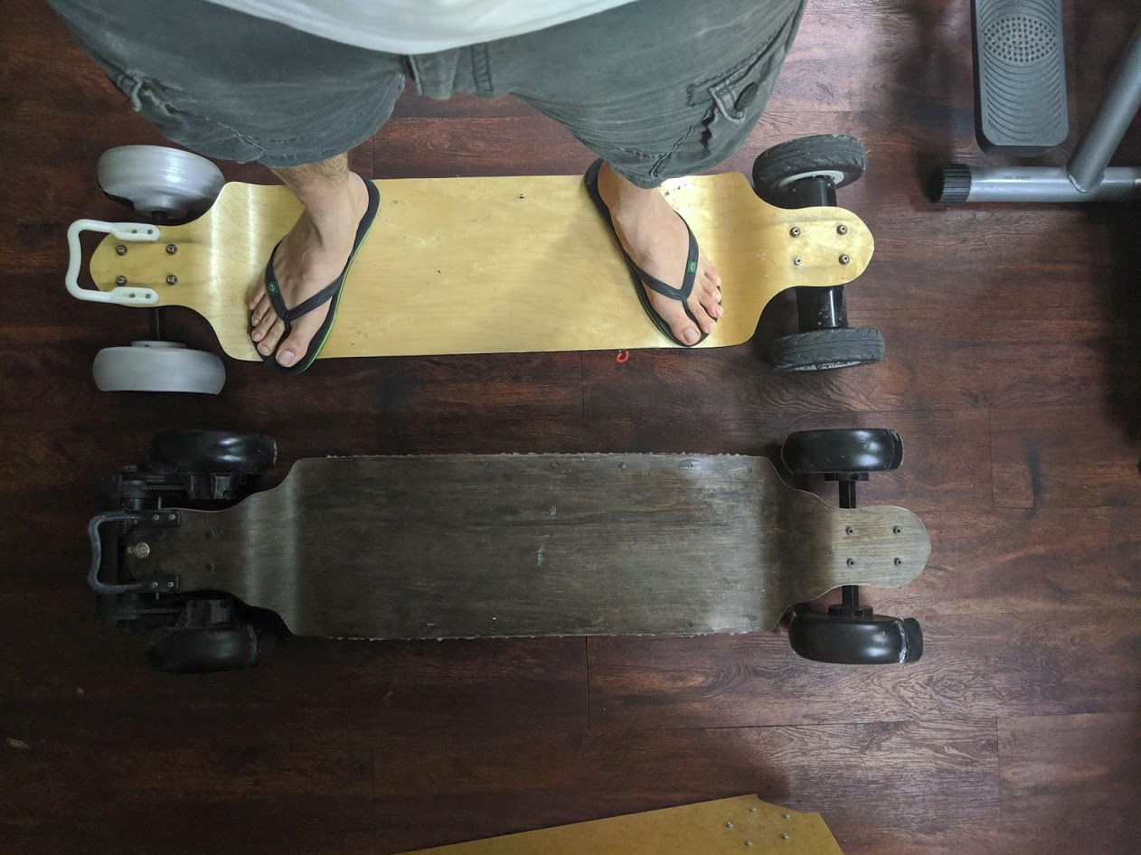

I have another cheaper option($40 shipped). This is one is a bit more flexible than skateshred and I like it. Already done 600km on the ebay one.
Natural is ebay and brown one is skateshred. Both have 2" drop, perfect for the secured feeling even at high speeds, high acceleration and rapid braking.

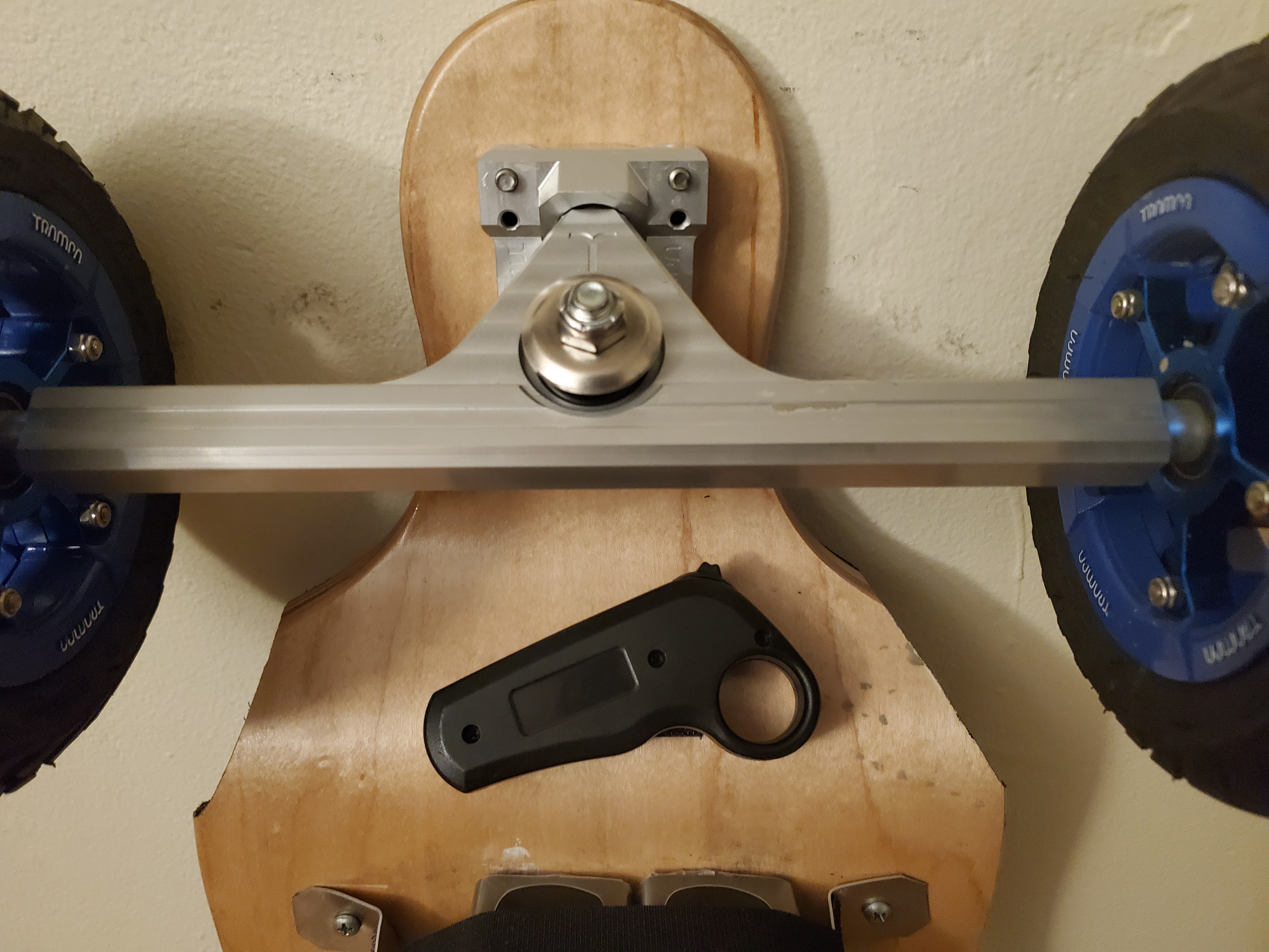

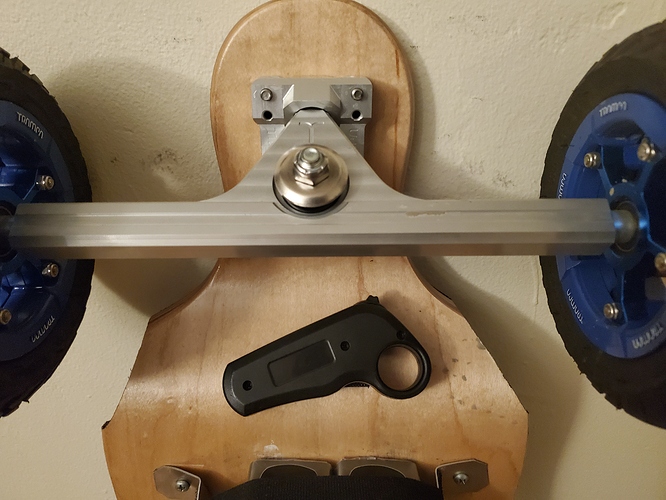

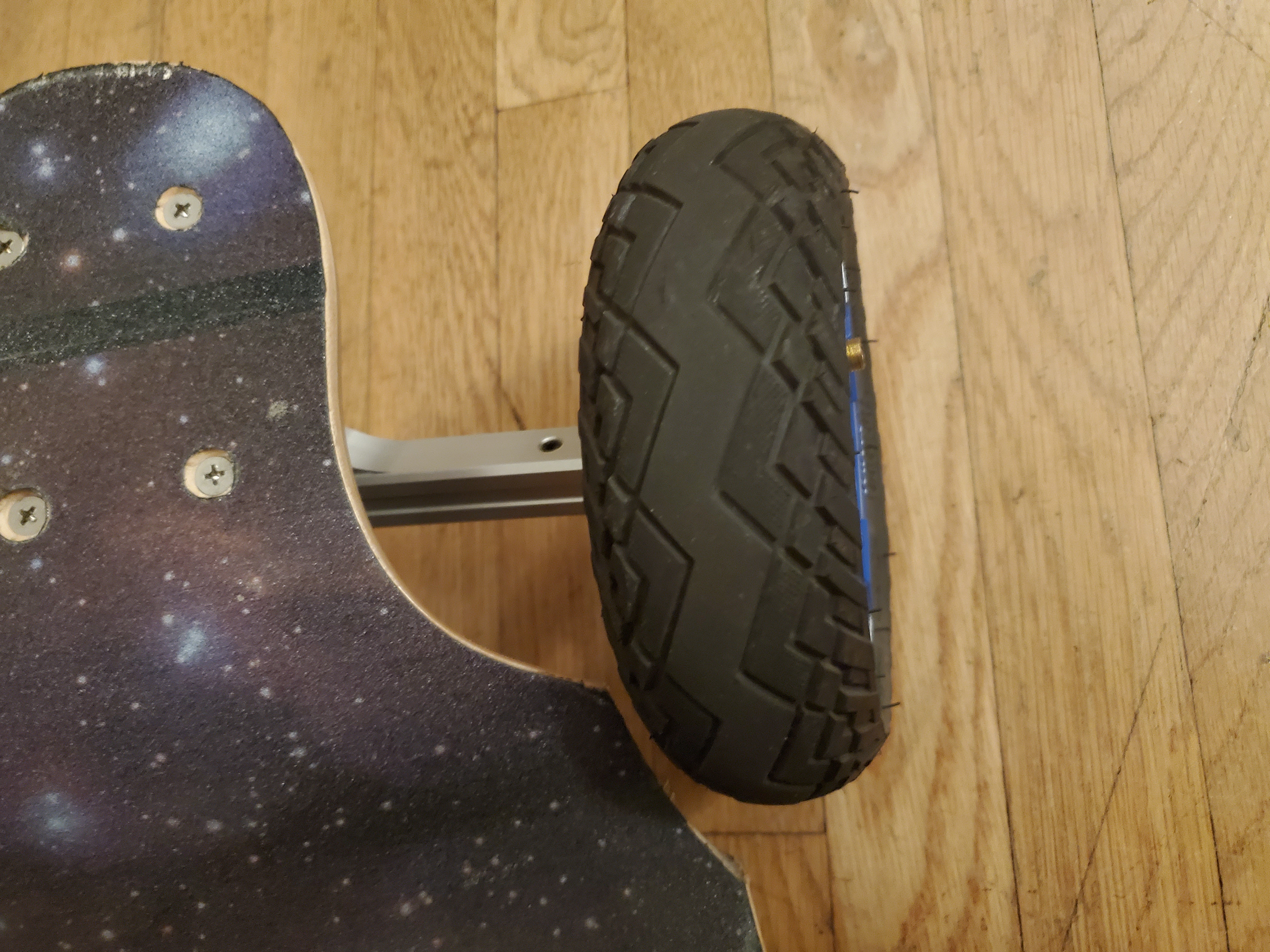

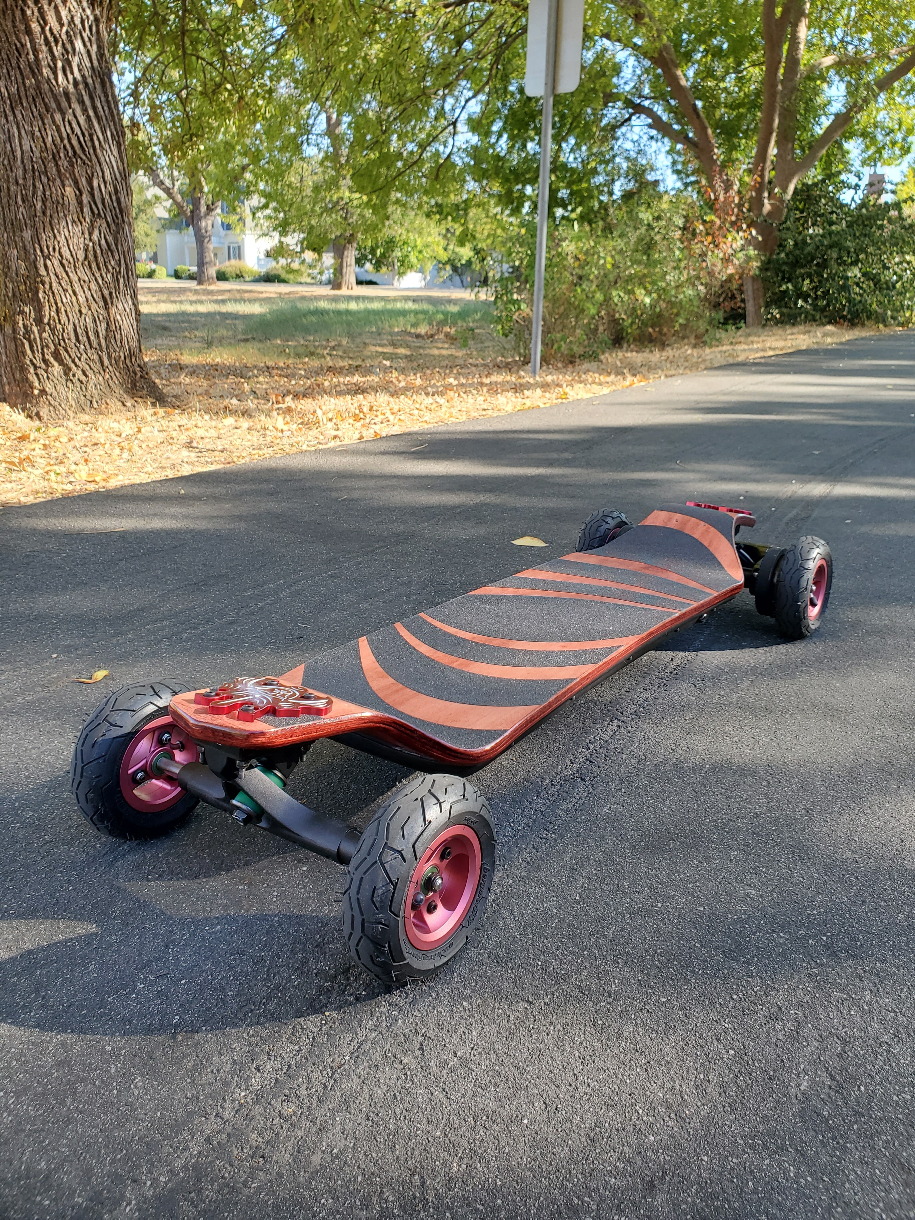

I sawzall-ed the corners on mine :rofl: I did a hack job but if you are careful and file the edge after it will look natural and allow full range of movement. I can still push even with trampa 6.5" tires
Did you use a metal plate or something for support? I have my trucks moved up just a bit so that the old holes align with the old-school mounting pattern. Have been looking at Riptide support plates / having a custom one made for extending them further. Maybe you have a pic? :slight_smile:

I didn’t want to drill the holes further because that increases the moment on the wood, the weakness of this design is the weakness. But here’s what it looks like with the corners crudely cut by a caveman

Oh, didn’t realize you meant the outside corners :laughing: Thought you had a drop-through switchblade.

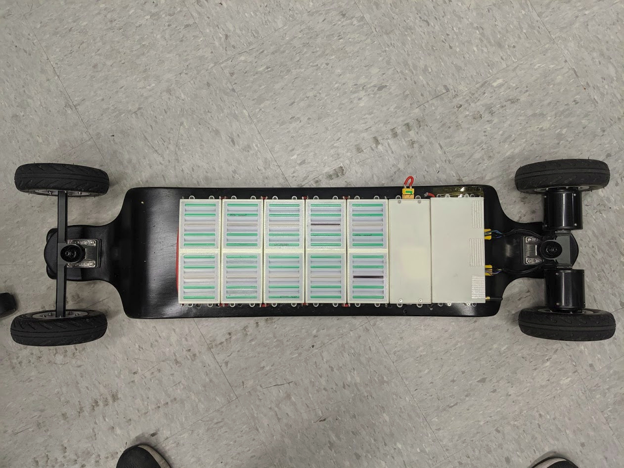

Its still crazy to me how you fit a s4 under that. Any clearance issues? Care to throw a tape measure from ground to battery enclosure, I’m gonna guess 1.85" from ground
What do you mean s4? I have a 10S5P setup here.
I actually have lots of clearance because my total enclosure+battery height is 21mm. I frequently go over bumps and the bottom never touches.
Damn, i would be wanting an extra layer of protection over that stuff!
