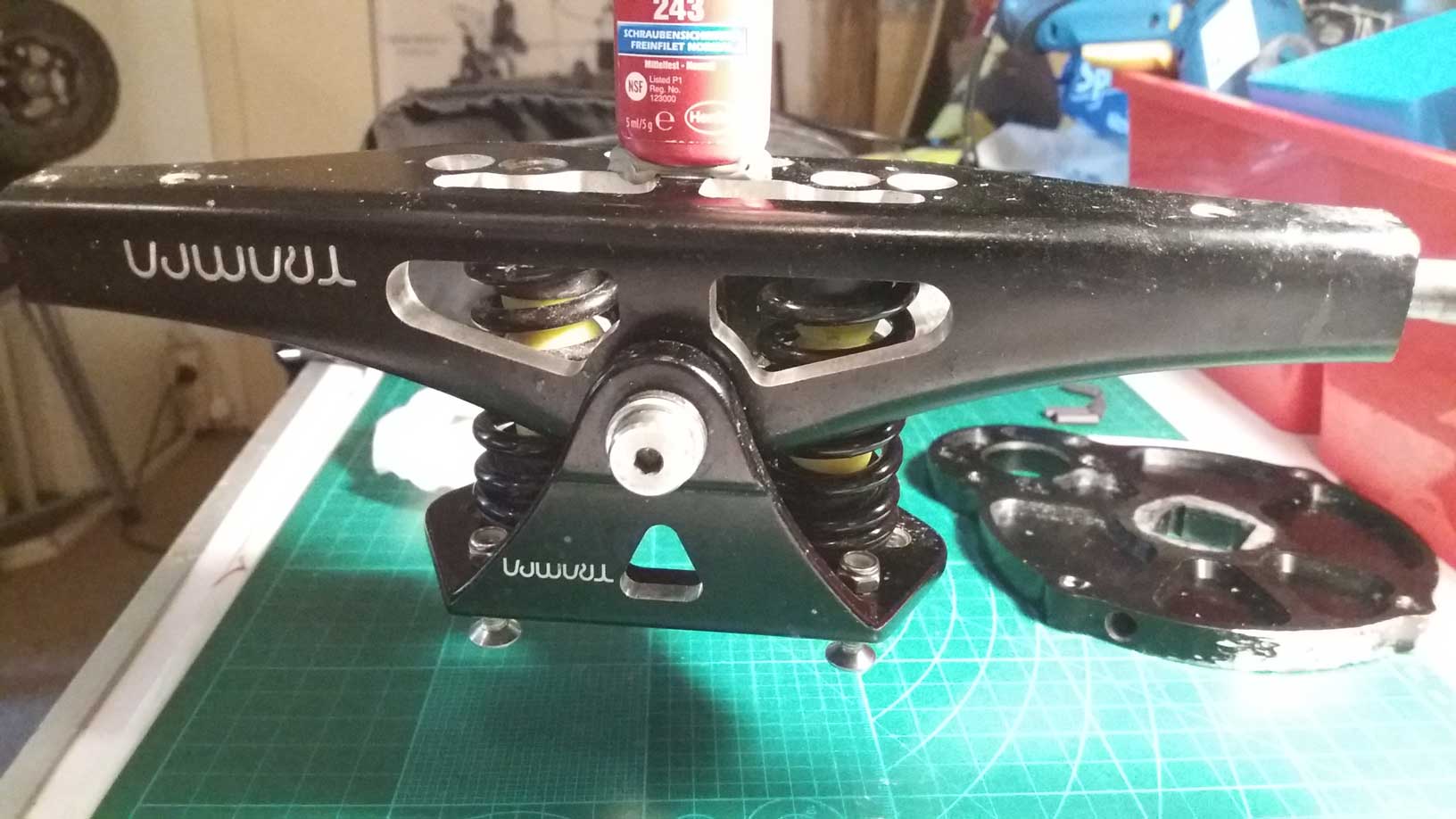

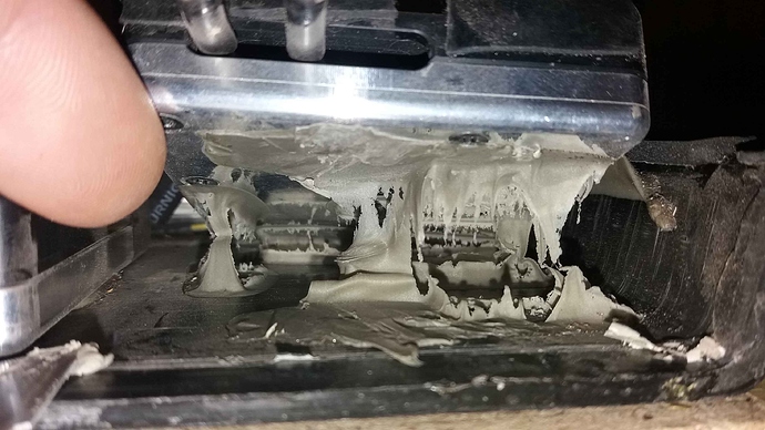

I use butyl tape for so many things beside gluing, for example I seal all gaps in gear drives instead of sugru. It is a bit like sugru but never hardens. I glued a flexible battery and electronics with butyl tape 2.5 years ago and it still holds strong after several crashes. The battery shifted a tiny bit when I crashed so hard into a rail that I cracked the Trampa deck and destroyed the front truck in skate park. I had more crashes afterwards but nothing moves, it’s awesome stuff.

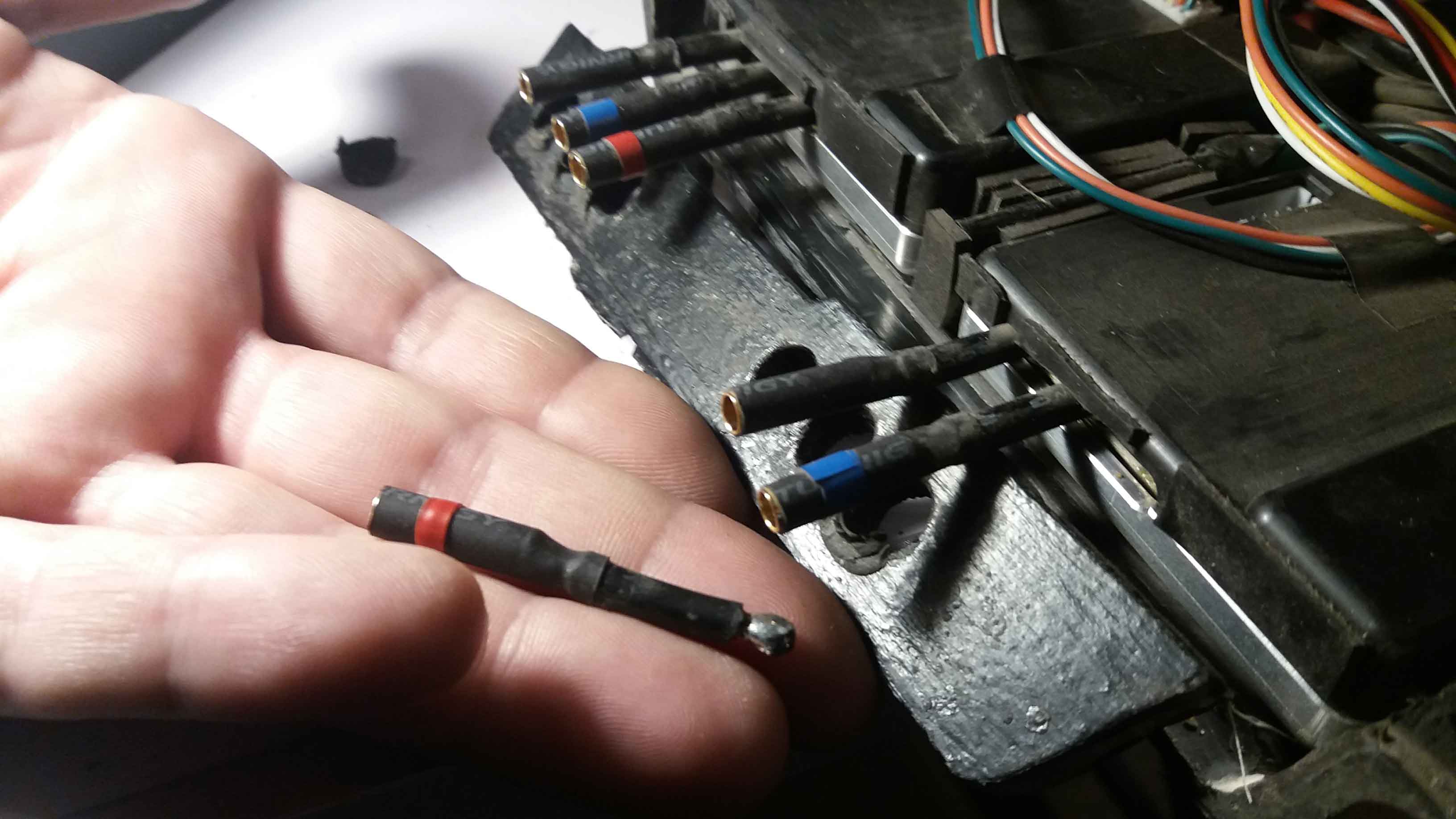

Also it’s easy to remove if you need to. This is an example why I had to remove an ESC
With a scraper it’s easy to remove, I used way to much tape the first time. Afterwards I used 4x1cm pieces which is enough.

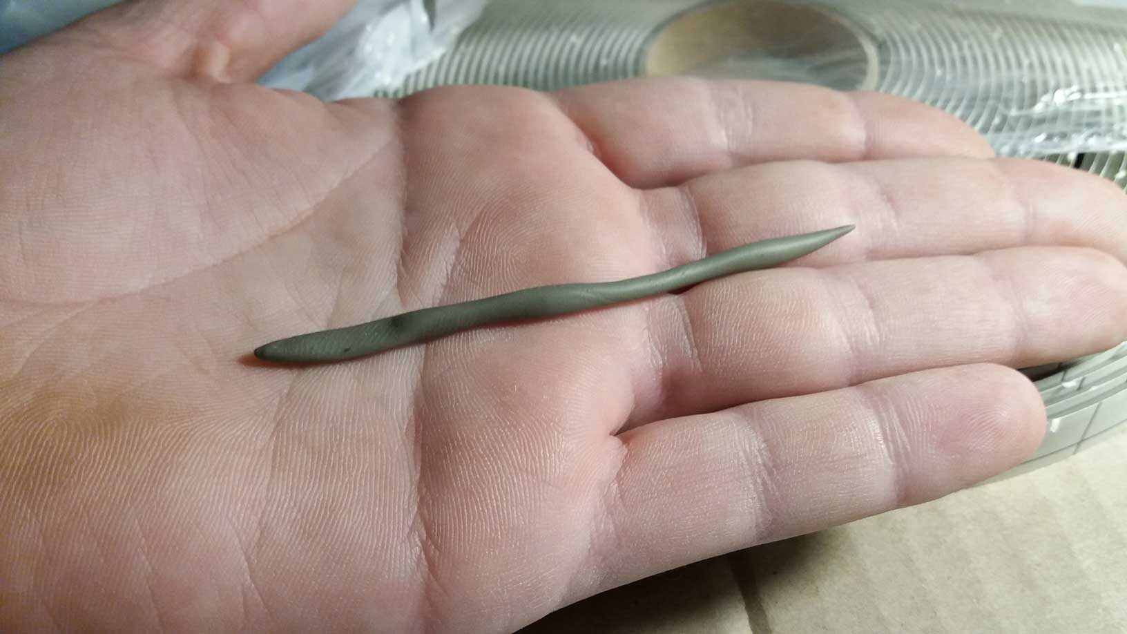

It’s hard to explain so here some pics of butyl tape (this one is 2mm thick)

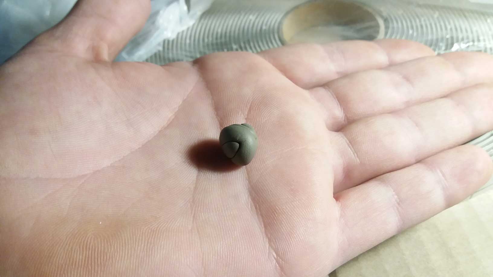

Cut a small piece
then shape it to your needs

Trampa truck no problem

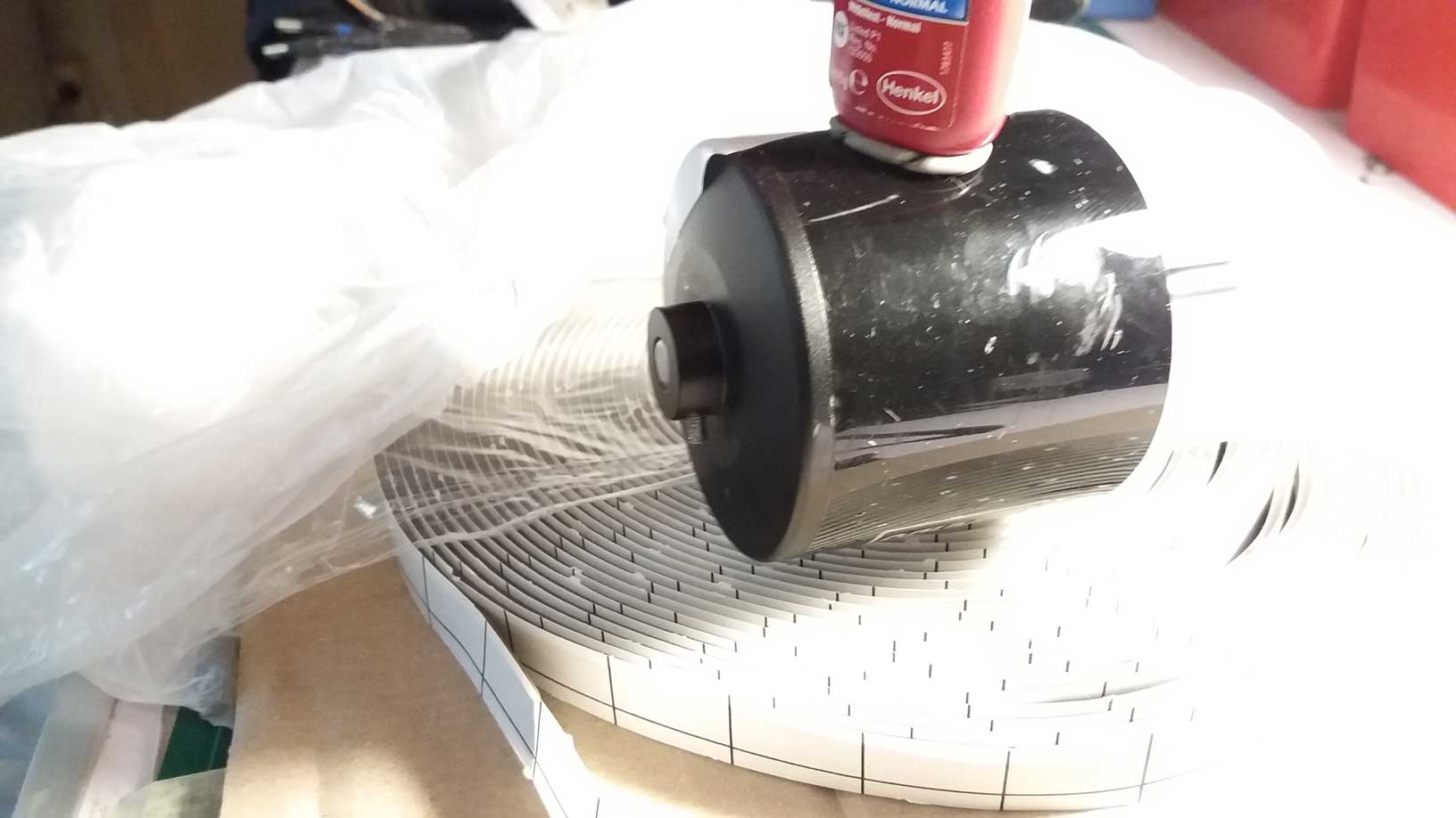

Here is the limit of this small piece of butyl tape
It holds 2.5kg (5.5lbs) for 1-2 seconds :sunglasses:
What more can I say? It’s acid free, heat and grease resistant, dampens a tiny bit and is cheap :man_shrugging:.

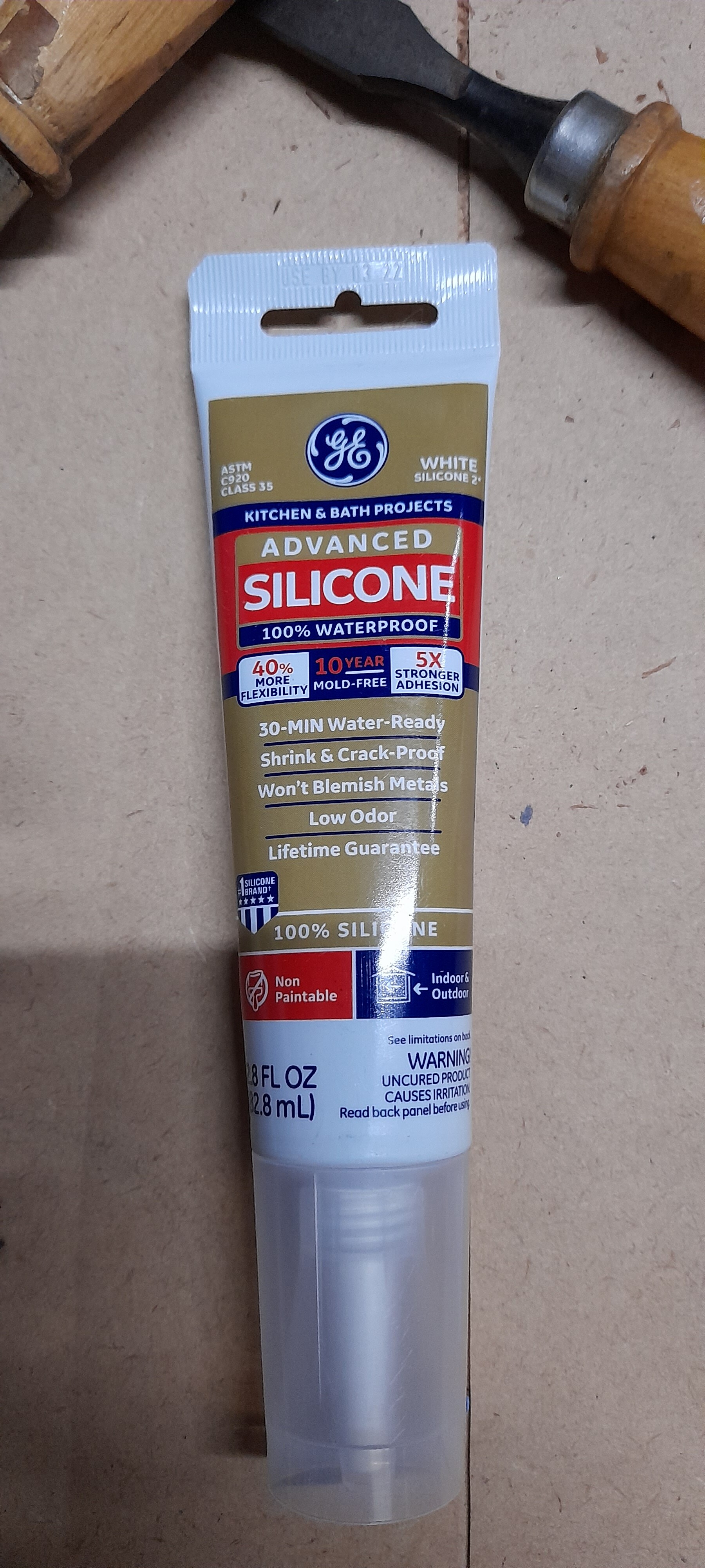

Just so I am sure I don’t make a mistake, I can use this right?
That’s good
I prefer clear in case you need to take stuff apart later, but that’s the same thing, just white
The first squirt is different, so try it on paper first
In fact, whatever the first squirt is, I wish you could buy entire tubes of just that
Cool, thanks brother. Iam going to use that on the battery. I was lucky enough they had this in here, white will have to do :grin:
Always is, thanks for the tip😉
How hard is it to remove this stuff if needed ?
