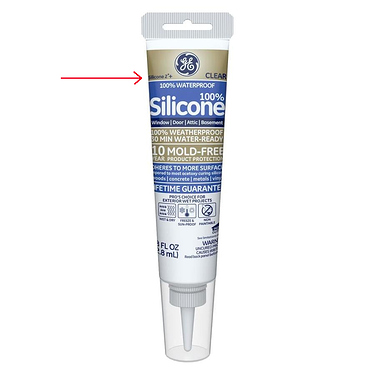

Go skate to a big box home improvement store, like Home Depot or Lowe’s or Menards. Go into the paint section. Find a product called ā€œGE Silicone 2*+ā€. It comes in a small 2.8 fl. oz. tube, for hand-squeezing, and a bigger one designed to fit on a caulk dispenser. Do not buy ā€œGE Silicone 2*ā€ because it’s the wrong stuff. It must have the plus at the end. edit: this is wrong, that is the new version of Silicone 2*+

It does come in white and clear, I prefer clear but both work the same. Clear is easier to use. For example if you need to work on something and are cutting it out, you don’t want the opaque one because you can’t see what you’re cutting into.

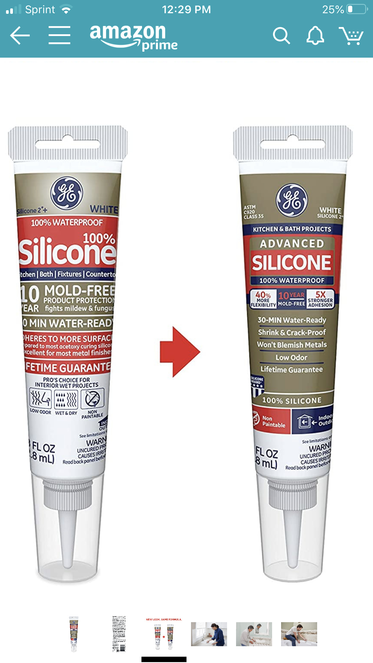

I have some GE 2* silicone, it is advertised as neutral cure on their web site. So why is it the wrong stuff? I’d rather use the stuff I already have and I am not planning on using it on sensitive components. Thanks :slight_smile:

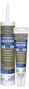

The + is no longer the current model is what I found this week. 2* says it’s the same formula as 2*+. YMMV

Doesn’t smell bad compared to other silicones I’ve worked with. And when you say wrong stuff, even if labeled as neutral cure it could be an issue?
If it’s neutral cure, it’s fine.
I guess they just changed it up and made a confusing setup even more confusing. Or less confusing? As long as it says neutral cure on the packaging, then I’d say the confusion level is going down.
