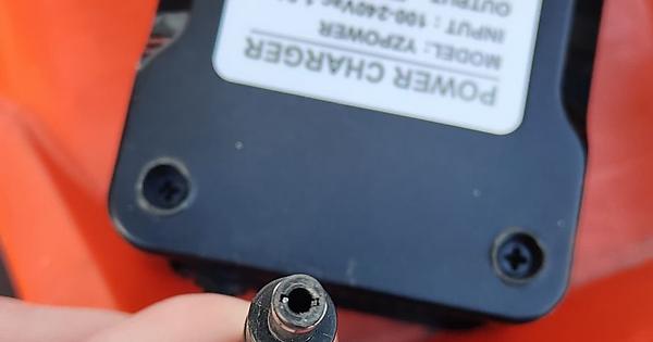

Hey! My charge port do not work anymore and I need a new one, but not sure what port to buy. I have a 42V 4A charger. I have seen different kinds of amps and voltage ports that looks like mine, but unsure if the port needs voltage and amps to be 4A and 42V
Here is a picture of my charge plug:
I have found this port that I think will fit:

I would recommend these . They’re rated for 10A.
I generally don’t trust ports that come with wires soldered on them they tend to be very small gauge.

You want a 5.5x2.1 barrel jack
https://www.amazon.com/Lsgoodcare-Threaded-Connector-Adapter-Dustproof/dp/B06XRT5C2Q/ref=sr_1_10
And put a fuse on it!
