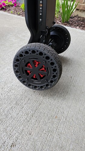

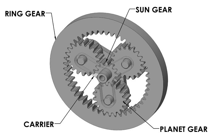

New type of direct drive. Motor mounted on the truck, yes, but further from wheel, with a pinion still. Special hubs with contained gears.
See also, stary board and ecomobl.
The brakes on planetary gears are LOUD. Much louder than acceleration for some reason.
I think of that as a plus, people will hear me slowing down behind them when im skating to work
My problem with them are that they’re designed for a much taller gear ratio (up to 100 typically) and use shitty hub motors to drive them. A higher kv motor on a higher voltage setup could make for a killer board though.
The ecomobl 2 AT I rode was pretty punchy but very flat through the rest of the acceleration.
