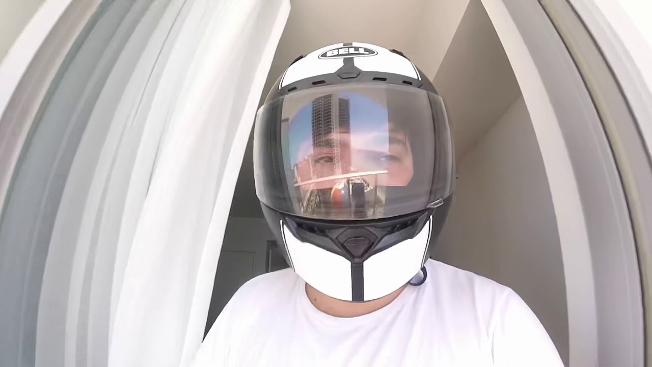

It already exists.
Here is a quick test by some guy
Surprised I haven’t seen anyone rocking one here. Maybe the awkward minute or 2 when you hit a tunnel or other dark spot and it is still tinted is enough to dissuade.
I have seen a few but they are expensive. The one Bell makes for my helmet costs as much as the helmet itself.
Sunglasses will do just fine in my case :laughing:
Ahhh….okay, makes sense. :grin:
