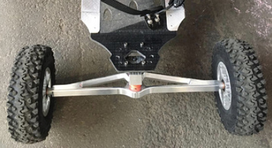

It’d be cool to see one designed for our traditional Mtb Decks.
so it attaches at the tales rather than having bolts going through under where your feet are.
The axle offset on those is pretty significant.

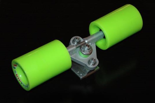

What you really want to do I think is instead of having the two bushings in line with each other, bend it so that its like /\ but only maybe at 30 deg or so, and a bushing on either side. That way you can bring the axle up closer to the pivot axis a bit and I think the bushings would support each other better.
Where do we get them?
Like this?
above design also helps with this as the axel offset is only the width of the bushing.
I think that’s a lot closer to a normal offset.
Interesting concept. Baseplate would likely need to be two piece design, right? Maybe pivot cups on both sides for vibration dampening. Either way would reduce a lot of slop. Someone should test this design.
Some of those designs are Chris Chaputs work. Maybe @RipTideSports knows something about them
I just found them when I was looking on the internet for inspiration
This is my favorite of the old Chris Chaput experiments.

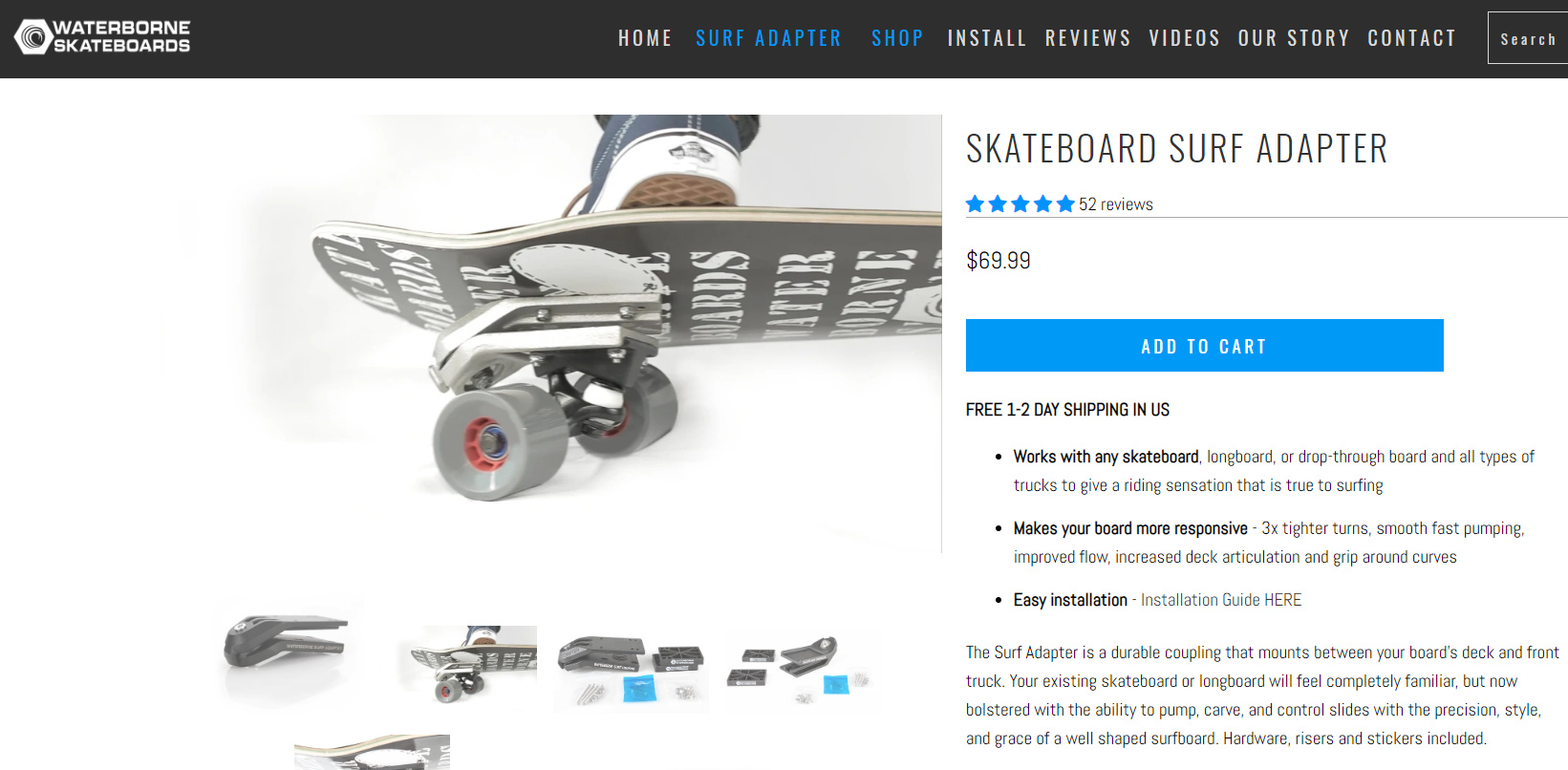

Anyone ever seen this specific adapter set before? It is called the “Waterborne Surf” and is attached between the truck and the deck and acts to make the board much more “surf” feeling with sharper turns for the same amount of lean. I don’t have any personal experience with it but the videos of people using it look interesting.
I road an inboard with one on it. Fun at low speed but kinda sketchy in general.

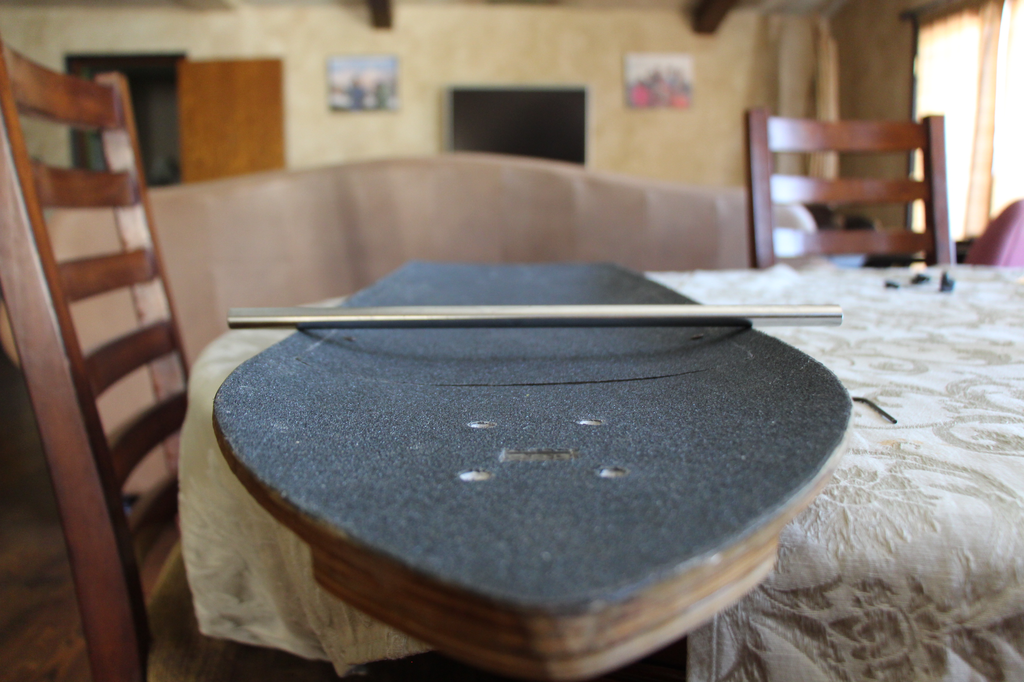

I dont know if any one mention this yet but more concave, I find helps a lot with quick turning especially on sidewalks and around people at low speeds. If you think about it you can put more pressure from your body weight on the edge of your deck without leaning nearly as much.
Also people say that aggressive concave hurts your feet but it does affect my feet at all. My legs get tired before my feet.
Here’s my deck for example. I wouldnt mind more concave tbh
Concave is like having a higher deck in only the places you need it.
I knew a rider who once tried to advocate for 2" concave, but I think that turned around when he actually made a board with it.
I am thinking the waterborne surf adapter may be a potential solution. I do not think a truck can do it all by itself even it is optimized. Just like truck movement is controlled with bushings, what would it be like if the left and right rotation of the waterborne adapter was also managed with a bushing on each side? Less resistance at first that quickly ramps up preventing a potentially dangerous oversteer scenario. Durometer could also be increased/decreased to further tune the characteristics. This would really increase your ability to turn without having to lean as much.
