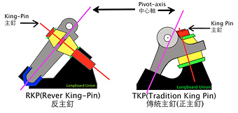

Truck type (RKP vs TKP) does affect the relationship between lean angle and steering angle.

Is there a baseplate angle where RKP becomes TKP, or is it the lean-turn progression curve being different between the two?
On a RKP, the pivot axis and the king pin axis are perpendicular to the axle path so the axle scribes a straight line when watching from the side of the board. On the other hand a TKP, the pivot axis and the king pin axis are NOT perpendicular so the axle scribes an arc or an ellipse that is dependent on several factors that are difficult to predict

This diagram is wrong. The TKP pivot axis is in the wrong place.

Blue is where the TKP pivot axis should be.
