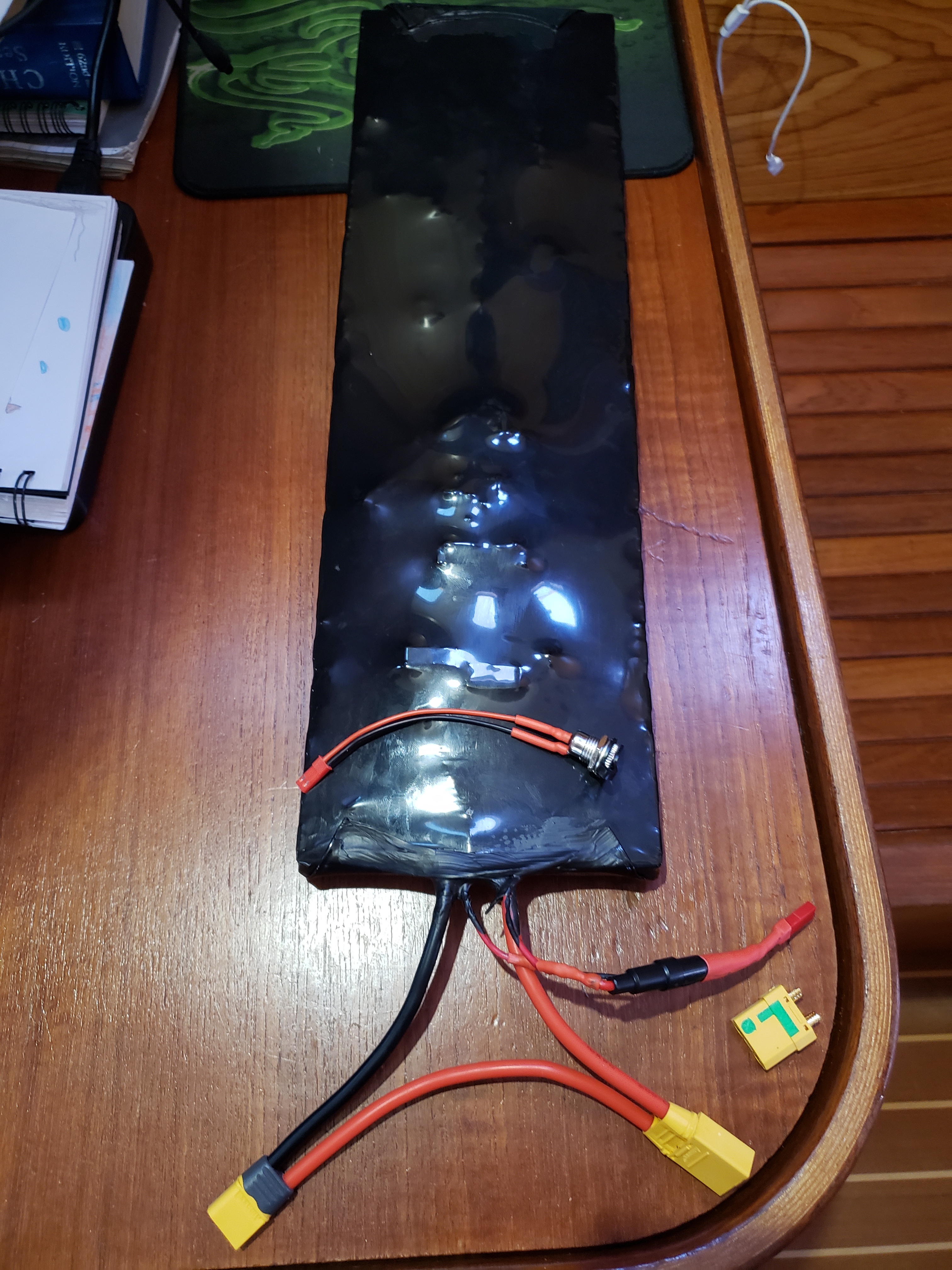

I use about 3 long sections of heatshrink per battery, leaving enough at the ends to melt onto itself. Then I use a liberal amount of liquid tape to seal the area the leads come out of. I’m pretty sure I could dunk the packs and be good. Melting heatshrink onto itself is tricky and takes some practice.

I usually just put wet silicone conformal coating on the thing under it, then shrink it while still wet. It seals to whatever is underneath it.

Ive 3d printed one and covered it in flex seal.
Still working well.
  1. I conformal coated everything.
  2. Then used neutral cure silicone to seal off any entry point.
  3. As an extra measure, I applied hot glue on the outside on the edges of the enclosure.
I have been riding for a little more than 1000km with 10% of the time in rain and I haven’t had any issues. Ideally I want to integrate a humidity sensor with the DieBieMS to tell me if there is water ingress or not, but I haven’t had the need to.
