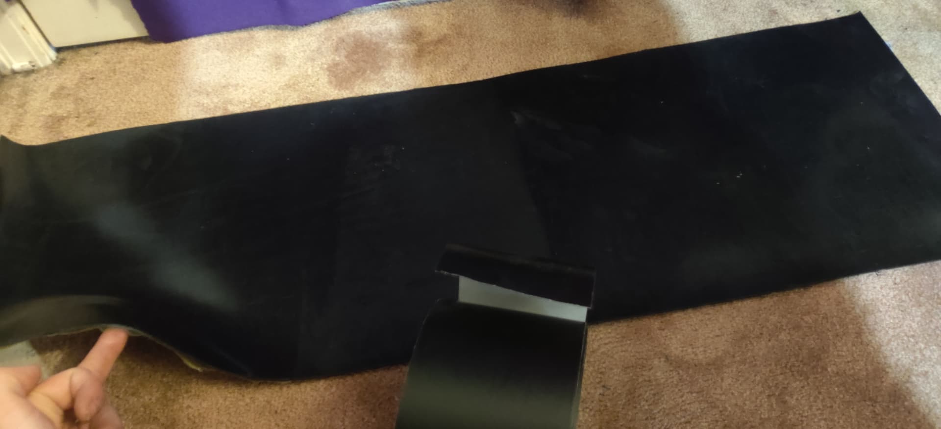

Due to precisely this comment, I decided to just coat the entire top of my enclosure in butyl tape, overlapping at the gaps. I have more butyl tape so my plan is to just cut it off and replace it whenever I need to do mods/upgrades/repairs.
This basically solves the entire issue of water ingress. The top of the butyl has definitely been wet after a rainy ride, but the inside of the enclosure is bone dry. I could dump a pool on this enclosure and it would be fine (still need to get a waterproof switch and charge port)

So here’s my alternative to butyl tape (I bought it but it’s like chewing gum so I didn’t use it).
I want something easy to separate to open and won’t squish out of shape like butyl, but still makes a pretty good seal (not a b264-level seal I’m not crazy :slight_smile: )

gotta say, after personally using butyl tape and rubber sheet that sounds much more difficult. once the board is built and the butyl tape is down there is very little reason to remove it, and when I need to I just slice it and patch the slice with more butyl tape. it sticks to itself amazingly and is thin enough that another layer doesn’t cause an issue. after it squishes out just go around the edge of your enclosure with a knife to remove excess.
I second all of that :arrow_up:
Butyl tape works but it’s a damn mess and I hate it. And it smells weird.
Personally, I prefer just rubber on rubber. I use e6000 industrial glue to put a sheet of 3mm rubber on the deck where the enclosure sits, then another that I put entirely over the enclosure, and cut out the middle. Then squeeze that down from 6mm of gasket to 4.
